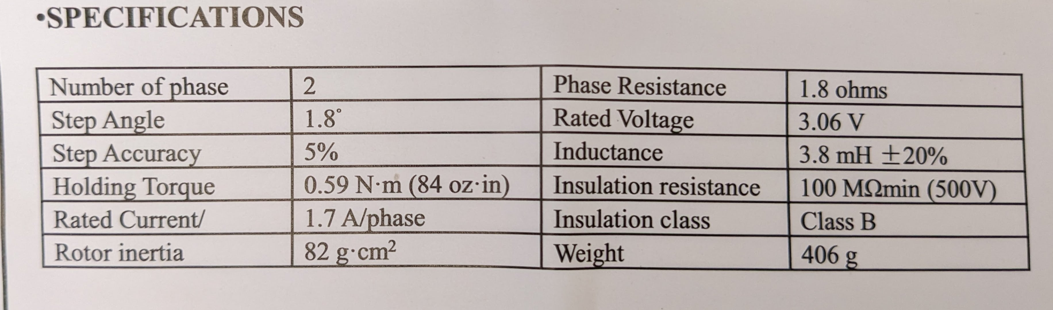

Losing steps on X while clearing a carving
V1E Shop Nema 17 Stepper has image with specs…
