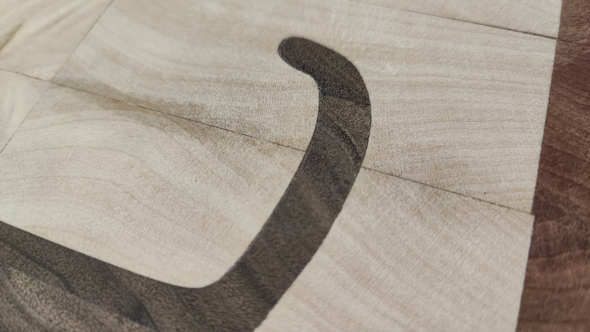

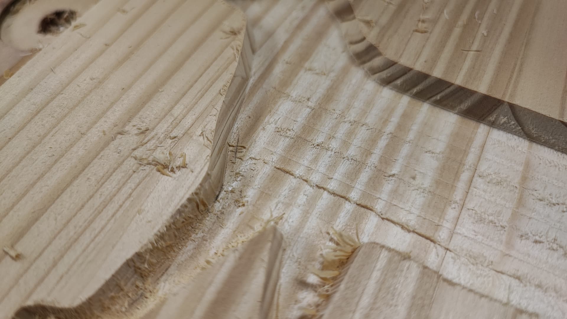

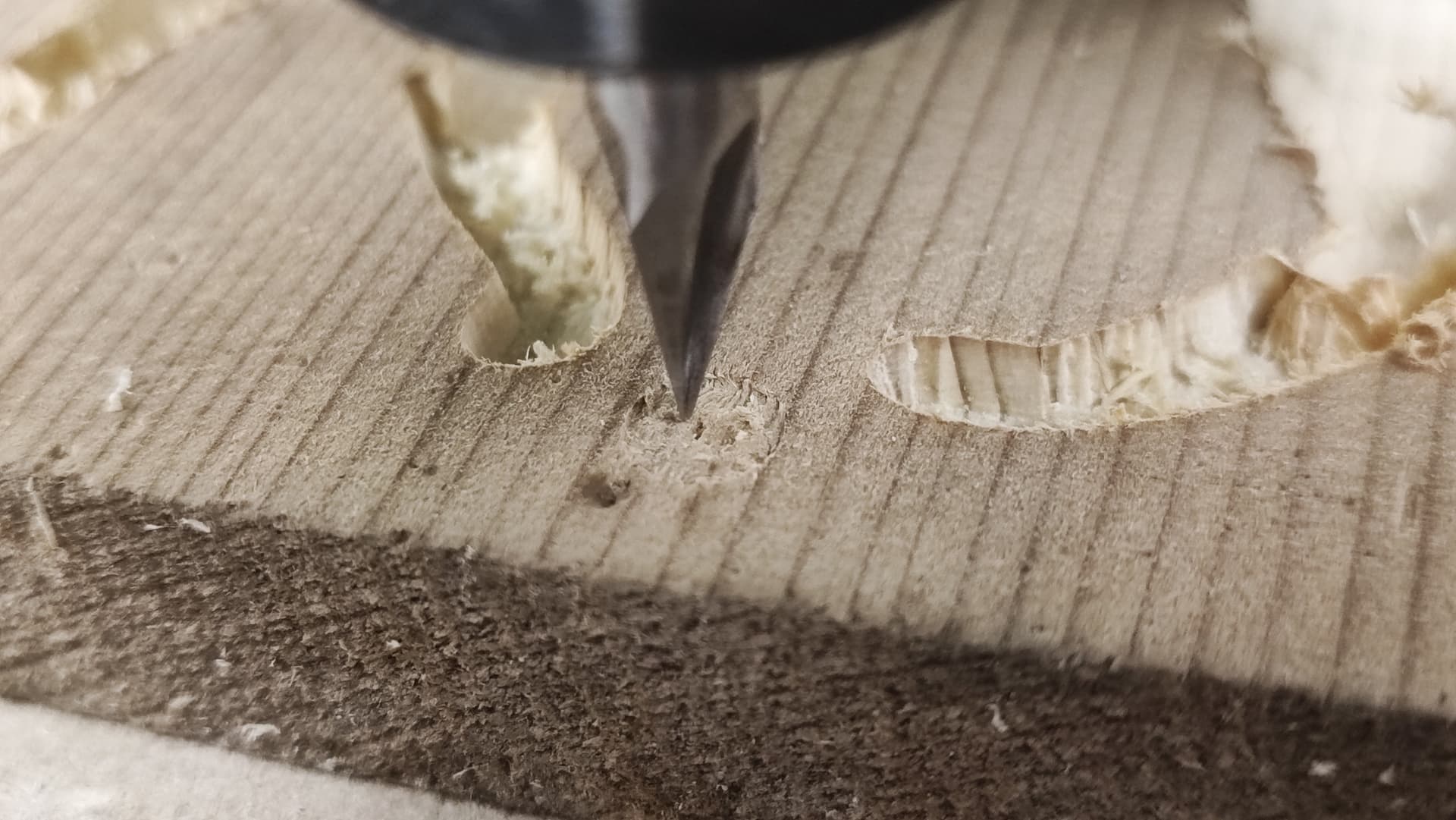

Cheers all, the title says it all. I am losing steps on my X-axis when clearing with a V-bit because of the rapid movements from left to right. The Axis is wandering to the left, around 0.8mm in a very short time,
which is disastrous for an inlay. Kind of.
Starting point:

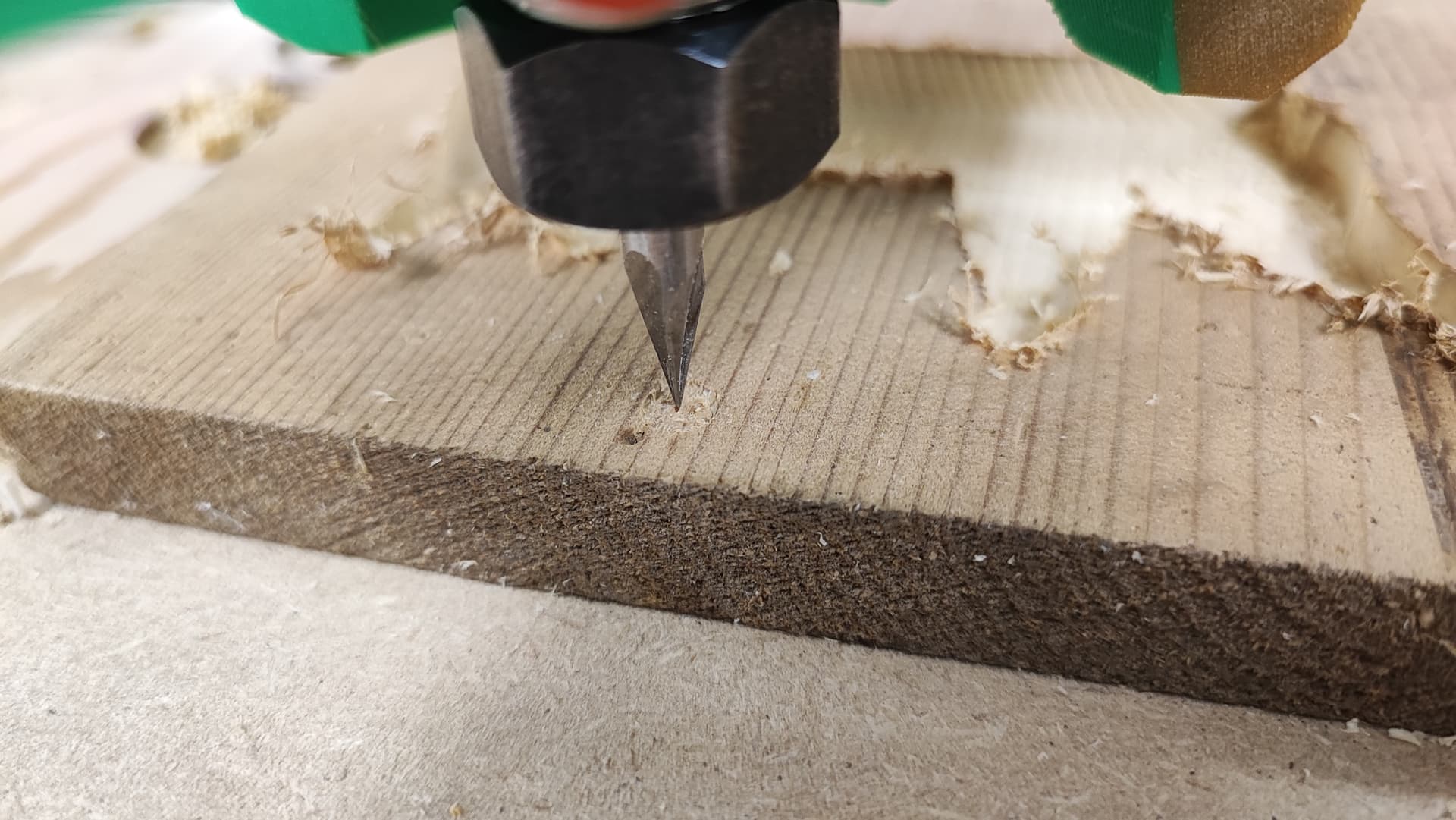

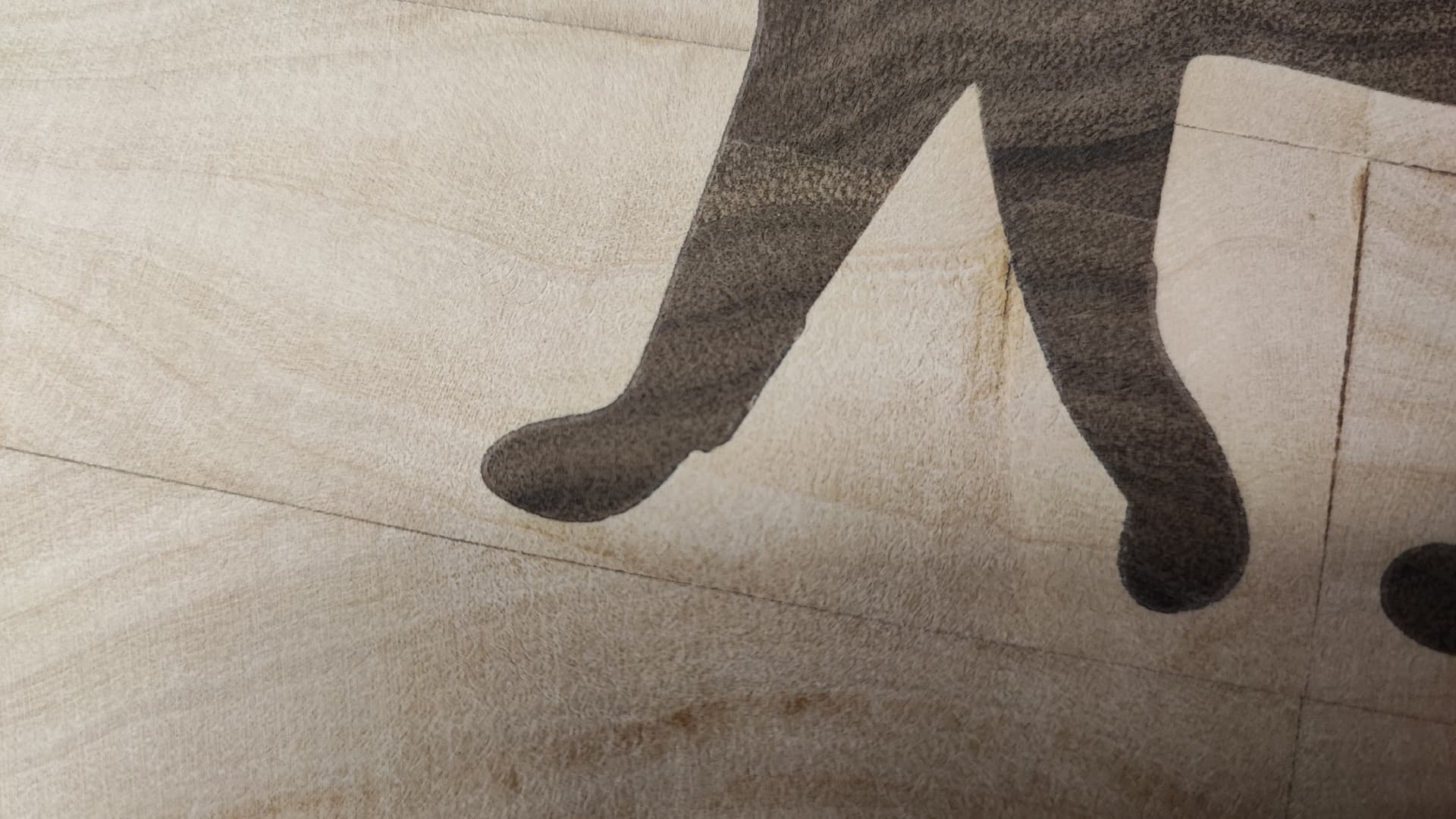

After cutting the cat’s feet with 1000mm/min (Y being off was my fault, not the Lowrider’s):
After cutting the cat’s feet with 750mm/min:
You can see that it moves a lot less when I slow it down, the problem still persists though.
I am now considering setting inertia (Trägheit) to 95% on X so it slows down more when doing inlays in addition to going down to 800mm/min. That should fix it, I am also taking other suggestions though. :smiley:

Of course because there is only one motor on the X axis, it is weaker. I bumped up the current on my X motor a little. You have to be careful of the motor getting too hot, but it should be able to run a little more current than the firmware default.
Slower will also be more accurate, which is a good thing for inlay type work, too.
Same happened now with clearing and a normal bit. The left/right on X, together with one motor (as you said) seem to do that. I did see that with the Primo as well but never thought about it, I always thought it was me moving the core a bit when changing tools (it was, I checked the old pictures, see below). I reduced my rapid speed, now I have to reduce the inertia as well I guess (I didn’t do it because I thought going slower would be fine). I have to check whether I can increase the current, I am running TB6600s. Thanks for the input!

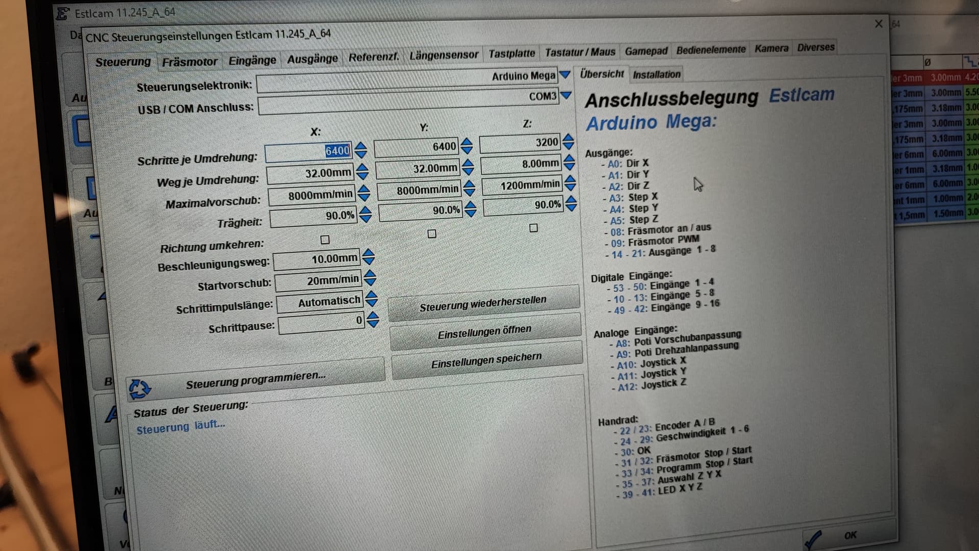

Rapids were at 8000, look at the screenshot above. I used pretty conservative acceleration, but I think it might have been the problem. Set rapids to 3000 and upped inertia. Have to test again.

I am going to try with reduced rapids (though that hasn’t been a problem before) and reduced inertia. After playing with the acceleration I had the feeling that even though the values were the same (see screenshot above) it acted differently, really sluggish, so it might not have used the values before.Very wird.

Unless you changed the firmware I have it capped at 50mm/s you are shooting for 133.
Acceleration is not the same as rapids, what are your accelerations set at.
I have no idea what an inertia setting does, if that is set in mm/s/s then that is acell. if that is the case cut it in half.
What is the number you have highlighted at 6400?
Just occurred to me you are using estlcam firmware. He discontinued the ramps support a while ago. be careful, we might be chasing a bug.
If the highlighted number is microsteps and you are trying to run at 133mm/s you are probably outrunning the 8bit mega chip. The processor should just slow down but sometimes they do not.

The 6400 are microsteps. If that was the problem I would have had it with the Primo as well, also on the other axis’, but it’s only on X, only to the left. Did at least 10 cuts/air cuts to verify this.
The acceleration is at the Bottom, “Beschleunigungsweg”, so how many mm it takes to reach max speed (had it to 10mm, which wasn’t enough, more makes the machine sluggish though) and “Startvorschub” that says how fast it is going to start until it reaches top speed after, in this case, 10mm. Acceleration is also not a straight line but a curve, according to Christian Knüll.
“Trägheit”, so inertia, tells the CNC how much it has to break before changing direction. So if I went 100mm/min, inertia to 80% would slow it down to 20mm/min before a change. So 90% slowdown from 8000 is still really fast. Which wasn’t the problem tough.
I think it might have been the cuts (1000mm/min) with 90% inertia (slowdown) that made movements too rapid. It didn’t do that with the primo though, maybe it’s really the difference of the one motor.
I didn’t have the chance to test it again, but I am going to slow down the cuts to around 800mm/min, leave inertia to 95% on X and see how that goes. Also, slowed down rapids to 3000. That’s basically the only setting that I did changed compared to the Primo. :slight_smile:

That is backwards to how I am used to it but yes 10mm is to low. https://blog.prusa3d.com/calculator_3416/ We use 180mm/s/s which is 50mm to get to 133mm/s.

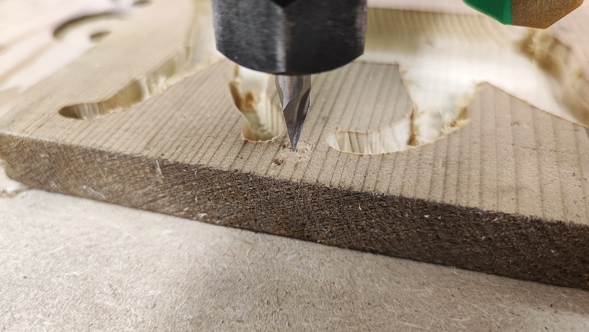

I did the aircut again and it didn’t lose 0. It feels so slow though. :sweat_smile: I might have to crank up the rapids again with 95% slowdown. :smile:

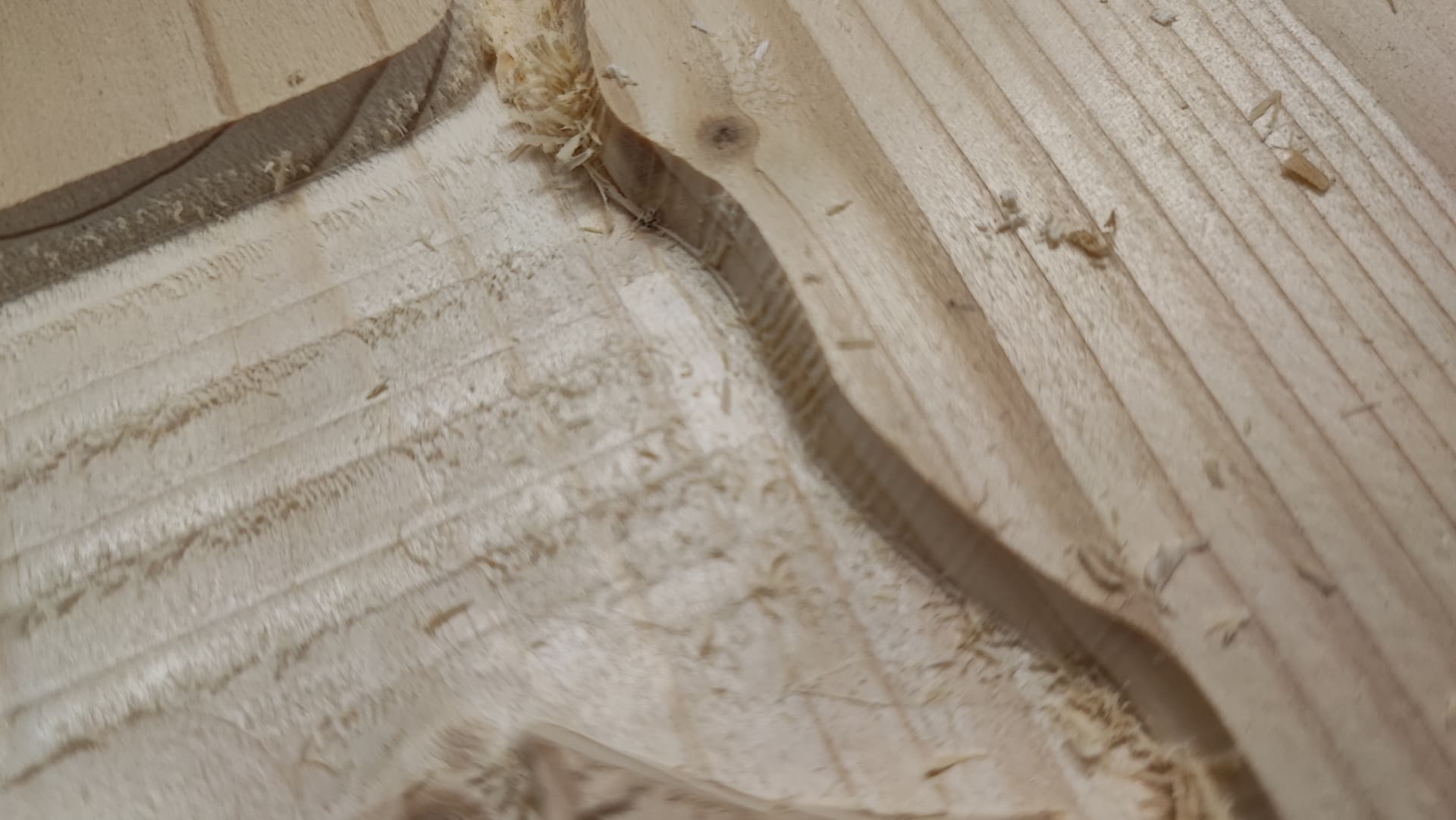

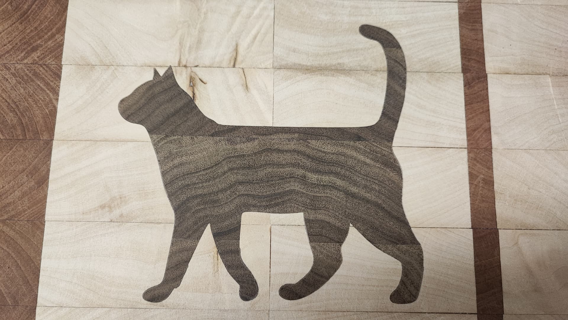

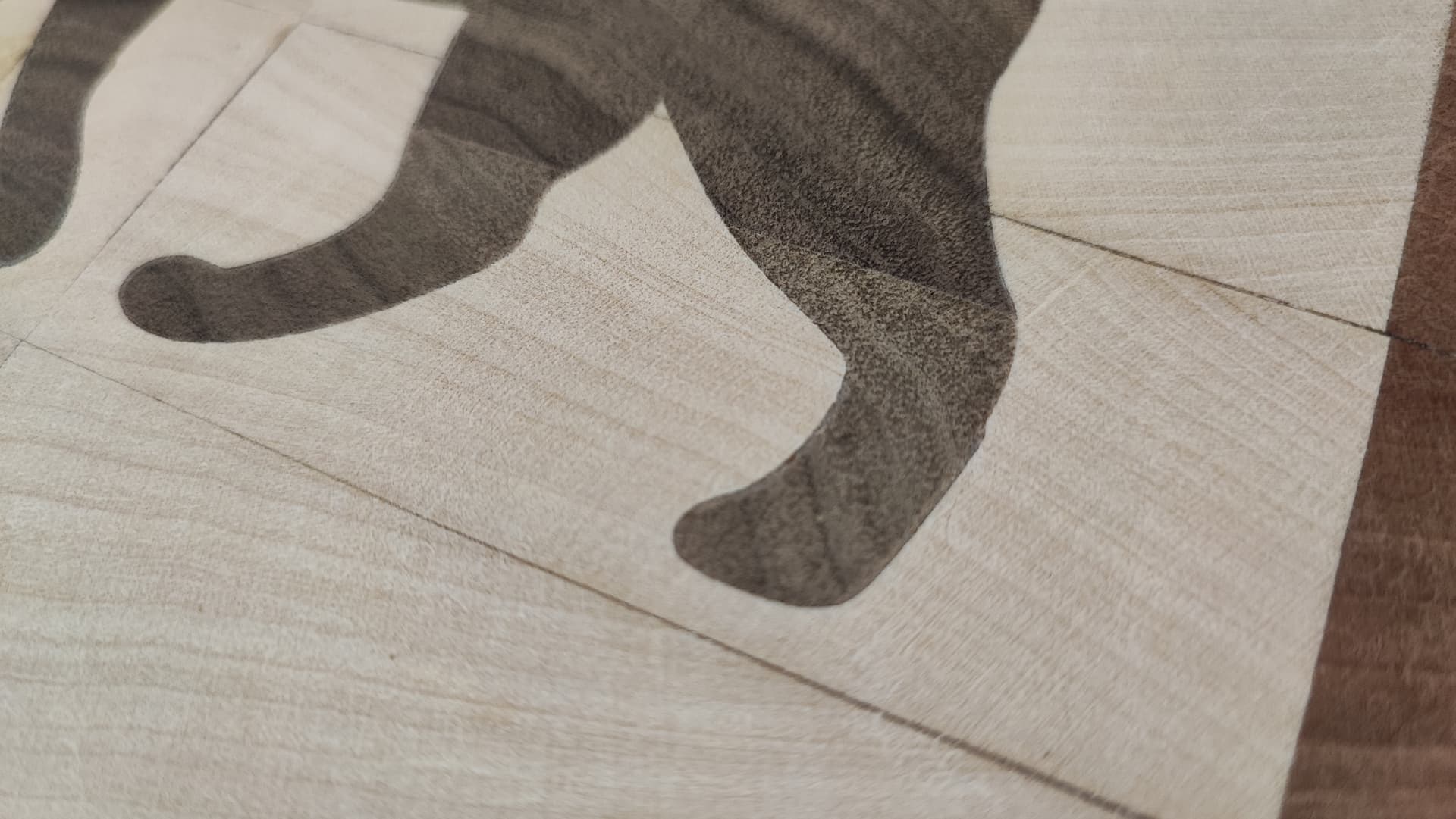

A bit related: I used sooo much glue and it filled the imperfections well. :smile:
Cat is fine now, same speeds but slowed down rapids and inertia (slowdown before direction change) set to 95% instead of 90% on X.
I did not clean it up, but you can see both sides are okay, also the endmill stayed at 0 after the cut. Thanks for all your suggestions.
