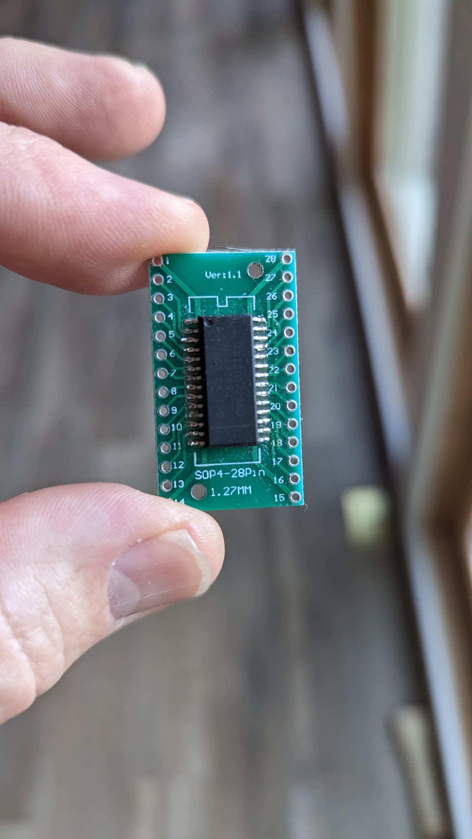

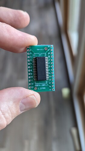

Working on a project that requires 50 surface mount chips to be soldered on to individual boards (see pic). In the past I have used a makeshift “oven” that sort of worked but would get a cold joint every now and then. Was thinking that a heat gun or soldering hot plate specifically designed for this type of thing might be worth the investment. Does anyone have any experience with either of those that can offer some advice? I would rather not drop hundreds on an oven, even though I suspect that would be the best choice.

That chip is huge and should be pretty easy with hot air

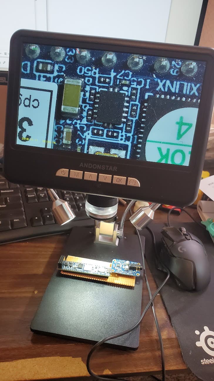

I also have a cheap video magnifier I got off Amazon it’s no longer available but there are lots of them out there:
It’s a HUGE help for both an iron or hot air.

Honestly though on a chip like that I’d probably just do it with my iron. I don’t even like a super fine tip for most SMD. I love my pinecil iron and with a cutoff conical tip it’s easy to turn it to get a small contact area…but the bigger tip holds more heat making it easy to make quick joints. Just put some flux down to hold the part in place and help…then tack opposing pins at each end first. Check that it’s aligned…then you can either do a quick tap on each pin or do a drag solder and let the flux do the work. I’ve never got the knack of the drag solder…but I can tap out those pins really quickly so it doesn’t bother me.
I also do a lot of sms soldering and prefer the iron but Stoli had to do 50 chips with each 28 pins
