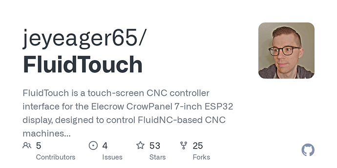

If I were in your shoes, I would make a FluidTouch pendant with a CYD display.
Our own @jeyeager is the author of that firmware.
EDIT: Not a CYD, an Elecrow panel. Still, that would be my recommendation.
I actually have a brand new CYD sitting in my electronics box right now. Perhaps I’ll try that first. Thank you.
FluidTouch uses an Elecrow display, not a CYD. However, you can build your own pendant with a CYD. I built FluidTouch because I have a pendant and don’t like the UI. However, now there are some other UIs for the same pendant.
Nice to meet you, sir. Thanks for responding. Is there a way to use my CYD with your current software, or will I need extra hardware. Looks like you or someone else has something called fluidDial that uses the CYD with an extra dial for movement. I really just want a simple display that comes on with the CNC that I can use to control it. The web interface is a bit of a hassle, having to switch wifi back and forth and all, and the way my phone zooms when I tap things to quickly, causing me to press wrong buttons while watching the router.
FluidTouch uses a couple specific 7 inch Elecrow displays, preferably the Advance display.
The compatible hardware is described on the github page.
So, is there a way to set up your FluidTouch so that it comes right on and works as soon as the CNC is powered on, without any extra steps? Ultimately, that’s what’s most important to me.
Okay, went ahead and ordered the Elecrow board. Do you have affiliate links for the battery or are there any additional parts I should be ordering at the same time? It’s a little hard to tell exactly what else I might need from the GitHub page. Very cool setup by the way. Wish I had your skills.
If you want it powered on with the CNC, you could even skip the battery and power it off USB via an adapter that gets switched on via the same power strip as the CNC.
It is designed to allow for connection to multiple controllers so normally you have to pick which controller at startup. However, there is a setting to have it auto connect to the first one.

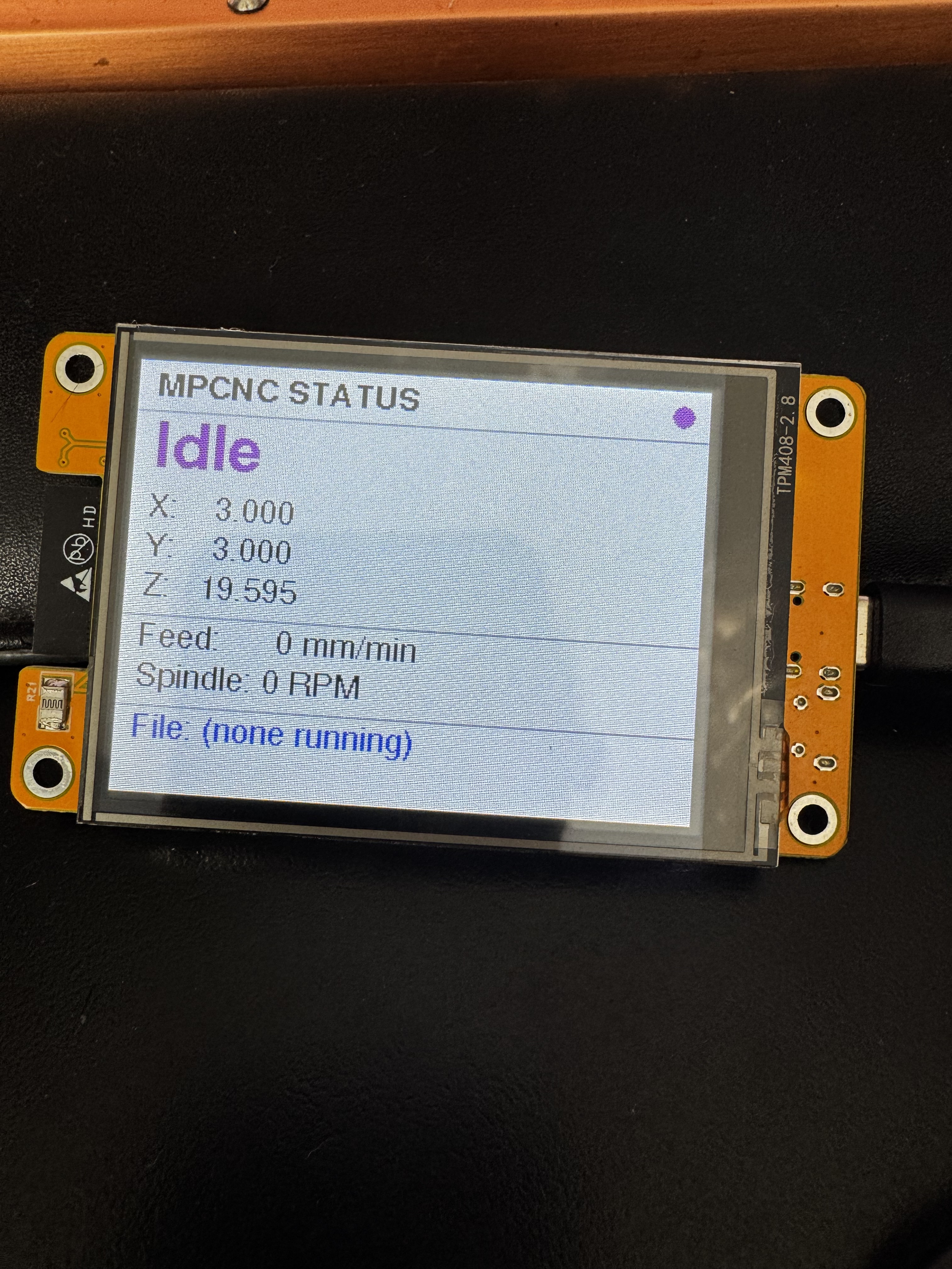

By the way, just for fun I tried using Claud AI to create a very simple status monitor for my MPCNC with the CYD I had laying around and was actually successful. I’m completely blown away that I was able to accomplish that. Have you tried using AI for Programming? I can’t believe what it can do. My family doesn’t really understand my excitement about this. It’s just so incredible to me, I felt like I needed to share it with someone.
You can use Macros. Create a file for each command on the controller SD card at /fluidtouch/macros and then you can set that up in FluidTouch.
FluidTouch/docs/ui-guide.md at main · jeyeager65/FluidTouch
While I am a software engineer professionally, Claude wrote about 95% of the FluidTouch code. As a dev, using AI feels like having a superpower. It still requires intelligent direction and does dumb things anyway, but I can definitely create things faster while using it.
