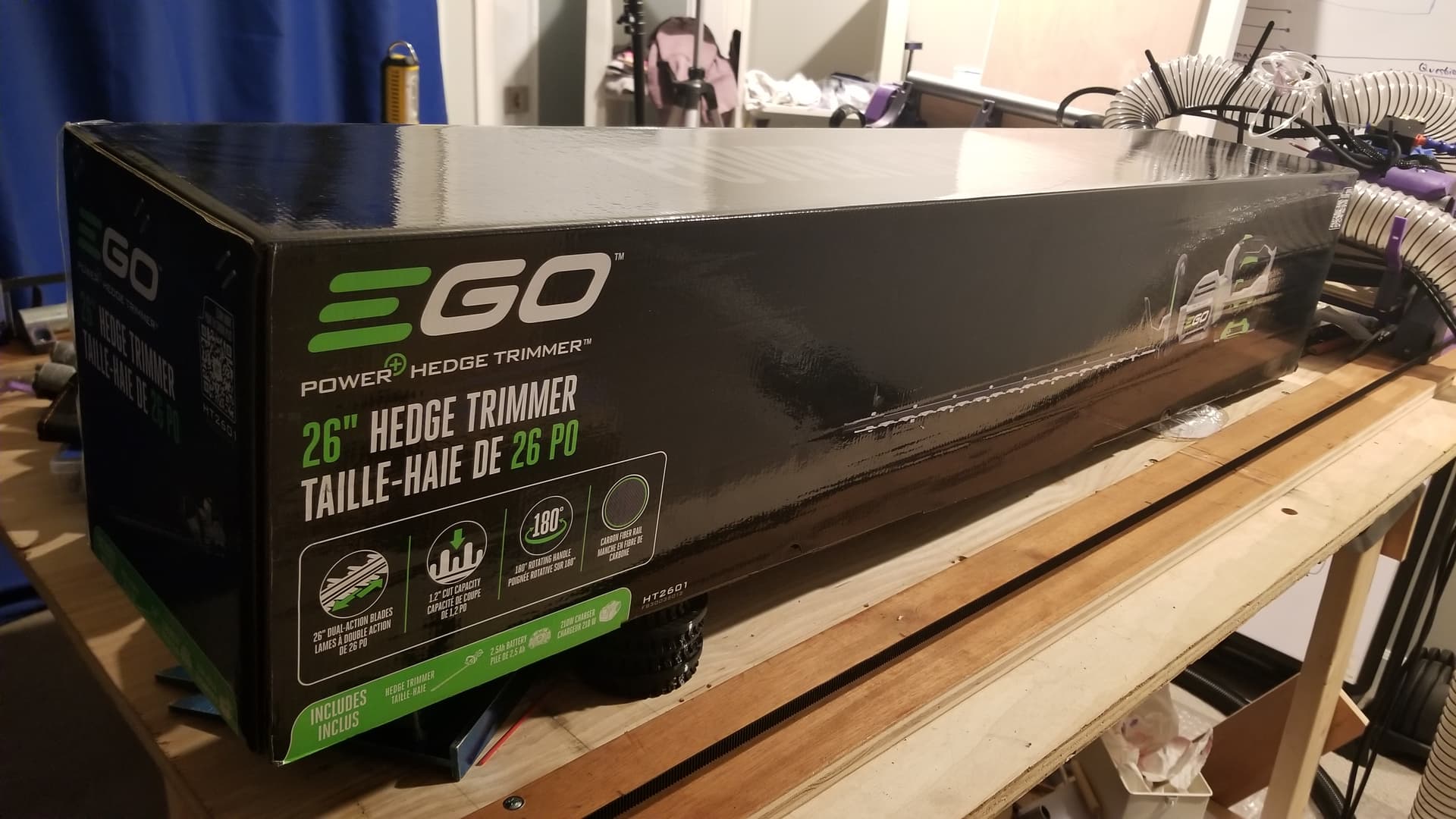

Here is where I had some thoughts, (still not executed)
https://forum.v1e.com/t/the-perfect-crate/45084
in particular
The rough dimensions I was looking for are about 12 x 12 x 48, which unwraps to 48 x 48. If it were shorter at 30" then it would be rather tiny for a LR. Oversize baggage might be worth it.

@MakerJim you having seen how I package a machine first hand, would the onshape cad for my box help you at all? Or is it too far off from what you are trying to acheive. My apologies as I just skimmed the thread for the most part. I do know my box ends up outside at 10”x12”xWhatever is needed for your beam length. And that includes a layer of 14mm foam (sheet of R3 (I think but not home to double check) insulation foam from the orange box store). It is all screwed together with washer head screws. So far that box has proved very well for me. Sad thing is the ONLY damaged part I have had on an LR4 since going to that box, was the one sent to y’all at RMRRF :man_facepalming: BUT… I am glad it was in very experienced and capable hands, and not to a customer who has zero experience with a V1 Machine :partying_face:
I would for sure plan for local Y rail purchase unless you are going for a short Y axis similar to RMRRF. Different size rails will just need different printed rail clips, easy to throw in a box or even in your other luggage.
