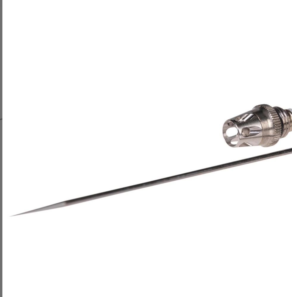

I’m looking for a suitable needle to poke tiny holes of varying size into paper. The needle should be less than 0.1mm at the tip and gradualy increase in diameter, so that the further you poke it through the paper, the larger the hole gets.
So far i have looked at hand sewing needles, which are a bit too big, machine sewing needles, which have a consistant diameter, and medical needles, which also have a consistant diameter.

The “needles” used in the cutters @jeffeb3 is referring to are made by the owners of the cutter from solid music wire. You could choose wire of the diameter equal to the largest hole you wanted and by controlling the angle when grinding the point you may be able to achieve repeatable diameter at a given depth from one needle to the next. I don’t know that I’ve got that level of grinding skill but it should be possible.

Airbrush needles are very fine, and have a linear grind on the tip. I’ll order some and give it a try :slight_smile:
I was going to recommend the air brush needle. I just poked myself with one before sitting down at my laptop.
Can you tell me how they are measured? I just ordered one that is 0.4mm, but honestly I have no idea what that means ^^’ I hope it’s the diameter of the needle, and the tip goes down to 0 :slight_smile:
Usually the size is the diameter of the hole on the end of the air brush that the tip is passing through.
I don’t know if they go to zero, but they’re needle-point sharp on an airbrush. Paint gun tips are usually a little more blunt.
