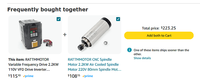

Doing some searching on Amazon for a 110v spindle and ran across this:
Shouldn’t the VFD and Spindle be the same voltage?

Hi, you are selecting a 220v spindle with a 110v VFD, tyey will not work together.

I just searched that VFD and spindle on Amazon, on the pages for both of those you can select either 110v and 220v units. So make sure your selections are compatible with each other.
On a different note, 2.2K watt is pushing the limit for a standard 110v household circuit, so you’d want a dedicated circuit with it’s own breaker to ensure reliable operation.
This was on a page for a spindle I was looking at. I didn’t select them, it showed they were being purchased together by other people, which is why I was questioning it.

Yeah, that definitely wouldn’t work well together. You could run a 220V spindle off a 110V output but it would be SEVERELY compromised in terms of power.
Just to clarify a few things, input voltage and output voltage aren’t necessarily linked in VFDs.
The one shown is 110V in, 110V out. There will be others available that are 110V in, 220V out.
As for the usable power, I’d say that it’s unlikely that you’d actually end up drawing that much power in practice. Some of it will go to heat loss but a spindle with no load will run at dramatically lower power than a spindle that’s cutting hard. I doubt any machine built or any toolpaths that will be run will get all that close to the 2.2kW rating. Assuming ~80% efficient for the VFD and more like 1kW of actual real load, I’d personally be comfortable trying that out to begin with, at least, on a 120V 15A plug/socket.
@Michael_Robinson In this case it’s more of a nomenclature issue. That device is specified for 110Vac ± 15% which is 94V to 127V. The ‘official’ US mains voltage is 120V ±6% which is 113V to 127V. So it’s not just a case of comparing nominal voltages, it’s worth checking the tolerance/input range as well.
