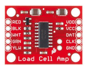

You dont need to do any programming if the microcontroller is esp and the info is going to home assistant:
You write a little yaml file and define the pins for the hx711 and name the sensor. Then you can flash the esp through a web interface and it will handle connecting to the mqtt or home assistant instance directly.
This is what I use for all my home esp32/esp8266 devices around my house. They are pretty reliable. I normally would not want to use wireless in production. But if you want wifi, this is the quickest way to get to the finish line.
ESPHome is available as an “Add on” if you have a HaOS install. The yaml needs a few boilerplate things like the ha address and wifi ssid/password. You can put that into a common.yaml. You can also do variable substitution so you could just have a specific yaml file that looked like:

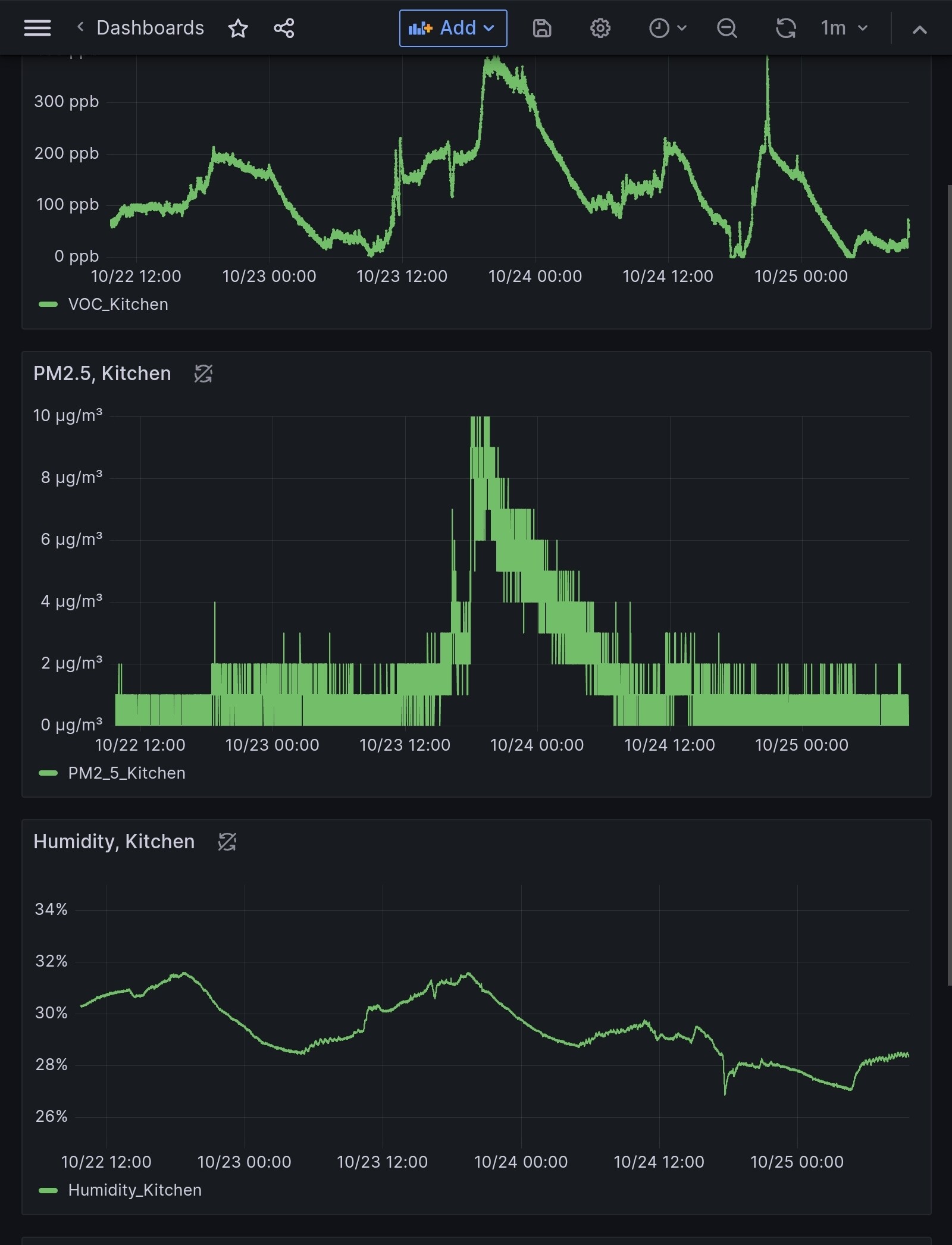

In my case, I happen to have several temperature sensors around the property, both inside and outside, moisture sensors, particulate sensors, VOC sensors, etc. I think there are more than 20 devices talking to the hub.
The item of interest for this discussion is a load cell based scale. The problem that I wanted to address was to learn how fast the moisture actually evaluated from the synthetic planting mix I use in my vegetable garden. In addition, there is a question of the accuracy of the moisture sensor.
In the actual experiment, a known quantity of water was mixed into a known amount of soil and both the weight and the nominal moisture content were monitored as the water evaporated. The frequency of measurement was overkill, about once every 5 minutes, but both data streams were sent to the hub using the FDRS protocol, on to the MQTT broker and ultimately fed into an Influx database and graphed with Grafana.
On my setup, I’m using the usual load cell with the HX611 that is connected to the Seeed Studios Xiao ESP32C3. (There is also another ESP32C3 at each sensor location, although there can be multiple sensors connected to a single ESP32C3, typically communicating over I2C. All of the data streams are then sent to the hub using the FDRS simultaneously.
Unlike others, perhaps, I choose this canned solution because it didn’t require me to do much programming. All the sensors are well documented and have Arduino code available. All of the specific ESPNOW and LoRa stuff is embedded in the FDRS, so if I could program the device in the Arduino IDE (or PlatformIO) then it could be integrated into the network with essentially no additional work.
And for the case like moisture sensors, where there were several units, they just have a number that you assign for each location. I believe it can handle up to 64 units or something.
I know this is long-ish, and may not be relevant, but it would be a pretty easy way to get you first 5 units set up and tested to see if they would meet your needs.
Screenshot is from the sensors box in our kitchen.

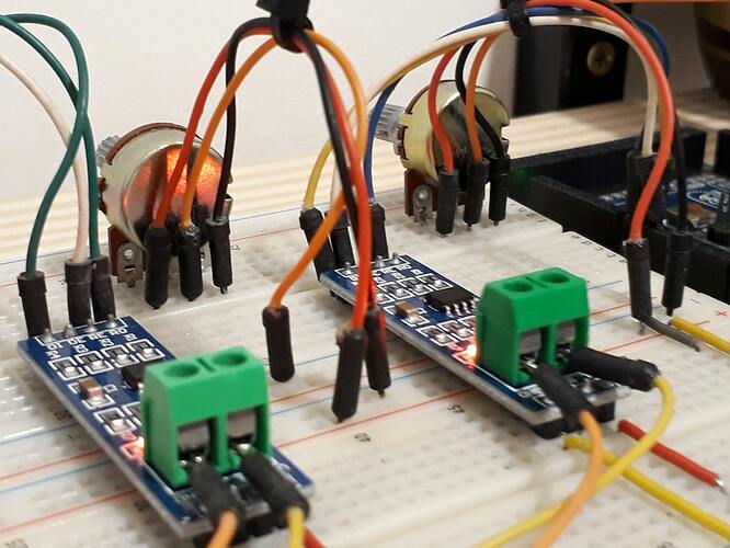

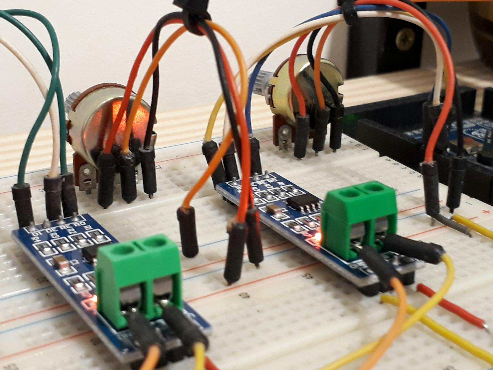

O.k., I am not sure, but I think I may have found a way to do what I want!!!
I need to get the load cell added but first things first, i am going to try and follow this project!
It is doing what i wanted, call the i.d. get the value. In the end the value will be the weight from a load cell :slight_smile:
I said I released this, but I have NEVER been good at releasing things :slight_smile:
ohh, and I forgot to mention, it looks like the developer here at work already has a way to read from the slave devices, using php, so i do not think I need the master!
