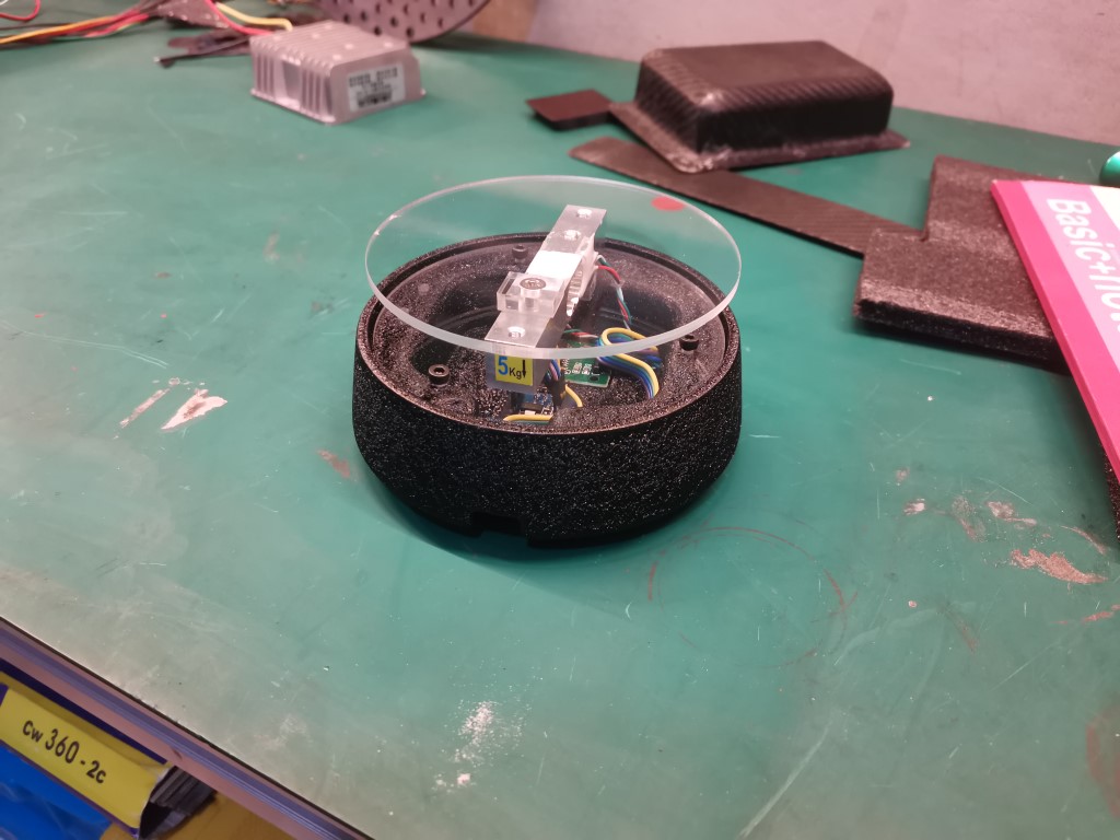

I did something vaguely similar a few years ago.
I simply used an arduino nano and a load cell. The load cell comes with a little amplifier circuit, make sure you’re getting it otherwise the arduino won’t be able to measure the load. I connected it to the nano so it could interpret the load value, then the arduino transmits the value over the serial port with simple serial commands. It is super easy to do and it works well.
It looked like this:
With the arduino platform it is also very easy to add communication modules like bluetooth or wifi so you won’t even need physical cables from one load cell to the other.
In my case I was just using an usb cable to connect it to my computer.
If I were you I’d have one arduino nano per measuring device (they are super cheap), and then each arduino would send its data over serial either via a cable or via wifi to a Master raspberry pi in charge of collecting the data from each of your sensor. It would then be in charge of making sense of these data and organizing them so they could be used by your ERP system.
