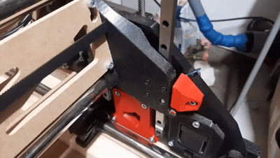

Hi all,
This is during homing and it repeats until power cut off. Looks like stepper losing power for very short period of time, but my suspicion is it may be connected to connection between lead screw and stepper. I tried to move it by hand, but there was no obvious signs of failure there.
Have you guys seen something like this before?
fallingofz
Loose grub screw in the coupler?
Loose wire to the motor?
Did you put lube on the leadscrews?
This was my first guess. I will look into this then! Thanks!
yes I did!
We have a winner! Two winners actually!
They got thread lock as a prize!
Thank you Jeff and Jon! :slight_smile:
We need a “loose grub screw” badge :rofl:

Are you using an SKR Pro v1.2 by chance?
I have had something like this happen on my LR3, which used an SKR board.
If the screw stub hits the top of the cutout in the YZ Plate, the motor temporarily loses power and drops under gravity, then tries to continue homing.
See the videos in this post… (read the first post in the thread as well)
Not sure what causes the motor to lose power, but the way to make it stop dropping is to adjust the endstop so that it fully asserts before the lead screw stub hits the top of it’s travel (it will still drop if it travels too far, but at least you can get it to home properly.
