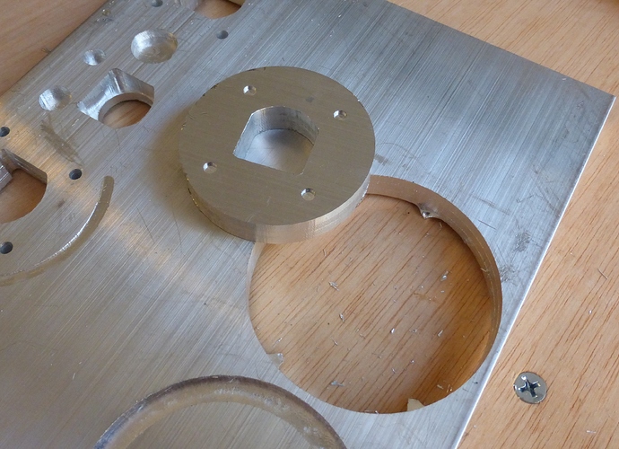

Well it seemed to stop, for whatever reason. Had some success today though. Finally made through 1 tool path without any troubles. I really need some compressed air though. The total toolpath was about 30min, and vacuuming chips for half an hour gets old. Still though, 3/8 aluminum plate is tough and not easy to go through especially with a $400 machine.
I ran out of good single flutes, so this was with a sharp dual flute. I like single flute more but it is far better than using a dull single. Tolerances check out, except for that estlcam doesn’t seem to have an oversize finish pass option, so the part comes out the exact dimensions in the CAD file. This is good and bad, just means I have to oversize on my dxf drawing.
Later tapped the holes M4, and did the M6 set screws that go along the sides.
Looks really nice! Just FYI most cnc’s don’t have a ‘finish oversize’ option. When designers are making the CAD they will typically design with tolerances in mind. The software doesnt know what dimensions you are OK with being over or undersized. Sometimes its even left up to the machinist at the machine to determine what offsets he wants to set on OD and ID cuts based on how his machine is cutting that day and the tools being used. Just keep it simple for now. Remember you can always take more off, but its a bitch to put it back on…if you can.

Thanks, and I will keep that in mind. Normally on fusion 360’s CAM, I do a contour finish pass where under “Stock to Leave”, I put a negative value which actually does oversize on purpose. It’s a cnc router so tolerances are pretty loose. I am getting within .1mm which is great for my purposes. Very true about oversizing, it’s so easy to file fit vs trying to…idk shim the fit with something else.
SD card sounds like a good idea. 30 minutes is mostly due to the fact that my toolpaths are trochoidal. The advantage to this is that I can do really deep cuts without the chips getting burried in a 3mm wide slot. The disadvantage is that I actually have to remove more material than “necessary” to create the cutout geometry.

Drop down to the last four rows of pictures. I shortened the mpcnc back to my first dimensions. Have about 510 by 470mm of cutting area. After surfacing the spoil board I tried cutting some 2" aluminum bar. Didn’t work out so well. So I attached a second piece of mdf on top of the first piece, and attached a half inch piece of plywood to that. Then I did the masking tape and superglue method of attaching the aluminum to the plywood. Much better results! End goal is to mill out some name plates for my ladders at work.
Is that climb or conventional? 6061?
Hate to just barge in on the answer but it looks like conventional. Climb almost always works better, the only downside is your bits can grab into the material and break your bit if you don’t have things really perfectly aligned. I’ve had it happen :frowning:

Squared everything all over again and my results are coming out fantastic. Once I get the air blast, I have full confidence in the mpcnc. As of now I have to follow the bit at all times with the shop vac or the chips build up in the slots really quick. It’s kind of cool, the chips form a fuzzy texture in a pile. They’re really nice chips though, like a small version of the ones you see in those youtube machining compilations.
To anyone else trying aluminum, always CLIMB mill! On the finish and on roughing. Conventional isn’t better at doing anything. The only time it doesn’t matter is during slotting.
Finished setting up the air blast today, maybe needs a little cable management. I went with a Husky 4gal from Home Depot. 3.7SCFM @ 40psi. Everything used was like a 30 minute drive. Plus no warranty.
The air nozzle I got is sort of junk, but for $8 I wasen’t expecting much. The air leaks through seams in the flexible portion of the hose, which wastes pressure. It is made for coolant to be run through it as well. Might run coolant one day but=that is a little overkill for now. I ran the air at about 40psi at a constant pressure, all in all it works well and the chips go flying all over the place like anticipated.
