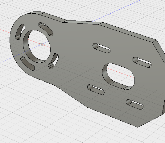

I just want to fix the little things. That video was really just a showcase, it wasen’t even properly edited or filmed. I don’t really care how long the part takes, I just want it accurate and most importantly, reliable. Included a pic of the part incase you’re curious. It is a motor mount system for an electric longboard conversion.
I wanted to do a small production run of 20 and sell them. If I could get one made per hour I would be happy, considering each one sells for about $40. Watched the interview you did which got me getting a little interested in making some quick cha-ching.
