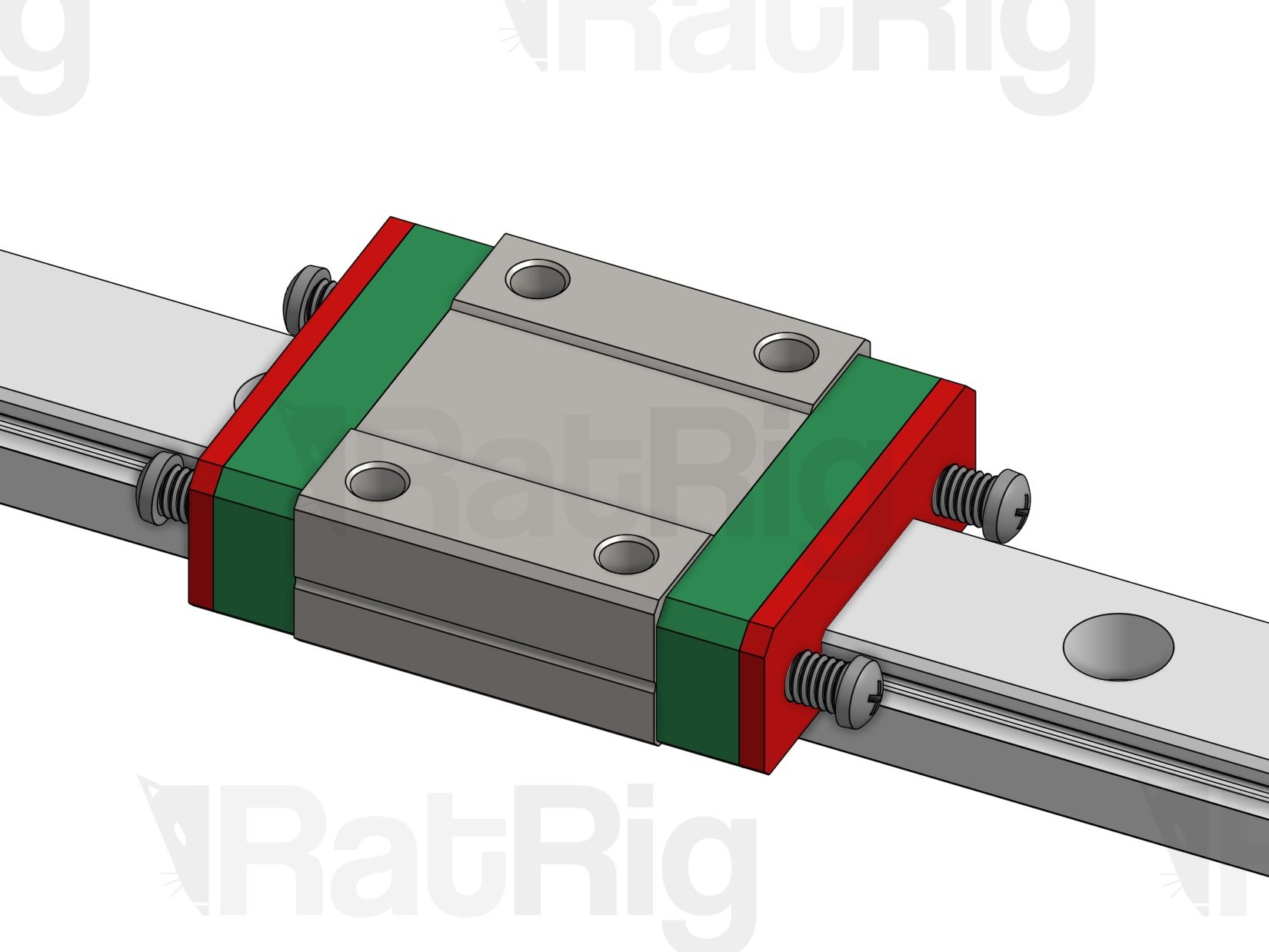

Hello,
Thanks for the tips. I think it was debris in it. I ran this process on the bearing block.
With the end block end screws loose, per step 2, I flushed them with isopropyl alcohol and there was a very quick response to its movement. SO much smoother again.

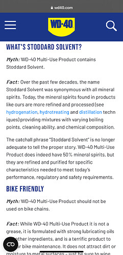

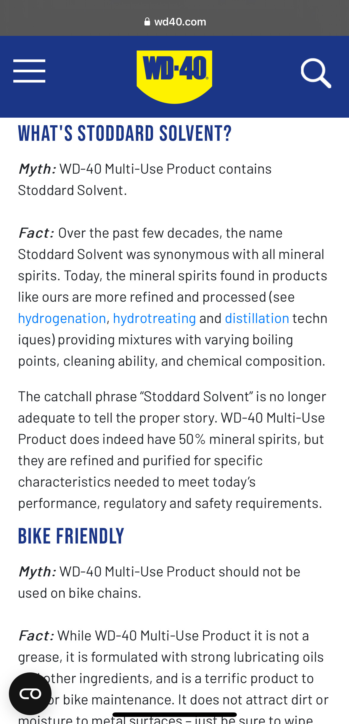

well… Here’s some quotes from the WD-40 official ā€œEXPLORE MYTHS, LEGENDS & FUN FACTS OF THE BLUE & YELLOW CANā€ page…
ā€œWD-40 Multi-Use Product is a unique, special blend of lubricants. The product’s formulation also contains anti-corrosion agents and ingredients for penetration, water displacement and soil removal.ā€
ā€œWD-40 Multi-Use Product does indeed have 50% mineral spirits, but they are refined and purified for specific characteristics needed to meet today’s performance, regulatory and safety requirements.ā€
ā€œWhile WD-40 Multi-Use Product it is not a grease, it is formulated with strong lubricating oils and other ingredients,ā€
I’ve seen other people describe it as a lubricant, dissolved in a solvent…or something like that…maybe they are at least partially right…
ā€œAnd, if you really need the secret formula, you can find it……written on a single notepad……locked in a vault……somewhere in California……if you can get in.ā€
in the bottom of a locked filing cabinet stuck in a disused lavatory with a sign on the door saying Beware of the Leopard.

Unfortunately these kind of linear rails are very sensitive to dust and debris, I use these a lot but I never really trust them. They rarely bind at high speed, but they very often do when moving at very low speed.
Even the Hiwin brand which is supposedly the best of the cheap chinese ones aren’t immune to this phenomenon.
In my opinion their design is inherently flawed because the balls path is composed of three different parts, and there are slight gaps between each part so sometimes the balls get stuck until there is enough pressure coming from the balls behing it to push it back on track. The transitions between each part is the real issue.
I spent a lot of time trying to debug these things on a few of my machines, taking the bearings apart, filing the plastic parts to get them running smoother and then putting back the billion of tiny balls while losing half of them. It’s always a huge pain.
I wish there was a better alternative, they do work for most applications but they aren’t always super reliable.
