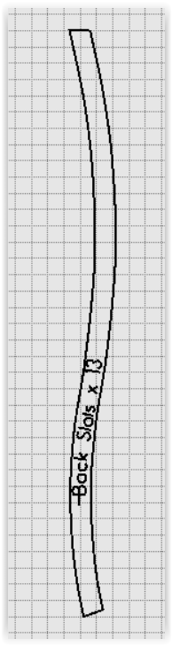

I need to cut out pieces for my Adirondack rocker on the LR4. The material will be redwood, 1.5” thick. With this cutting depth, I’ll using a 1/4” bit that has a 2” CL, and is 4” long, which means that more than 2” will be protruding from the router.
With this setup, I’m concerned about excess stress on both the LR4 and the bit, so I’m inclined to take a very conservative approach, at least initially. In particular, I’m thinking of trying a 3 mm DOC and a feedrate of about 500mm/minute.
The first pieces (back slats) are not extremely intricate, but as the slot gets deeper, I’m concerned, even for simple rounded turns. Here’s the part. The grid is about 25mm x 25mm.
I’m wondering if others have experience with this type of project on the LR4, and if so, whether I might use somewhat more aggressive settings.

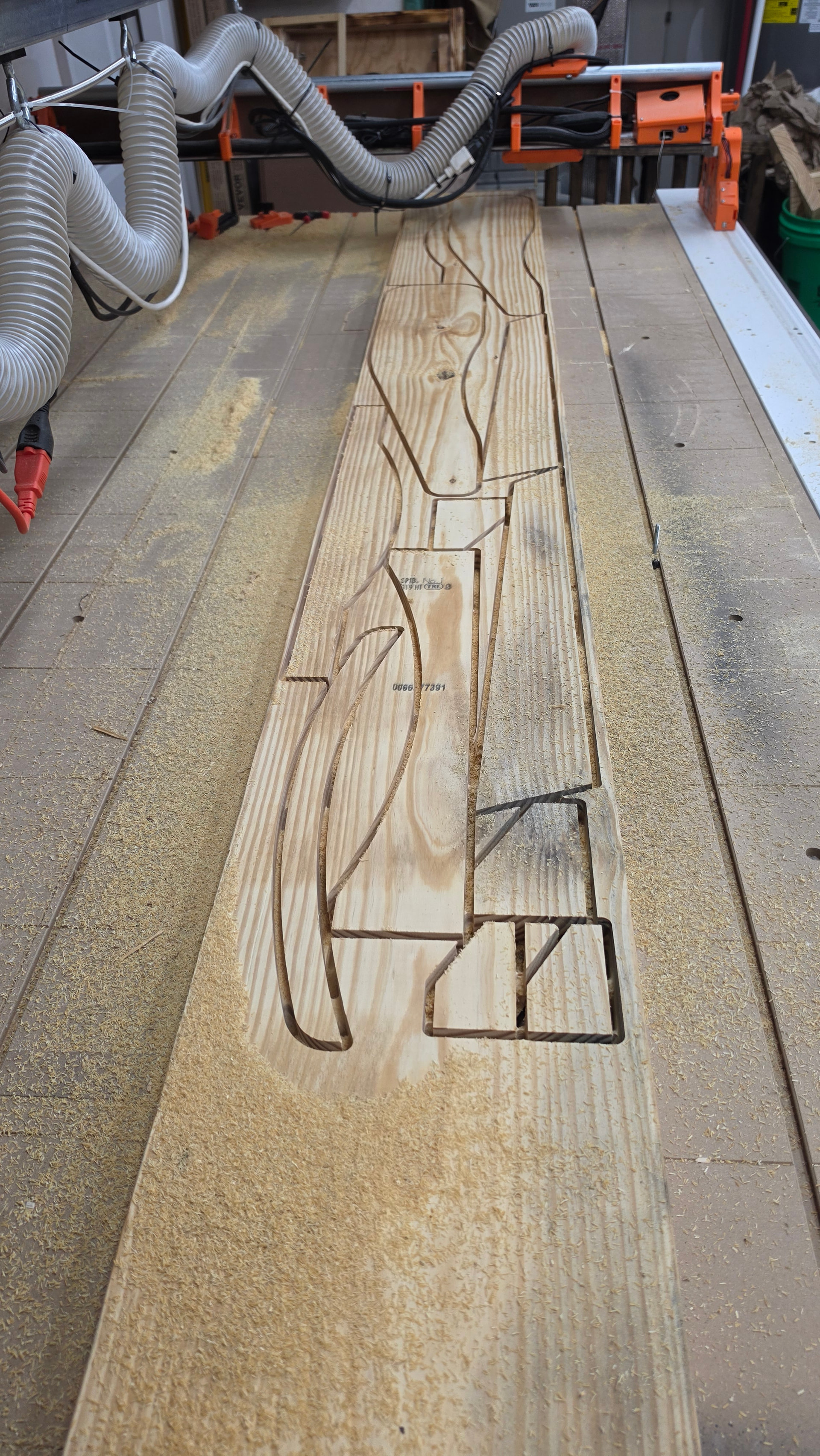

I regularly cut 1.5” pine boards with no issues with more aggressive curves than that. The LR4 has no issues with it at all. I cut at about 50 IPM (1270 mm/m). I use 3/16” (4.7625 mm) DOC.

This is the bit I use: 1/4" Extended Reach Upcut from Cadence Manufacturing
I just used screws at each end of the board to hold it down.
I also used Deepnest.io to nest the parts together to cut down on waste.
