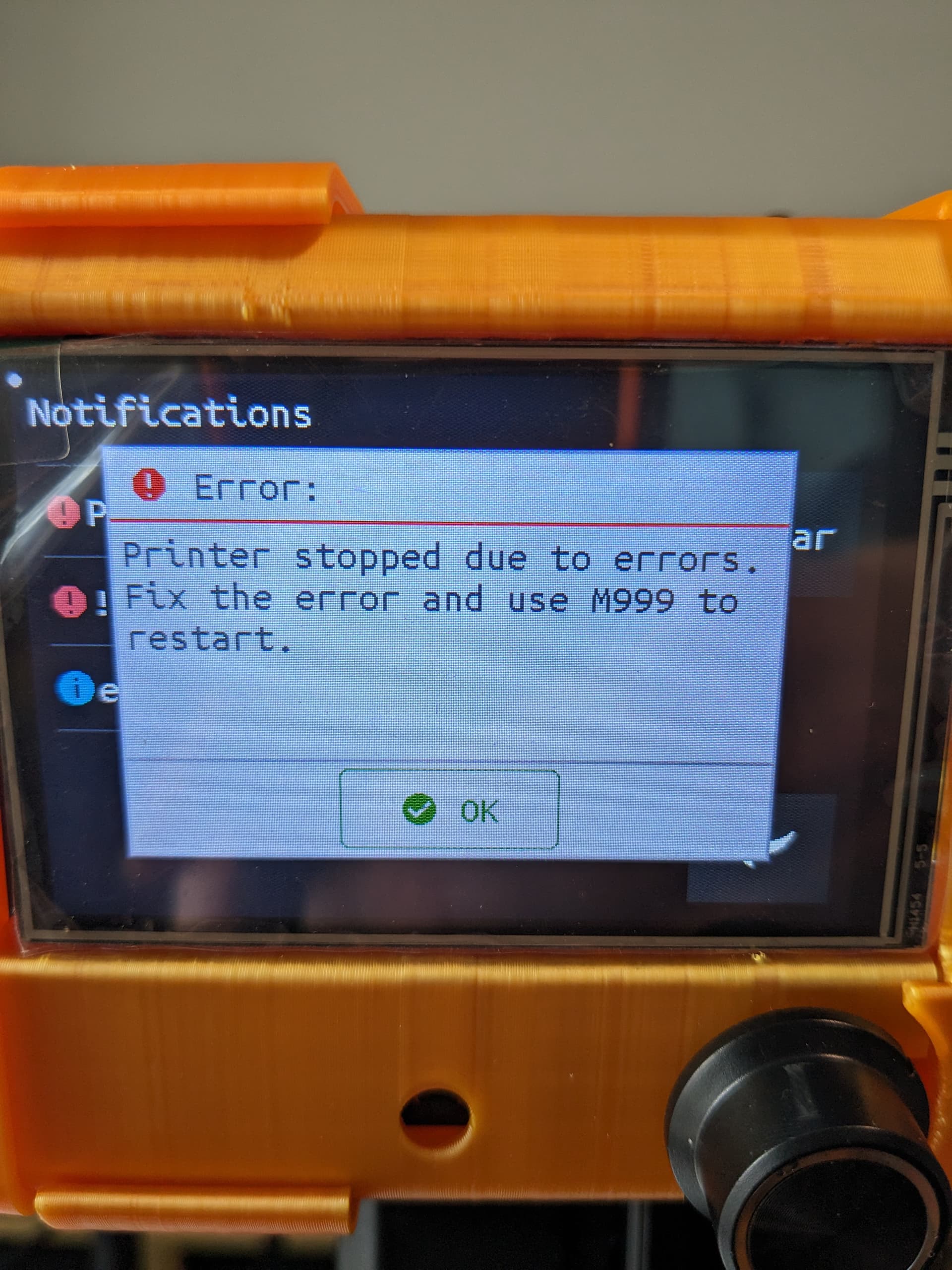

When i tried the home function on the touchscreen, the head unit moves properly from right to left and front to back triggering the switches and stopping the head unit, however once the head unit moves back to the center of the print space, marlin is outputting the following error codes.
When home function is used on the touch screen and homing completes the following error codes are…
Is there something that I need to change in the settings or configuration file to prevent errors when the home function is used?
