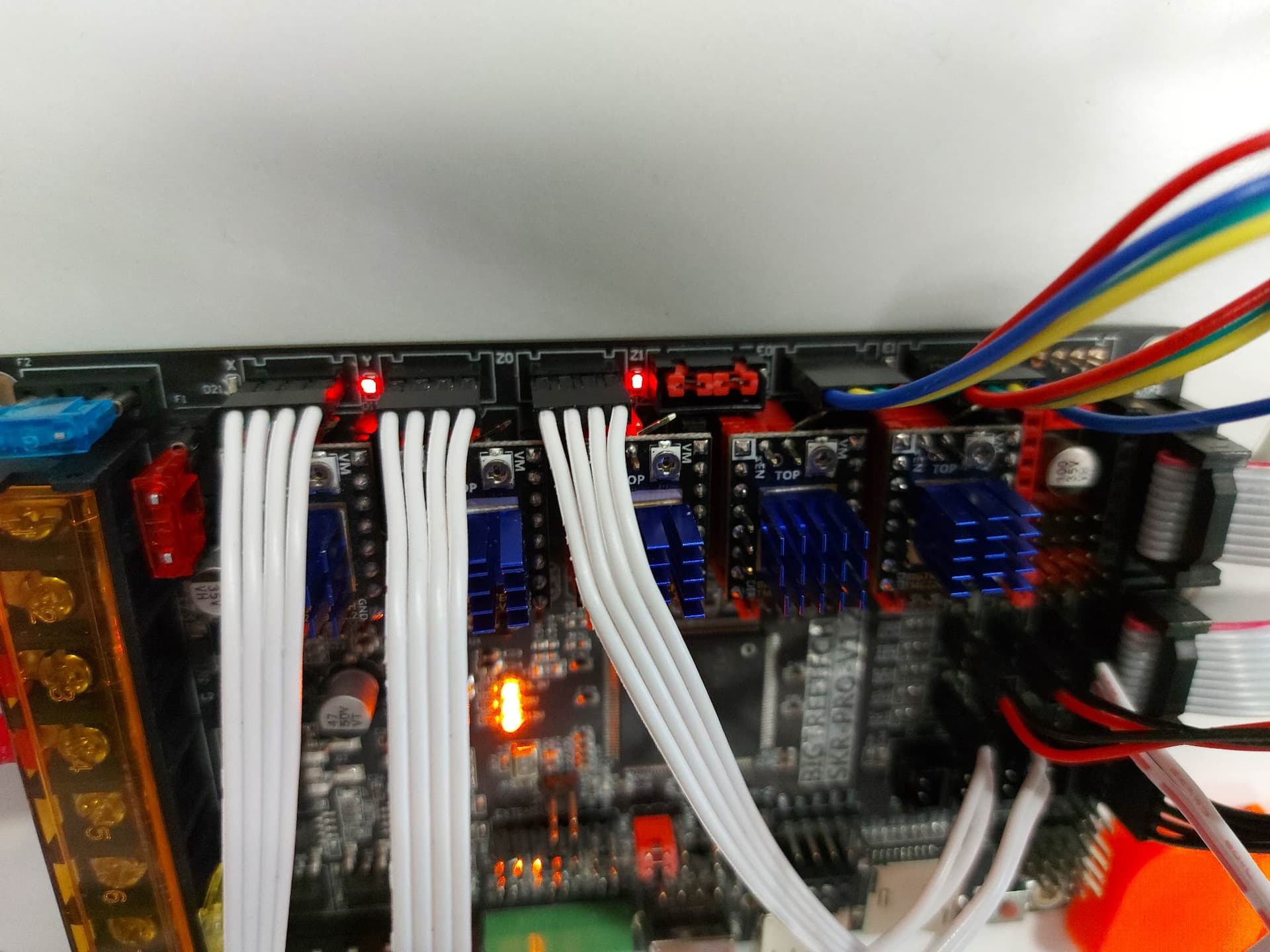

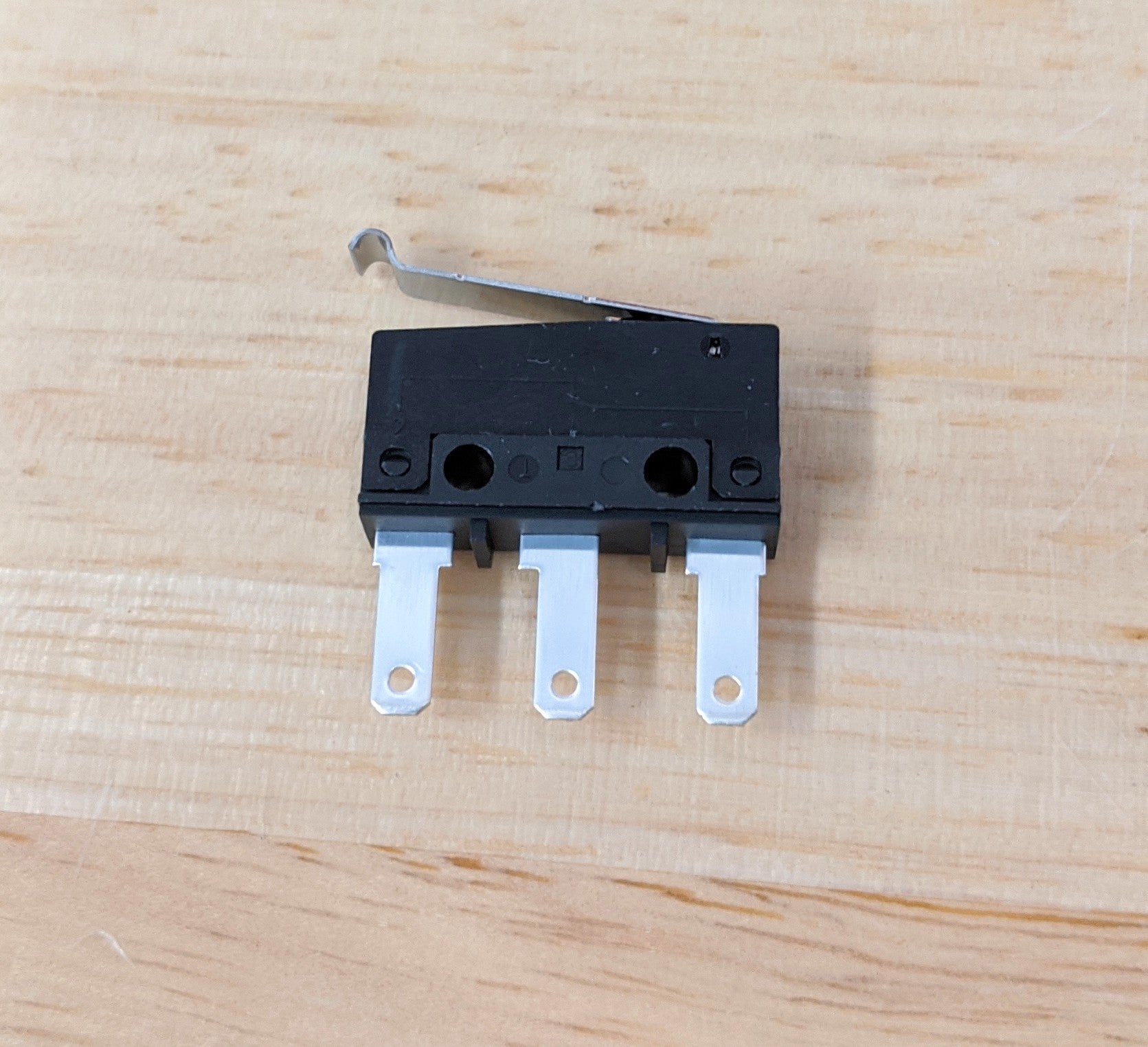

Should stepper motor reverse or react in any other way, while manually through display controlling movement? These are endstops I am using:

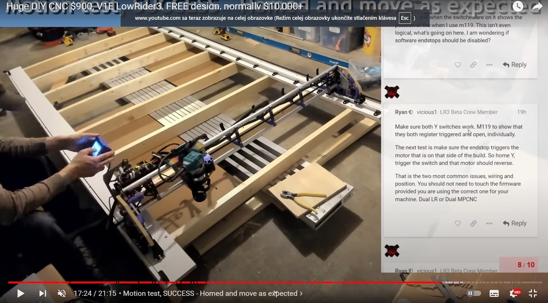

I am wondering because of Ryan response
when endstop on my LowRider is pressed and it is connected to the board, LED is triggered (like this Y for example)
so board is registering them, but there is no reaction from stepper motors. I just hope I did not destroy anything else, except of the drivers, I posted last time.
Thanks
No. It’s just for homing as far as I know. It won’t stop the CNC mid-cut either.
Ryan also says “Home Y, trigger…”.

Manual jogging, and Homing are different.
Homing will cause machine to reverse just a few mm after endstop is hit.
Where as manual jogging (not homing), by default, will ignore the endstop state, you can ram into x/y min or z max and the steppers will ‘skip steps’ making loud grinding noises, but mechanically nothing bad is happening, nothing is physically getting damaged. Behavior might be different if soft Endstops are enabled.

Just to clarify - the Marlin firmware controls whether endstop (or limit) switches are honored outside of the homing cycle (the series of operations done to home the machine). The default setting in Marlin is for homing only. This is fine since the motors will most likely skip steps before they damage the physical machine.
Other firmware and other machines may choose have limit switches active all the time in order to prevent the machine from damaging itself if it’s sent a bad command or something else unexpected happens.
(edited to add this final paragraph) But the motors in the MPCNC machines aren’t strong enough to do damage to themselves. The motors just skip steps rather than tearing the machine apart.
