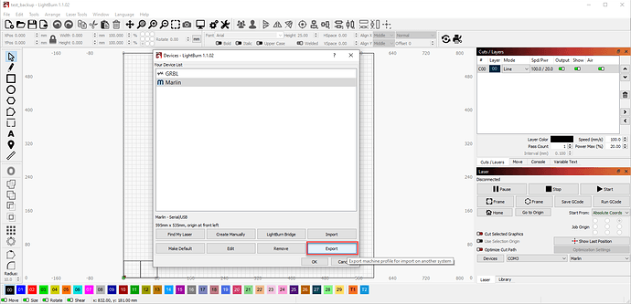

If its not to much to ask do you think you could export your Device setting this way I could just reuse it because yours work perfectly !!!
Marlin2 is just the name I gave the device when I created the profile. Here is the export of the device settings:
Marlin2.zip (1.0 KB)
Many many tks Robert your setting made everything work like a charm!!!
