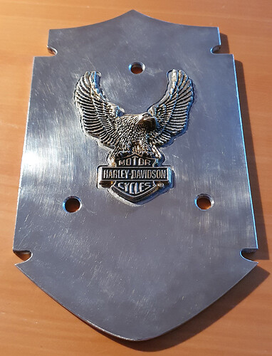

When you see the inlay projects that have been posted I would say yes 0.2mm and much less is clearly very achievable.
Despite what you might read from others who say say 0.5mm is the best it can do - there is ample evidence to the contrary.

Even here I get a precision of 0.1 - 0.2 mm in moving and turning the object a couple of times.
With aluminium - even AW7075 - I get 0.1mm precision but of course you need to reduce speed.
