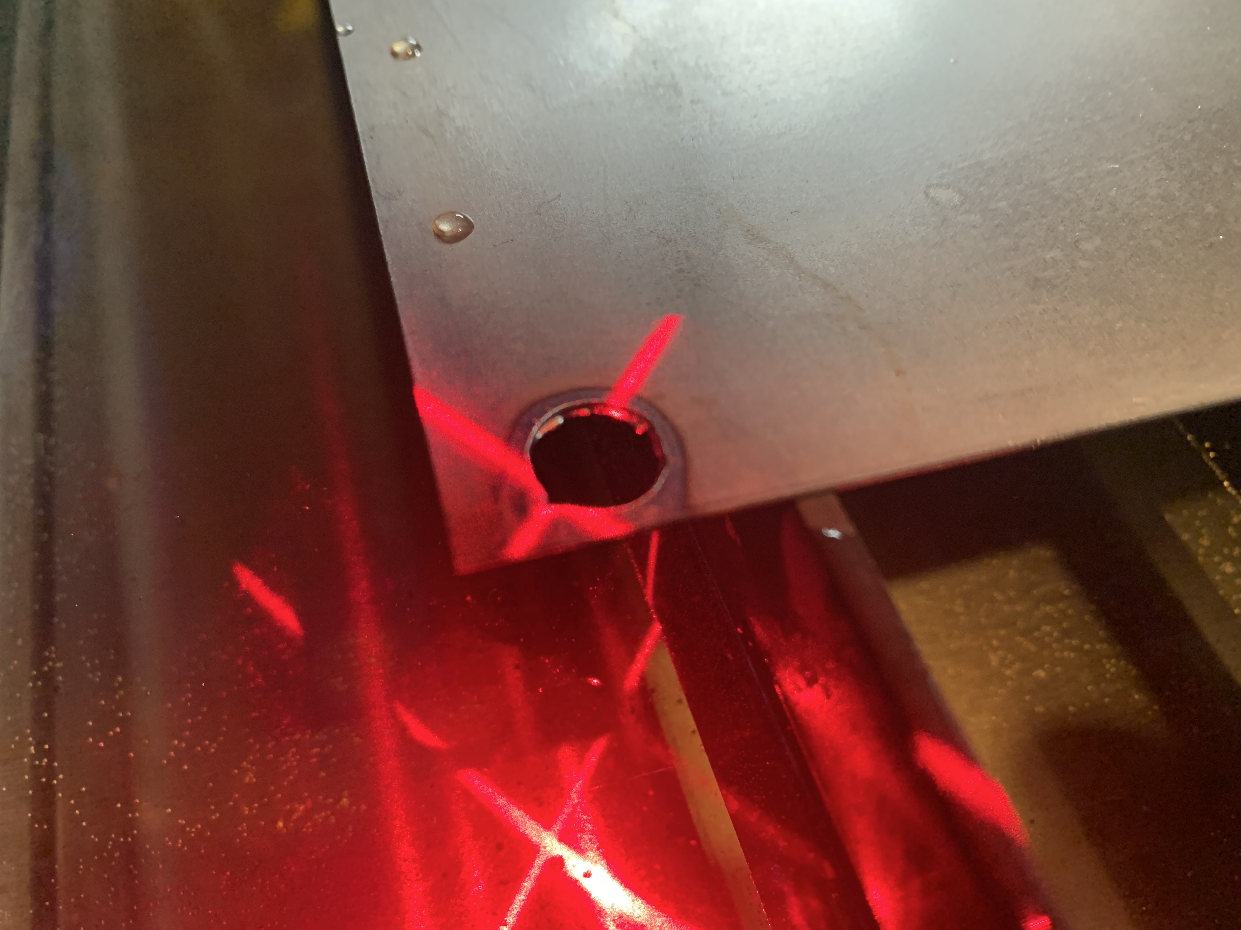

Myself I would be more interested in a cross hair (or how is it called?) So I could find the spot I want to start easily. On my LR2 that’s one of the things I spend time on quite often as I try to use as much as I can from a piece.

As you may know, I did set up crosshairs (red “sight line” lasers) on my plasma LowRider 3. That was a bit easier to do placement because the machine torch (pencil torch) is narrow and vertically is a low profile to shine around. To model for a router based LowRider 3 would require the two perpendicular lasers line diodes to be mounted wider apart, lower down, and pointed more acutely sideways. It’s totally doable, and the diodes I used should be linked in my “LowRider 3 plasma on a budget” thread.
I may work up a model set for that!
I’m thinking a printed plastic yoke could be added onto my remix of the pen mount.
Here are pics of my crosshairs lasers working on my plasma build of LowRider 3:
