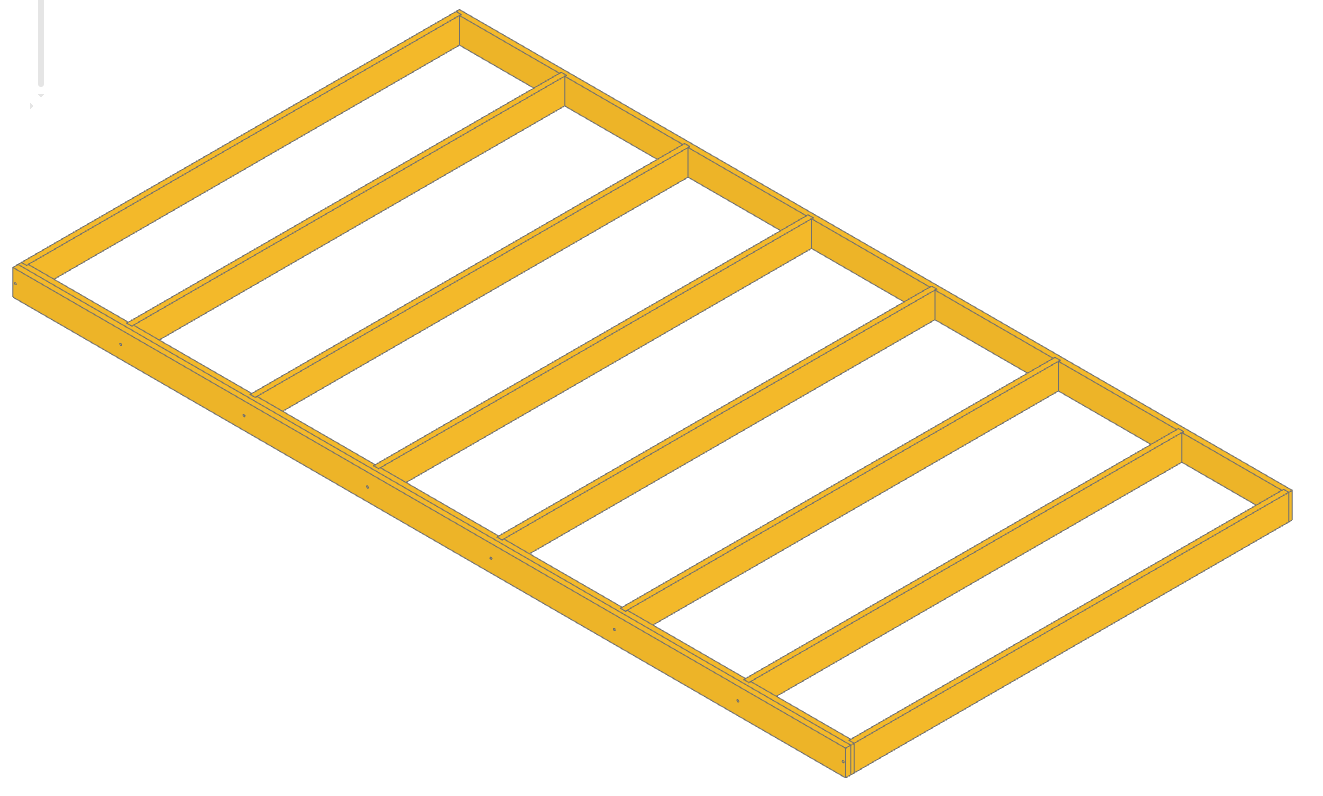

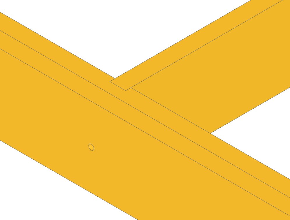

So here we are now: 12mm OSB, doubled up to 24mm on the long side with the cross spars sitting in shallow dados for alignement.
The single screw hole will probably turn out to be two screws and a lot of wood glue.
I can get the beams very straight on one side by running my tracksaw along them after gluing them.

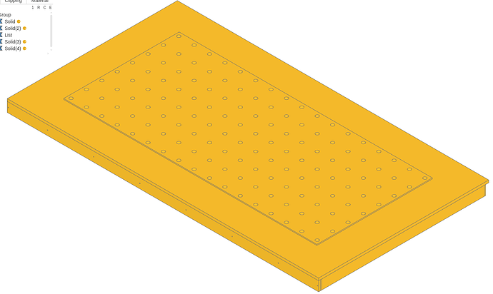

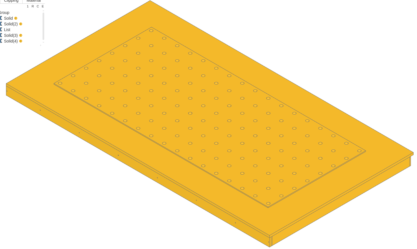

The tabletop will be a 15mm OSB sheet with an MDF spoilboard on top and 20mm dogholes in the same spacing as an MFT.
These will be partially cut by Laura herself, and potentially finished with a templating endmill by hand. Since she will be getting raised rails to ride on, I’m not keen on installing an endmill long enough to cut through the entire table!

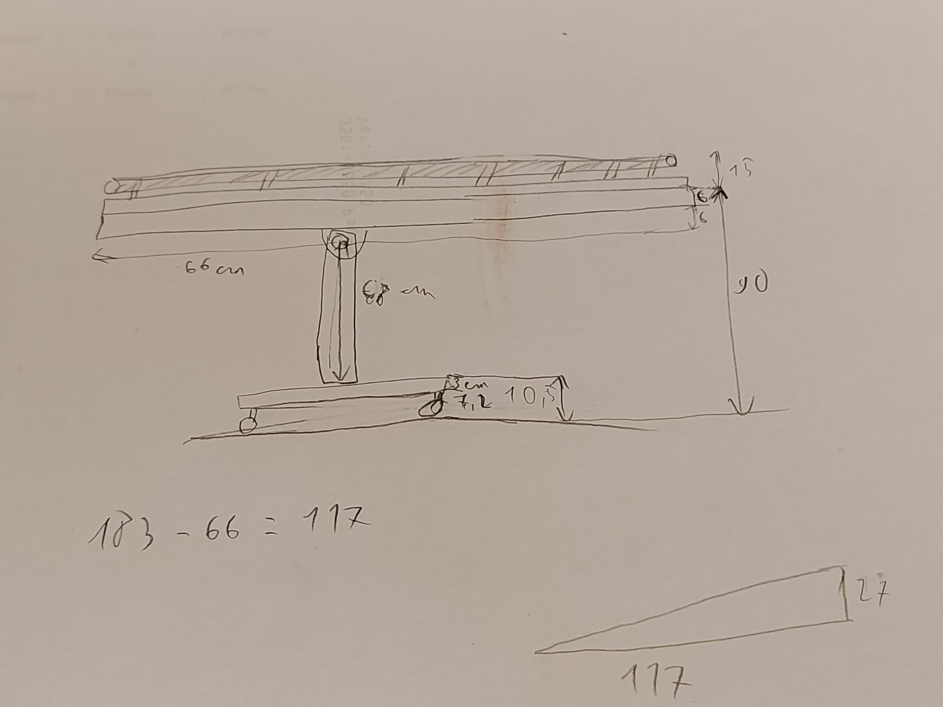

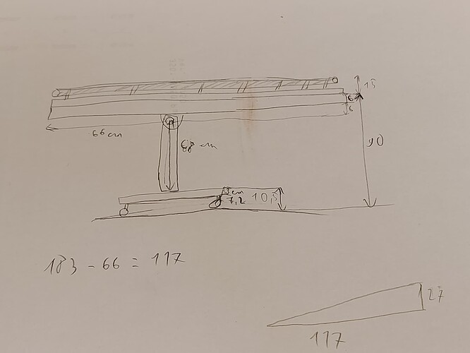

Did some measuring and sketching, I’ll be able to get a workable y range of slightly above 1620 and still have her on a flip-up table for storage.
And relearned why I usually don’t draw on paper.
Sawhorses will do fine for the beginning, I don’t want to overdo the table for now.
