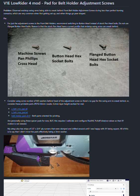

But today is the day that it overran an end stop switch on the y-axis. This ended up in a bent end stop arm and the switch needs to be replaced. I remember others had overrun their end stops as well. Before replacing the switch I wanted to ask whether there is any updated end stop design to consider? I can imagine that putting a nut behind the screwhead would reduce the risk of catching an endstop arm.

I added these after bending one of my endstop arms. They go on behind the screw on each side. I’ve never had it over run the screws since adding them. I think Aza made them.

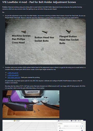

Shared what I’m using at https://github.com/aaronse/v1engineering-mods/tree/main/lowrider4/mods/belt-holder-pad
