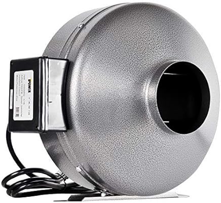

One of these guys is what you want. Exhaust it to the outside(preferably not at a neighbor’s kitchen windows). Don’t try the fans that actually look like a fan in a piece of heater duct, they don’t work that well for obstructed enclosures.
Nice I bet that would work very well.
I have one of the little boosters you say not to get…yup, doesn’t do squat. I thought I could use it as a supplemental at the end of my duct, nope.

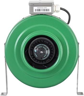

I’m in the process of creating a ventilation system for the laser. I’m building a wooden box around the machine. I first want to just extract the fumes outside but will eventually want a carbon filter. I’m looking at this fan… https://www.amazon.com/VIVOSUN-Inch-Inline-Ventilation-Duct/dp/B01M7S46YZ/ref=sr_1_5?ie=UTF8&qid=1512419551&sr=8-5&keywords=inline+fan

Just ordered this one (6")…
It’s a small price to pay for your health. It should arrive in a couple days.
