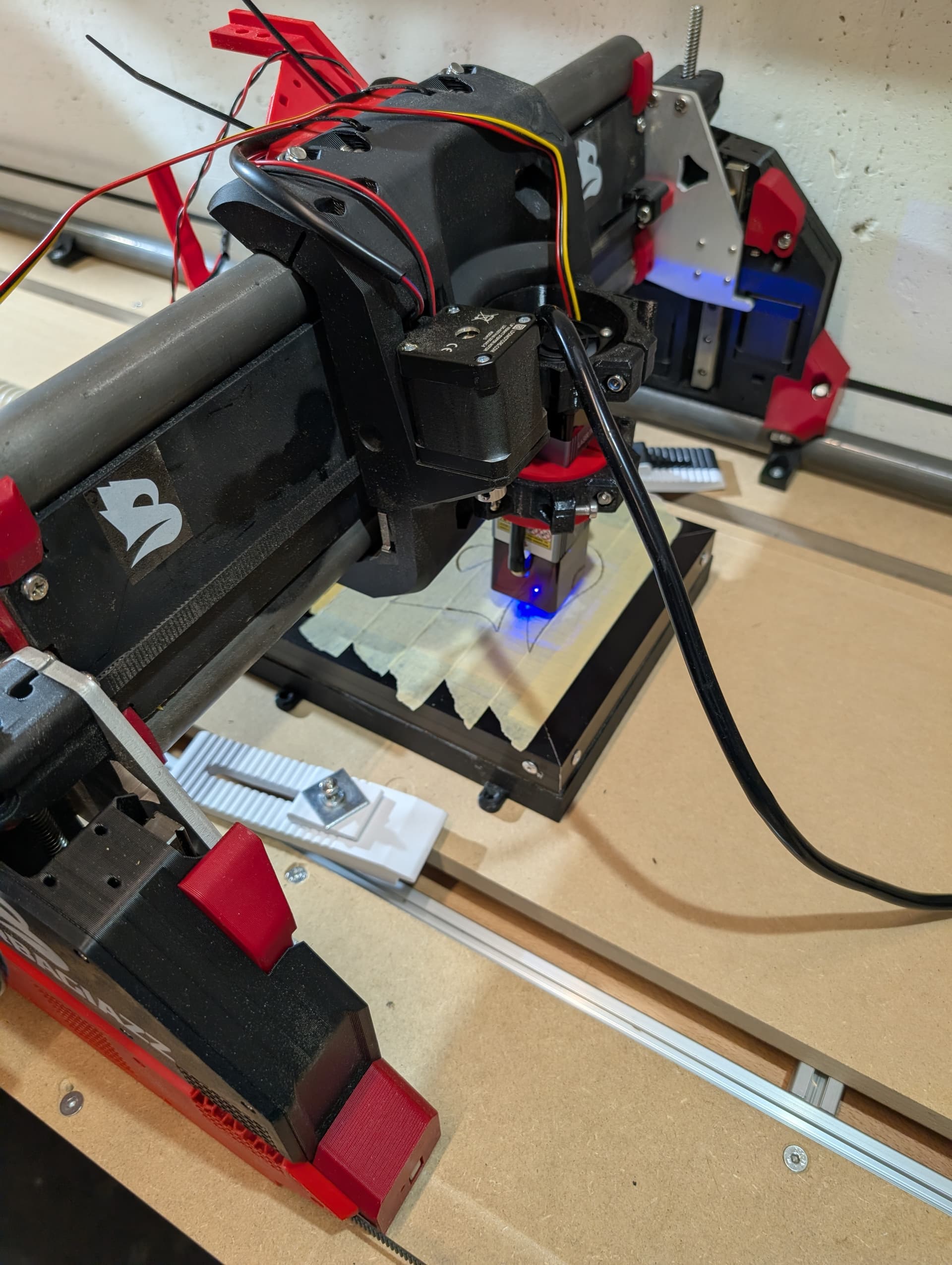

I just got a 30w output laser module and am trying to find a mount for lr4. I’m a little afraid to use the kinematic mount as its quite heavy.

I think im looking for a mount like this but for lr4 kobalt:

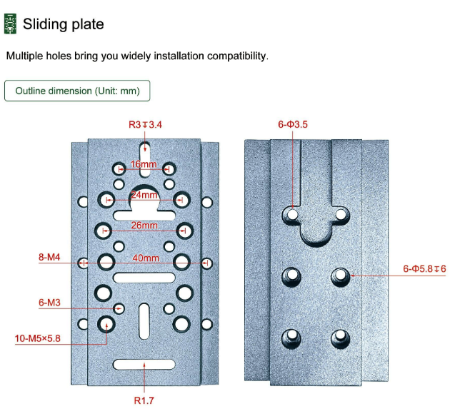

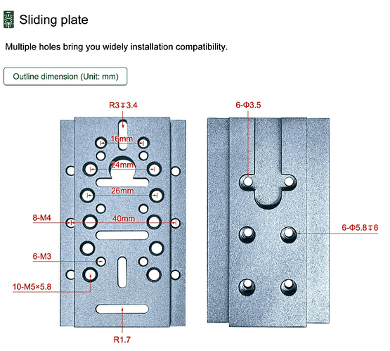

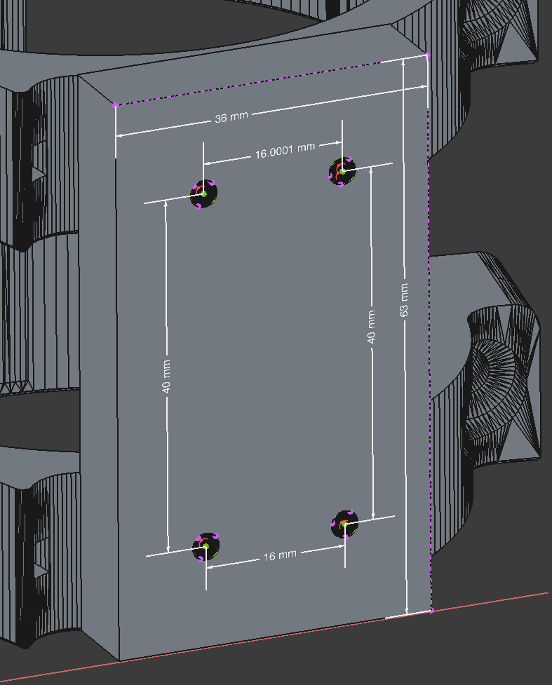

Can you roll your own? Just poking around in that Makita mount for the LR3 it looks like he used a 16mm x 40mm bolt pattern. The plastic mounting surface he added is just a rectangle, 10mm x 36mm x 63mm. The laser’s user manual suggests M3 mounting screws.

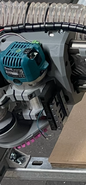

I have tried several different methods for attaching my 40w LaserTree module. All have thier benefits and all have drawbacks.
I’ve settled on this setup https://www.thingiverse.com/thing:4643645 which requires replacing the Makita router I use with the laser, which only takes 5 mins, but it allows you to use the same origin as the router bit.
Having the laser mounted at the same time as the router gives problems with dust buildup on the laser lens (which reduces the efficiency and can cause fire), you also have the issue aligning your job with the offset position of the laser. I already have to reconfigure my system as the Jackpot board connects via wifi for router job setup, but the laser runs via usb connection for my Lightburn control. So an extra 5 mins is not a problem.
The only other mod I had to make was splicing my Makita power lead to put in a Euro plug connector, so that I could attach/detach the router easily.
The mount I made uses the router mounting holes. Adding and removing it onto the dovetail rails using the thumb screws is easy and repeatable - probably not as accurate as the kinematic mount.
You can configure the origin offset in lightburn so if you use the same dxf and zero point you can laser and cut on the same workpiece and they’ll be aligned.

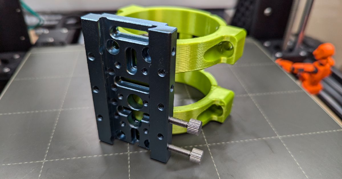

I use this solution on mine:
it is a simple cylindrical holder fitting in the makita holder with a square hole for the laser and a round hole for the air assist.
I need to upload the design to makerworld but in the meanwhile I can DM you the 3mf or stl. Let me know
I found the motivation to upload it to makerworld :slight_smile:
here’s the link Laser holder

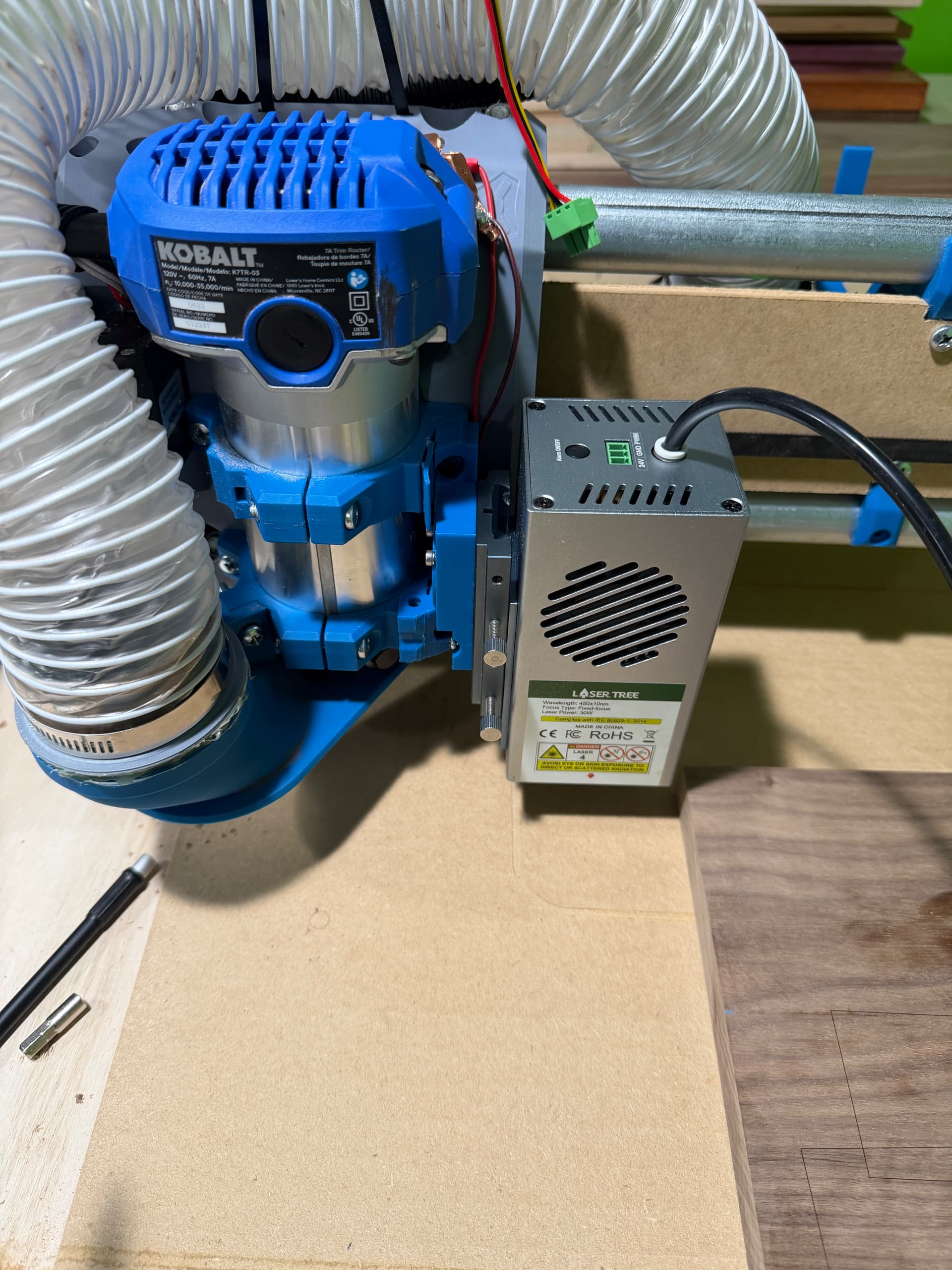

Thanks everyone! I ended up taking inspiration from @Dreyfus and making my own . It definitely needs some refinement before posting but definitely works
Sorry for the late reply - I was working away from home and about to login in to fusion to download it for you and see you’ve already made your own, nice job :smiley:
