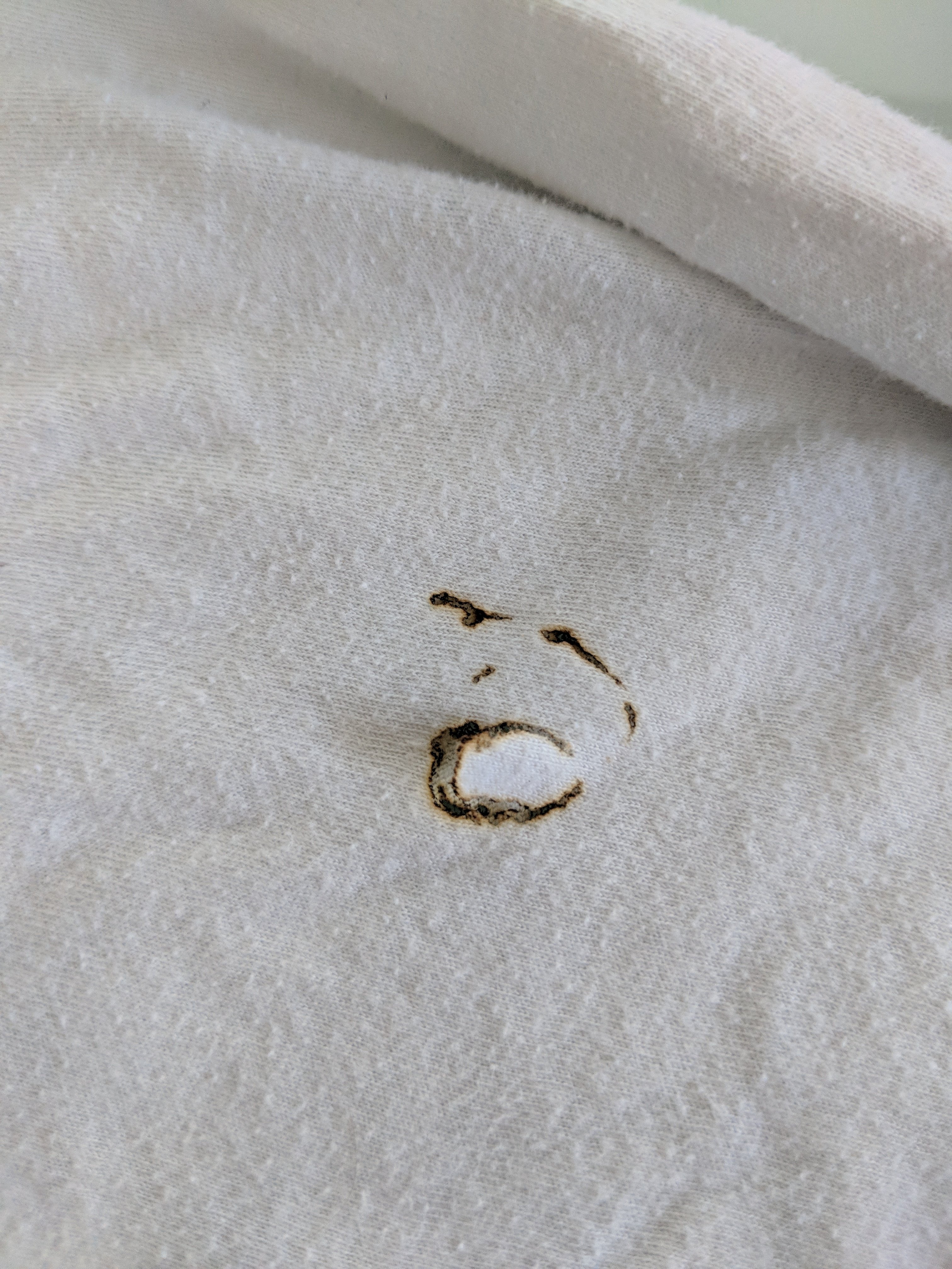

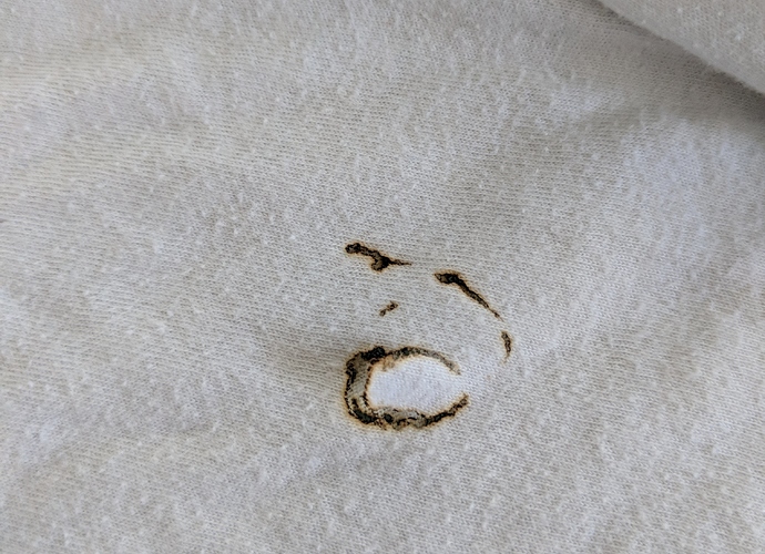

I really do not think it would take much power. I have a 2.8w and never usually use it past 50% and it really gets into the wood.
As a quick test I plugged it straight into the power at 100%. The is a cotton 60% poly 40% blend went right through even with no focus.
[attachment file=58383]
