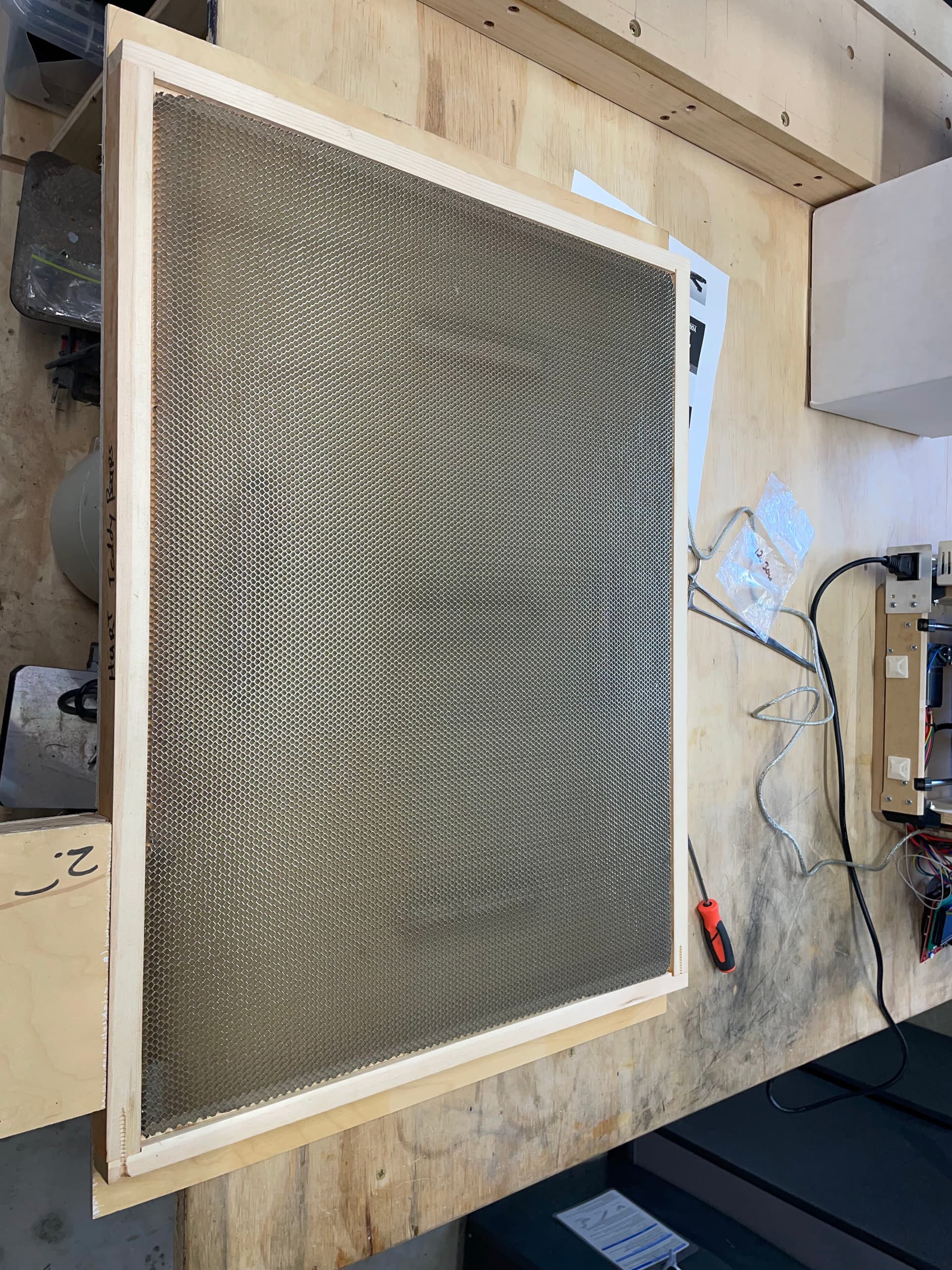

All,
Here’s some pictures of my (unfinished) laser bed.
This is the open area below the honeycomb. It’s a little bit more than 1/2 inch, the blocks in the middle are for center area support and after gluing down will have aluminum foil wrapped over the top.
This is the exhaust fitting, a Kirby vacuum piece. I’ll have a hose going to an exhaust fan to the outside. It’s designed to hang over the edge of the table .
I plan to put a bead of silicone caulk around the edge and a spot on each center support block, then drop the honeycomb into place. It should look like this when it’s done.
I’m open for any additional ideas or concerns about the build.
Mike
That looks like a great idea and should work very well. It’s definitely inspiration for my next steps, and I love the kirby attachment. I may hook up my low pressure blower to something like this.
Ideas… maybe some bent pieces of thin aluminum bar stock or bits of angle stock to replace the bits of mdf under the plate. The mdf blocks some cells from ventilation vs something with a sharper edge like bent thin alum bar or angle stock. At first I thought just miter cut the edge of the mdf strips, but that may not last long.
I imagine using something like a sheet of plastic to cover the unused parts of the grid would improve suction on the work piece. You might even see an improvement in the effectiveness of your air assist if you get lots of vacuum under the part.
Even without suction, it’s possible for flames to erupt under the grid. I worry with the suction you may not be able to see it before matters start getting worse. Making one of the sides transparent, and lining up the supports so the far side is visible would improve your chances of catching a flare up early. Plexiglass would work for that I think. Along the same lines, a temp probe placed at the intake of the suction could help make things safer… could program either marlin or a side arduino board to hit the kill switch if there is an abnormal jump in the intake temp.
