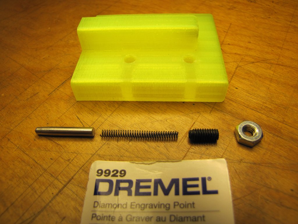

I’ve seen a few engraving bits that have a spring or something of the sort inside to compensate for uneven surfaces. When I say flexing, I really mean that the sheet is just bowed up in the center. Our smaller plates (5" x 7") do fine, but you can really tell the difference for our larger plates (6" x 10"). The ink is pretty thin, so I assume that the reduced rigidity of a tool like that wouldn’t matter that much. I’m really just looking for something that would be a cheap, quick-ish fix. I’m going to Harbor Freight this afternoon to pick up a set of metal stamps to check how they would look on the plates. If the boss likes them, that may be the easiest route.

At the bottom of the page linked below, I show a spring loaded diamond bit I use for drag engraving acrylic. Cost ~$12 - most of it the Dremel diamond bit itself. This , or some variant of it, might suit your purpose.
