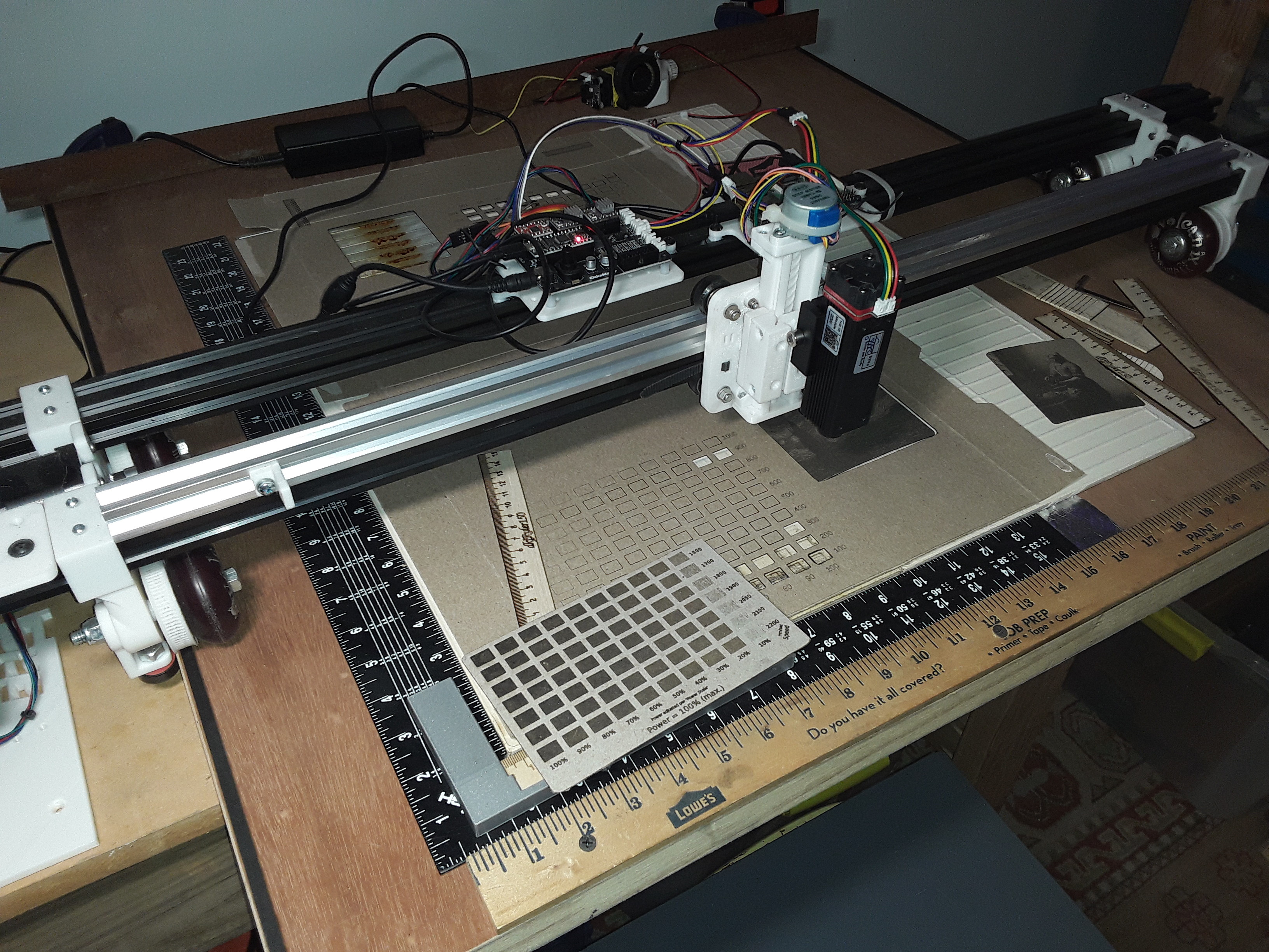

I’ve currently got that laser module running on my rolling-gantry FoamRipper2 machine. I’m not overly impressed with it – I can do pretty much the same job with my 2.5W Eleksmaker/Banggood units – but it does work. I do like the form factor and the build quality seems pretty good…

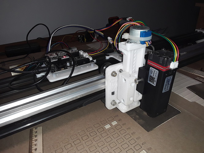

Unfortunately I can’t be of help with the SKR hookup (I don’t have one…) and I use/prefer Grbl 1.1h for my laser control. However, the 2nd photo above shows the laser module wiring (see CAUTION below). There are 4 wires… but the green one (a temperature pin) is unused. The red and black wires are +12V and GND respectively… and the yellow is the PWM control for intensity. Here I’ve used simple +5V PWM from the Eleksmaker 3-axis board in the background which provides a very convenient 3-pin port for the laser power and PWM.
CAUTION: I found the supplied laser cable color coding bass-ackward (left-to-right vs right-to-left) on the unit I received. In the photos above, I have re-ordered the wires to use a more conventional red and black for +POWER and GND, respectively… yellow for PWM, and green for TEMPERATURE/C. While the wires don’t really care what color they are… it might well confuse you if you aren’t sure of what wire is carrying what… :astonished:
For your case, I’d connect the red and black wires to the same +12V that powers your SKR board and the yellow PWM intensity control to the M106/M107 controlled FAN pin… either remapped to a +5V PWM pin, or – if you’re courageous! – directly to the +12V FAN control pins. [If it were me, I’d remap it to a +5V PWM pin.] Chances are the +12V FAN pins are low-side (GND) switched (giving an inverted PWM output) and you’ll be testing the truthfulness of the laser vendor’s spec on the 3.3V-12V PWM control input.

No, the little Neje interface board isn’t necessary. You can go straight from the controller to the laser module… you just need +12V, GND, and the PWM signal and all are available on the controller.
