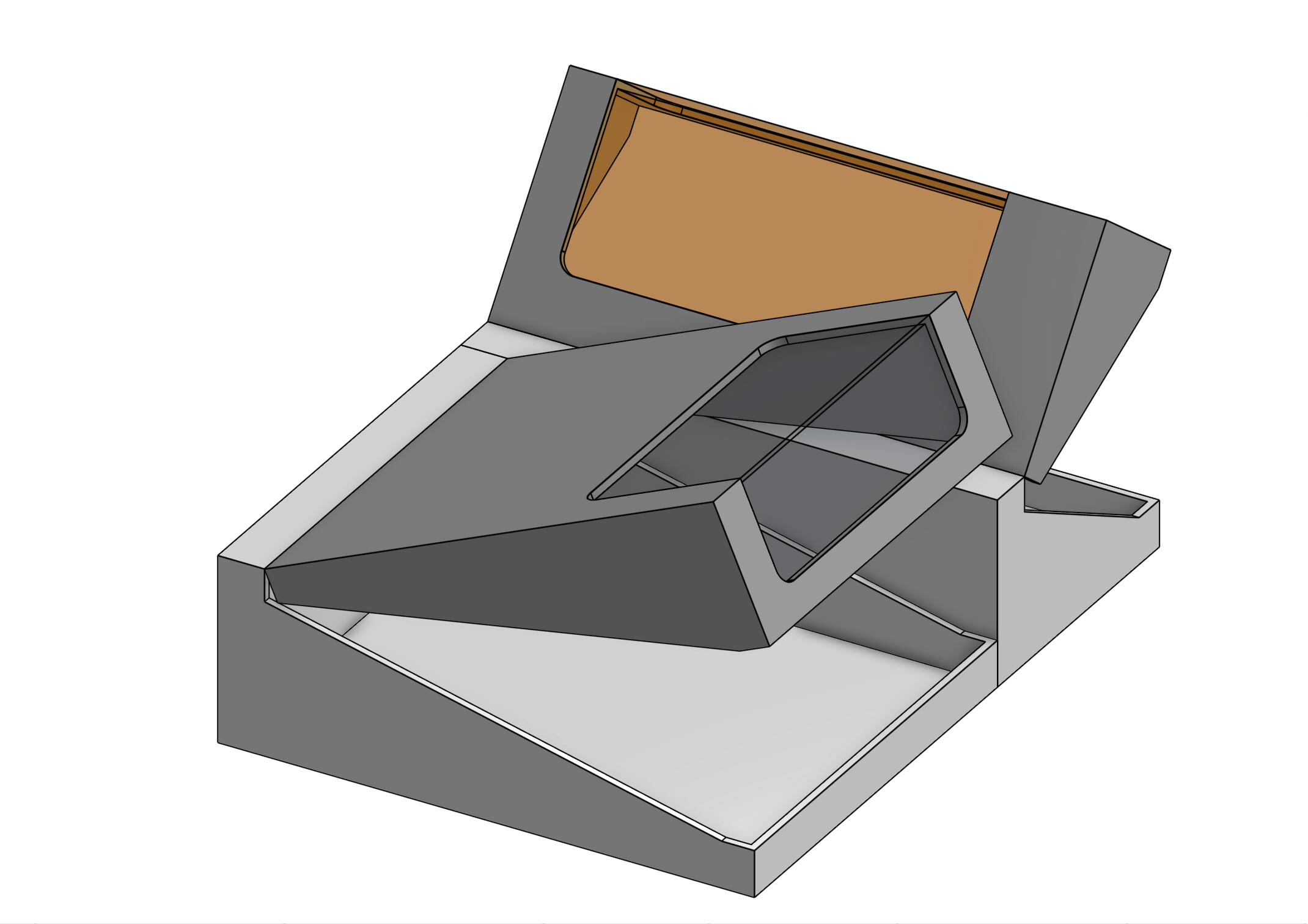

I’ve come a long way. The wood cutting is progressing. Have got a real good feel for Fusion and using it for modeling and CAM. Bought the LaserTree 20w Pro and goggles but now think an enclosure makes sense. I build the Lowrider to cut max 24” x 36”. Would appreciate some ideas. Thanks

Enclosure is way safer than glasses especially if you have pets or family randomly walking or the room
The simplest enclosure is a box. I have some orange acrylic that is supposed to be “laser safe” but I don’t trust it - real certified stuff is the cost of a small house and there must be a reason for that.
Here’s my current design (the two boxes are independent of each other) which hopefully I’ll get to producing them November-ish- the window is bent but could be in either the top or bottom or both. I have a camera for the laser, and will probably do the same for MillMage when I get set up.
Note there are two boxes - one for the lowrider and one for the laser - but the concept should be clear enough.
I’ll use cupboard gas struts on the lid (or a stick - I haven’t made up my mind)
I will make it a bit more complicated than needs be to make it lighter - so I’ll frame each panel with 50mm x 8mm MDF and skin with 3mm, however it could easily be made from 12mm solid or any other size.
