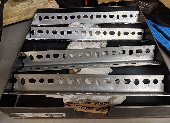

Downdraft table coming together

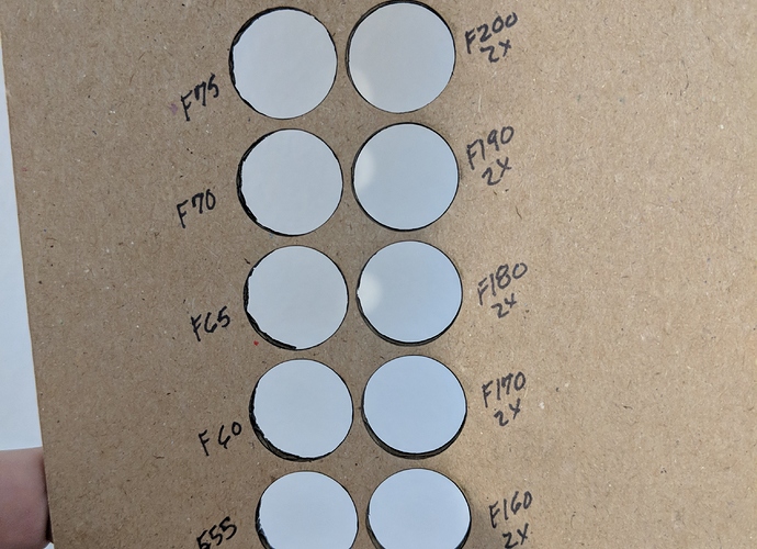

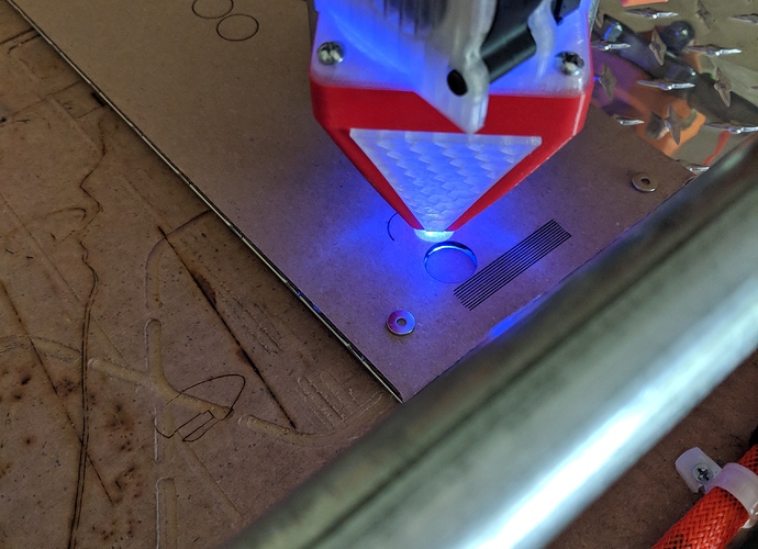

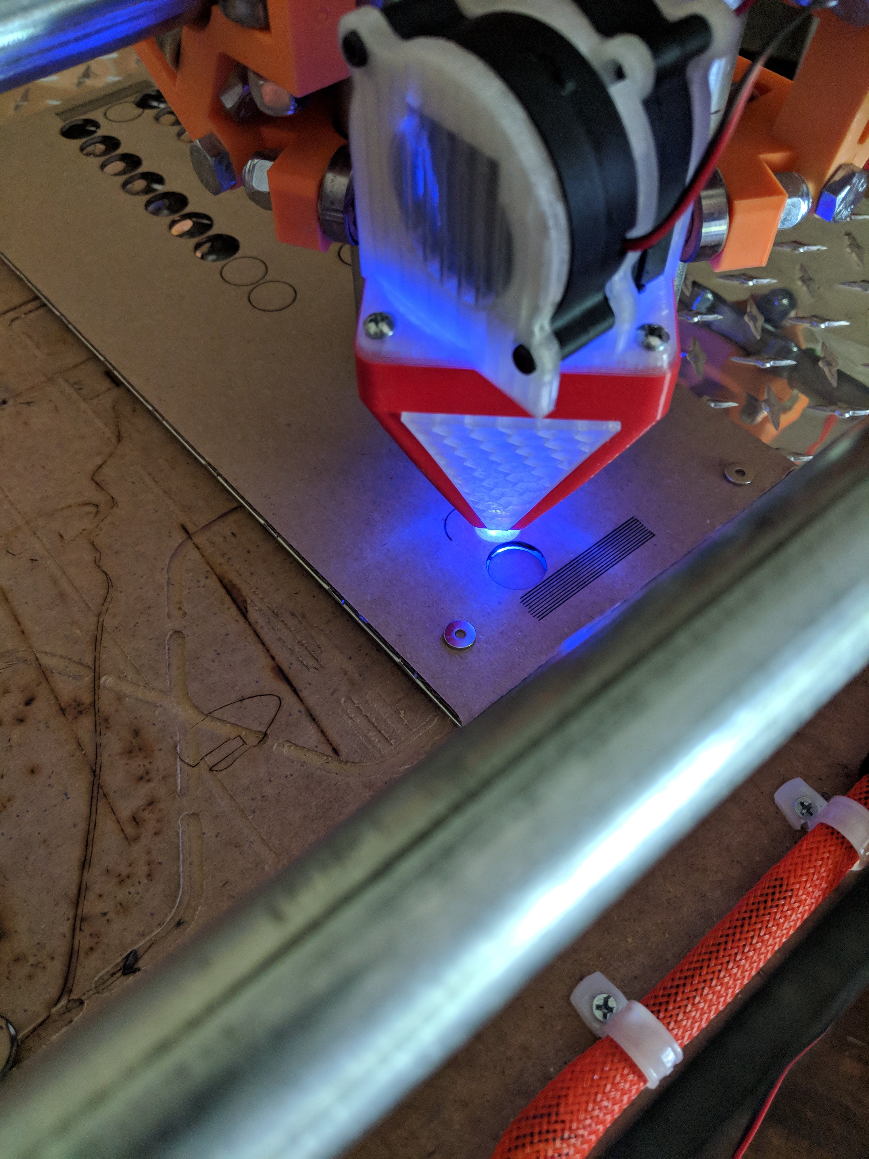

Meanwhile, 2 squirrel cage fans on my 2.8w laser @ 1.5A, F180, in 2 passes. This is just the fans, without any air assist from underneath or from the side.
[attachment file=69670]
More test circles
Much better so far!

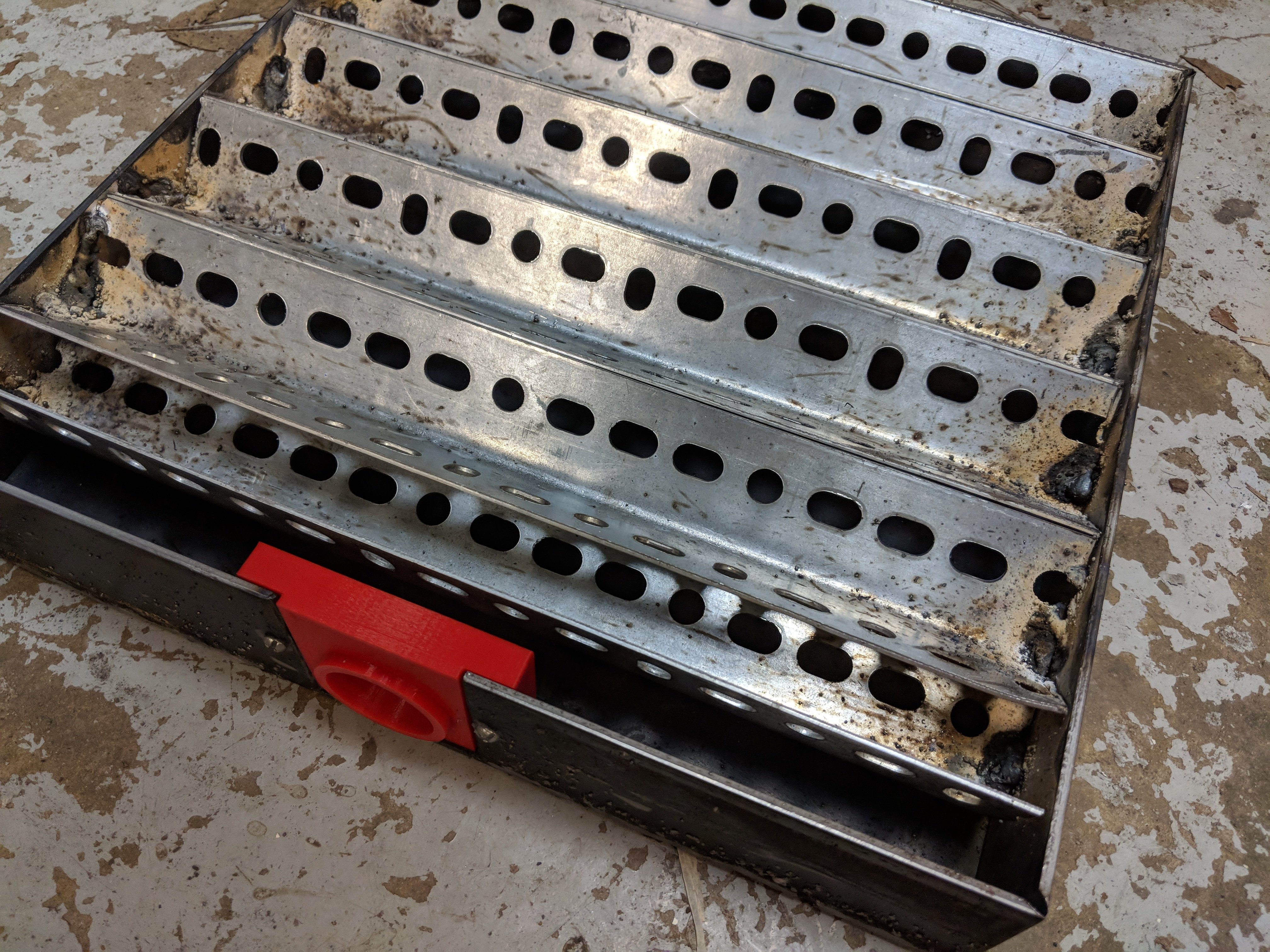

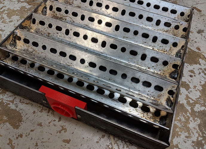

Welded up
[attachment file=69992]

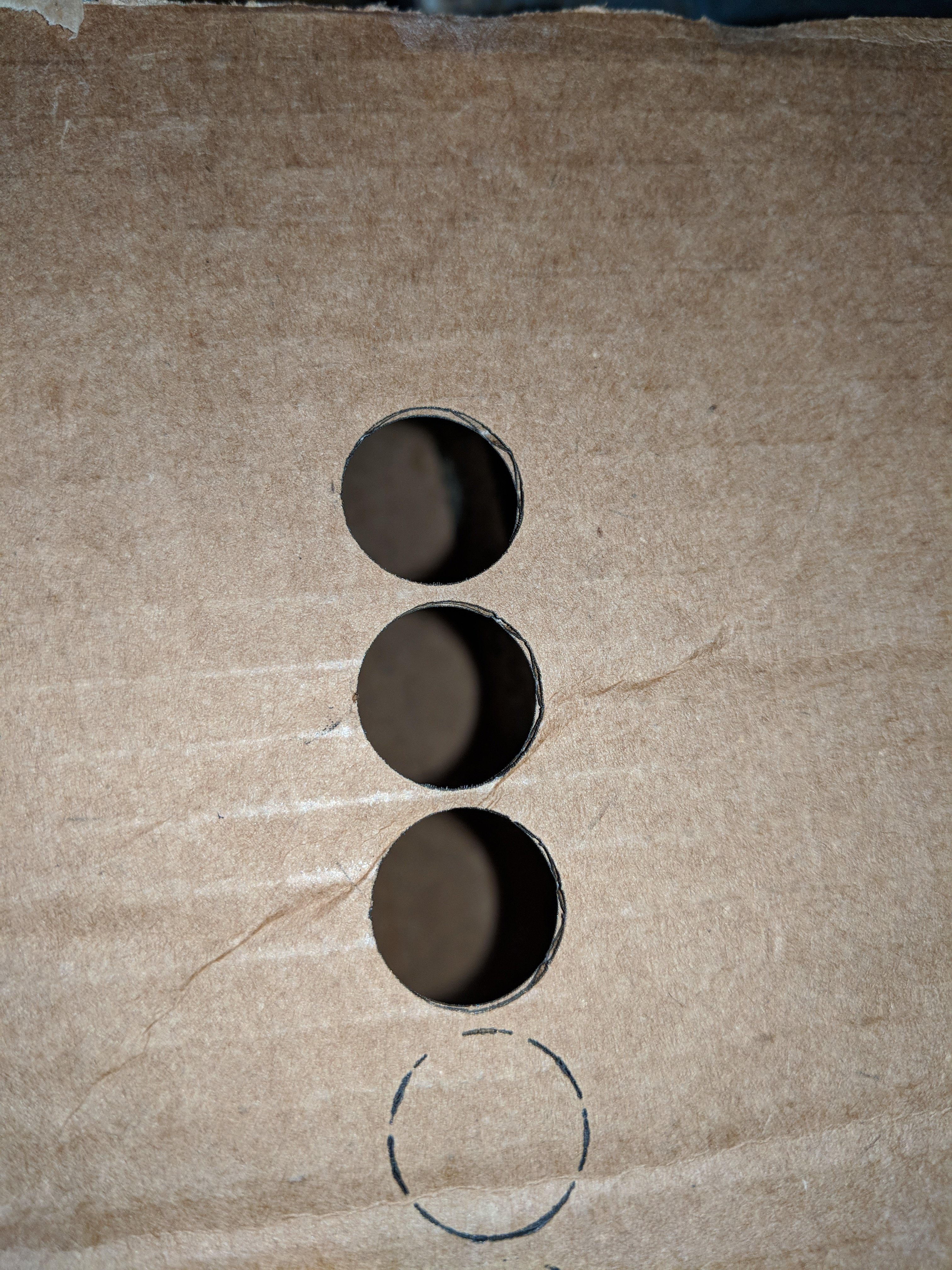

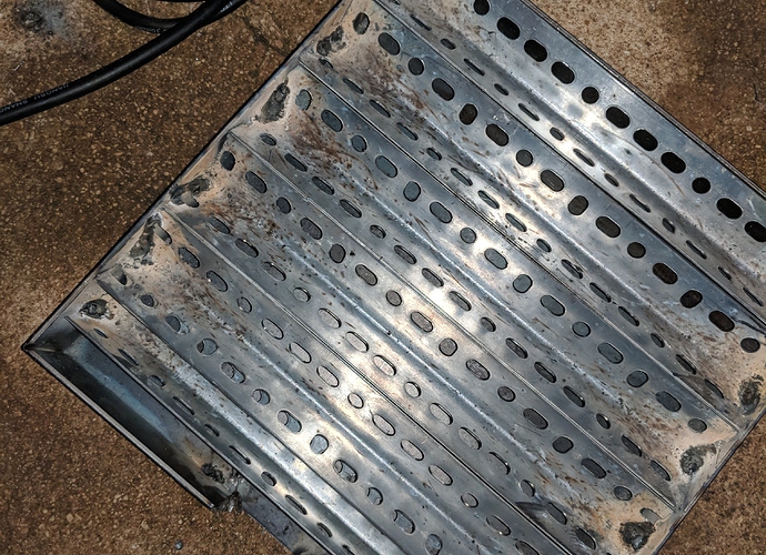

Without any sealant, the cardboard really sucks down flat to this thing. I have to leave a gap to make sure I don’t burn up the shop vac.

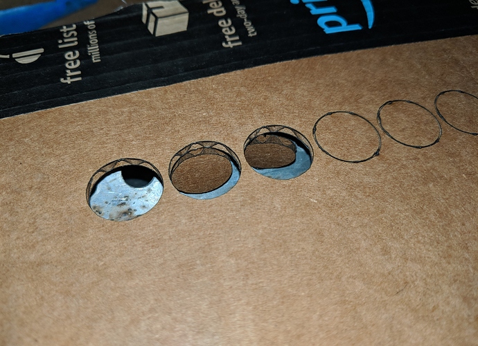

[attachment file=70248]
Top:
[attachment file=70249]
Bottom:
[attachment file=70250]

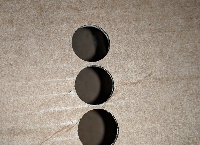

F50, F55, and F60 all cut cleanly, which is about 20 mm / min slower than before, but it doesn’t burn at all.
This is a used, beat up Amazon box. A fresh, uncrushed moving box might even cut a little better.
That still seems really slow, but if it works who cares!
Yeah. I don’t really understand why it’s so darn slow.
Without any additional changes, I was able to cut through cleanly at F85 on a Home Depot brand moving box. Those Amazon boxes are just tougher!

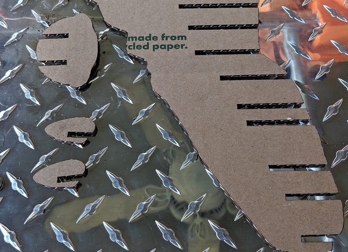

This is the first of many projects I’ll be making in cardboard:
