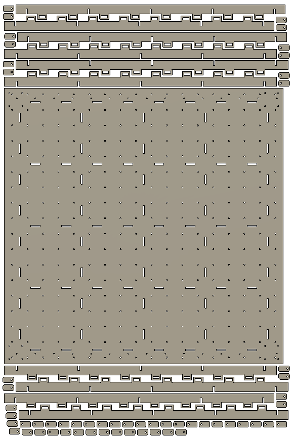

i want to make table for 600x600mm MPCNC 25mm verison from laser cutted steel 5mm thick with braces.
Im having some problems to find right dimensions of holes for feets.
Table size: 870 X and 879 Y

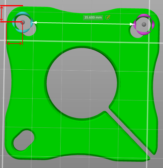

If i import stl file to fusion360 it mess up the scale of feet…
Can any one provide me with drawing or dimensions of feet holes ?
If i mesure it in slicer i get 35.6mm between holes, is this correct ?
And i need the dimension to the corner of table, can any one help please ?
Im getting 5.532mm in slicer which seems not correct.
Thank you.

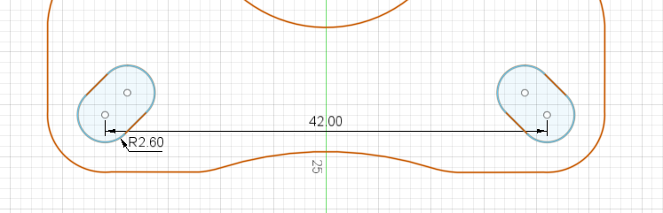

When I do things like this in Fusion 360, I import the mesh, then, in the Mesh workspace under Create, I used Create Mesh Selection Sketch. When creating this sketch, I’ll pick a point where fillets and chamfers are not caught. For example, for the feet I’ll move up about 5mm, so all I get is the outside outline and the slots.
Next, I edit the sketch and either use 1) Create/Fit Curves to Mesh Selection, or 2) just redraw the geometry using the Mesh Selection Sketch as a reference. For the feet for the 25mm Primo I get the following:
That means the measurement between the arcs of the outer circles of the slots (which you label in your drawing above) is 36.8mm.
Oh, and the slots were symmetric around the center point of the center hole.
Edit: You didn’t ask for it, but the outside dimension of the feet is 53mm.

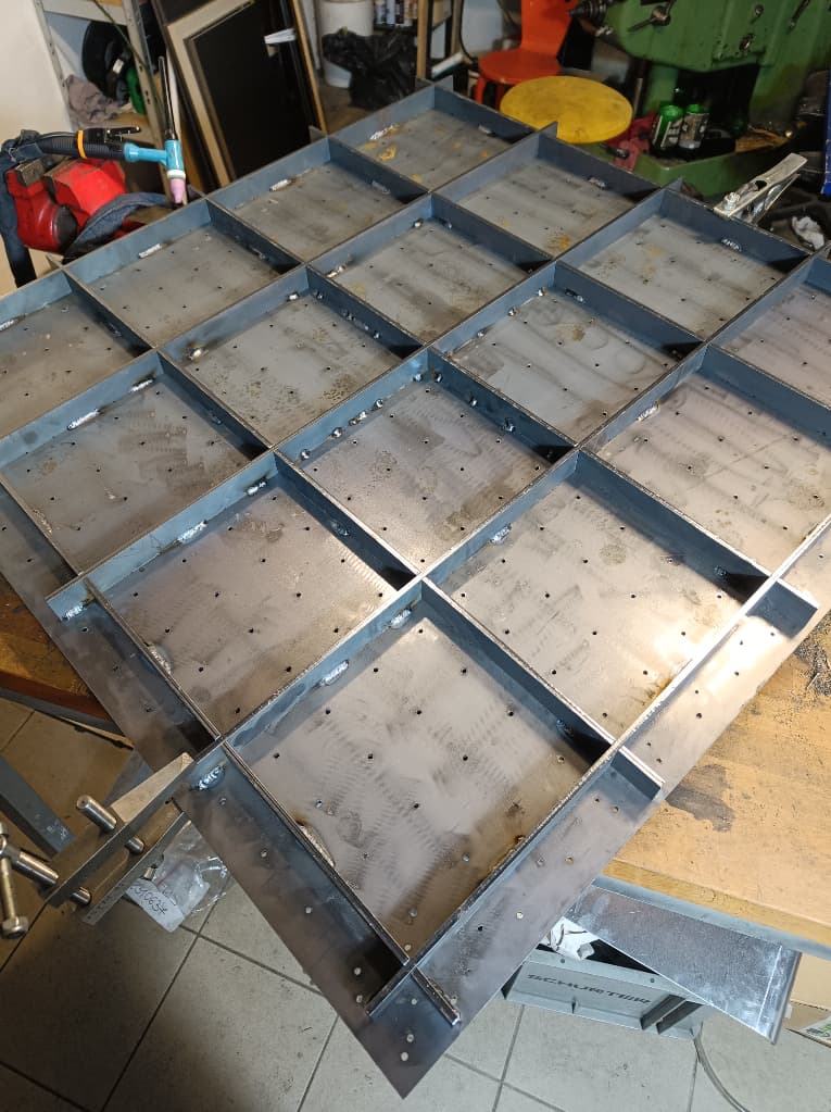

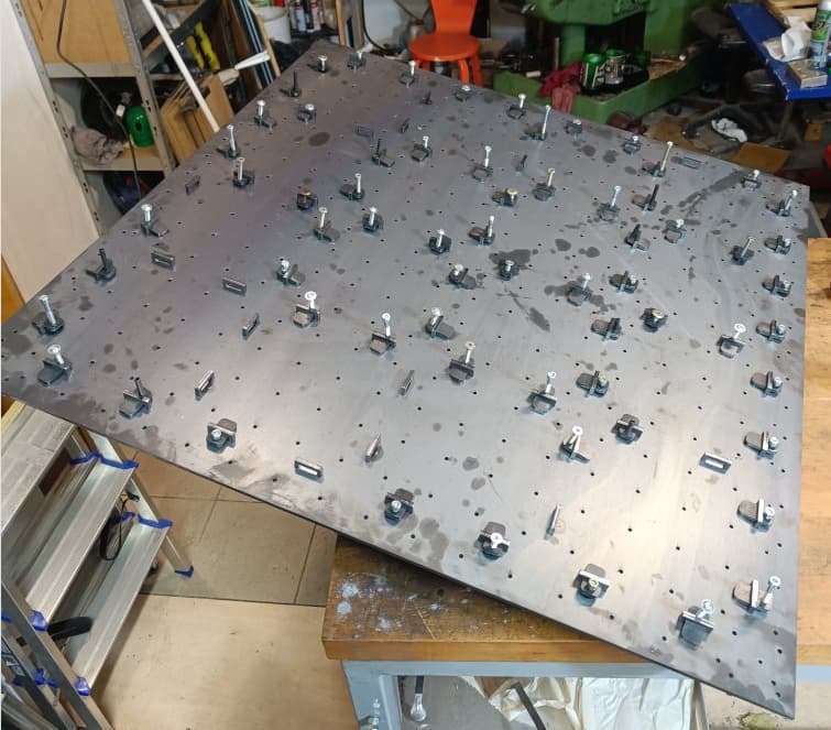

So little update :slight_smile: table is done.
I already have MPCNC almost completely assembled (only waiting for belt pulleys), but dont have photo right now.
Weight of table is approx 42kg and its made from 5mm steel.
That is pretty amazing!
