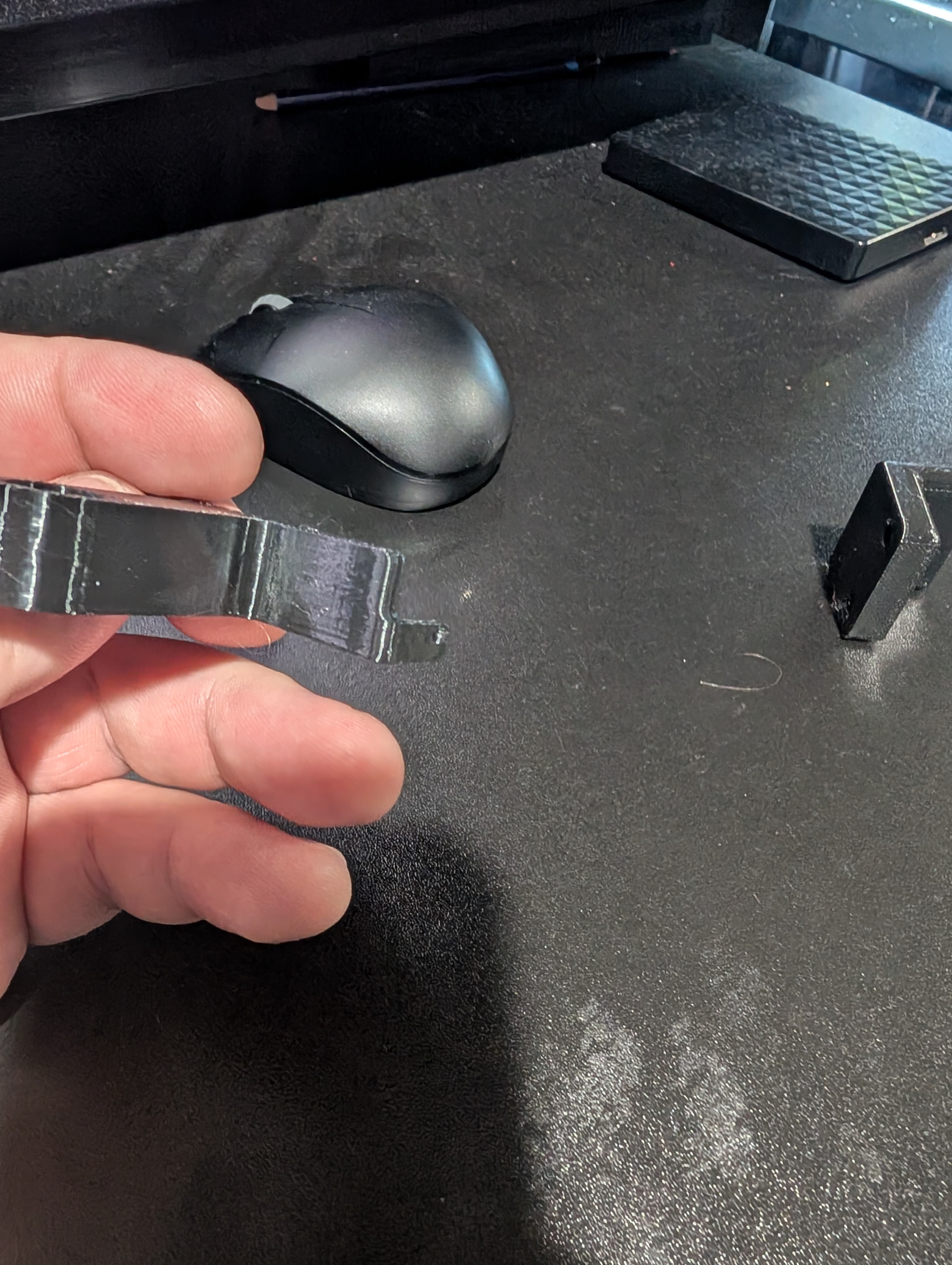

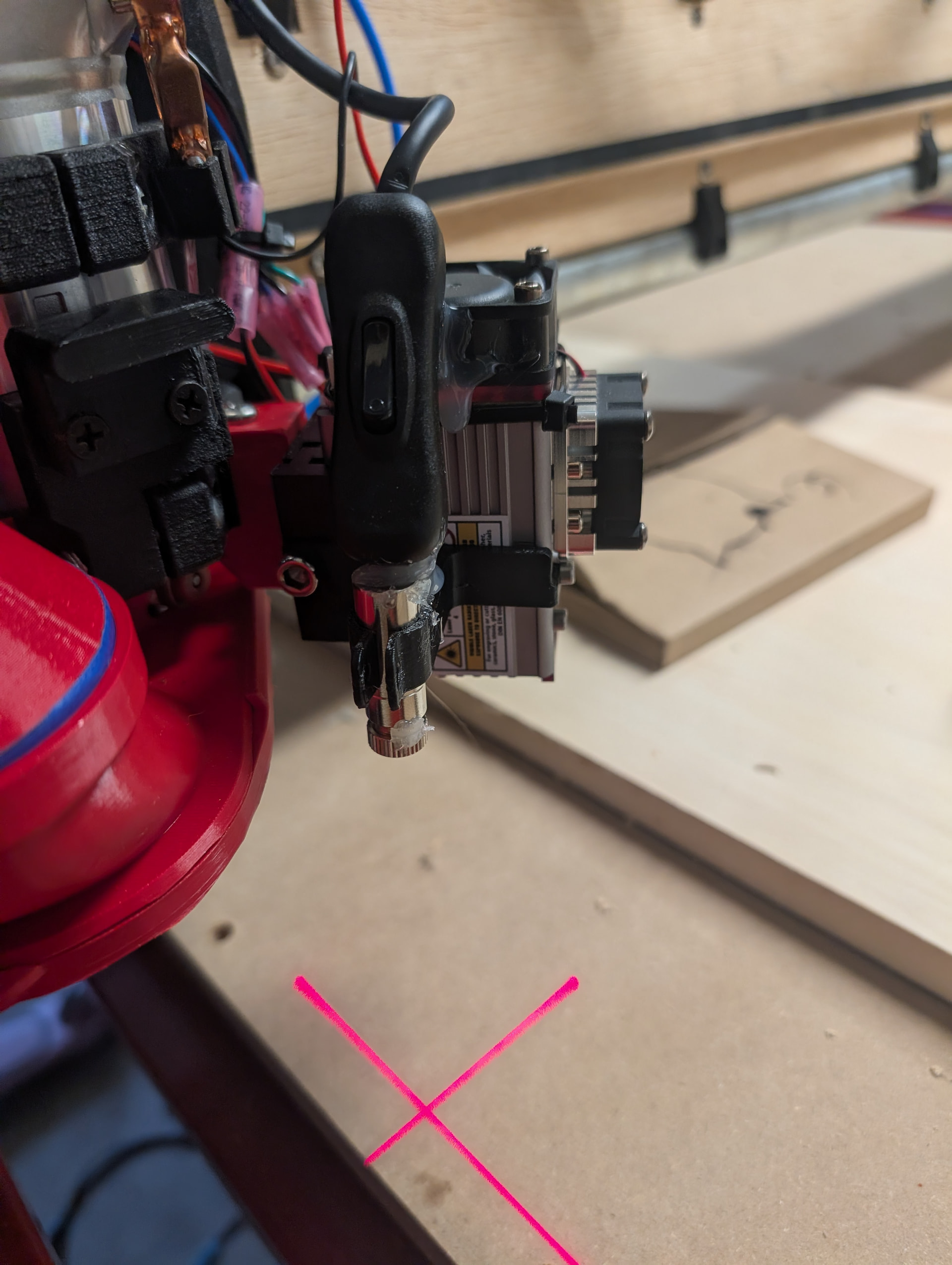

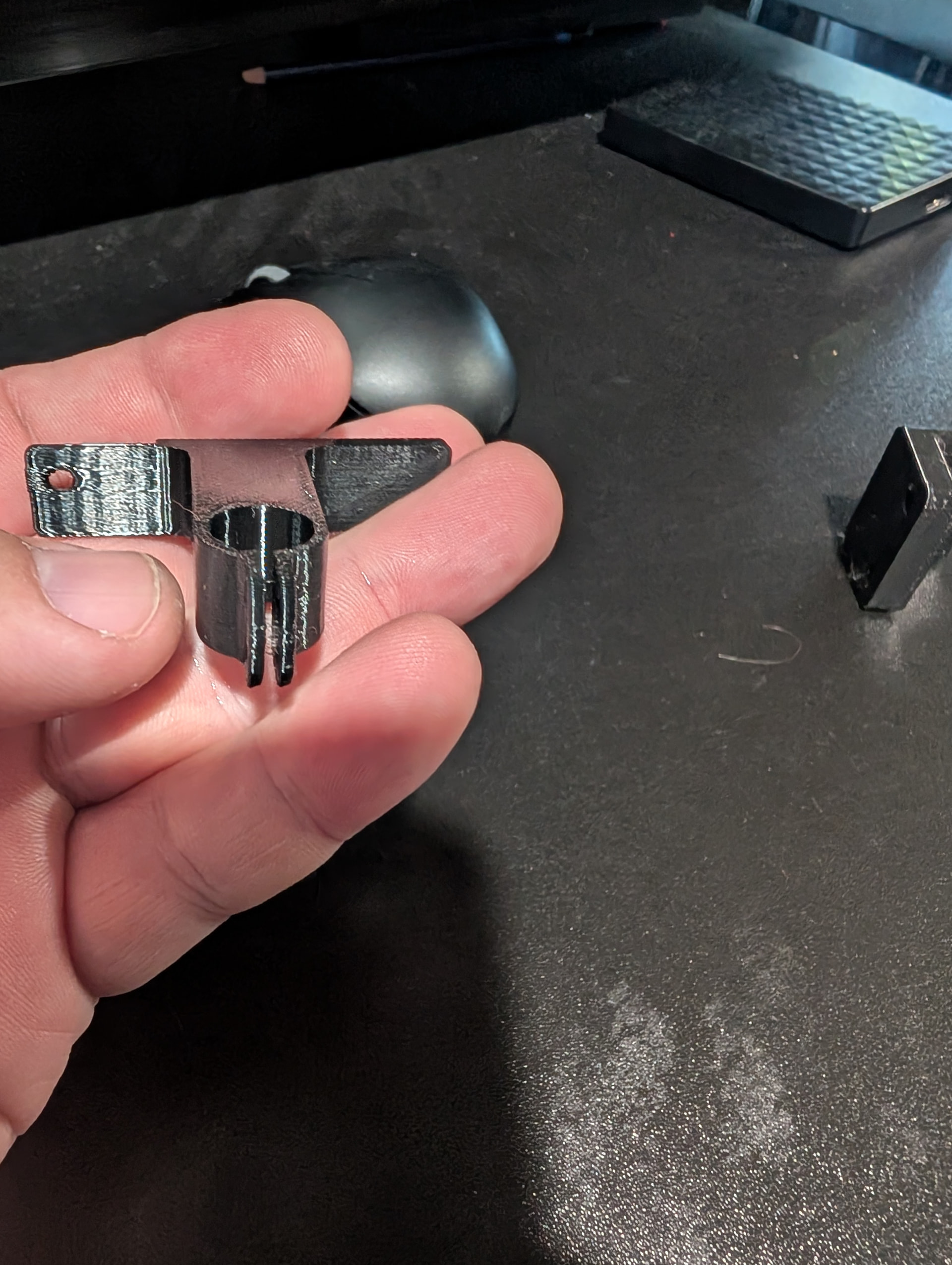

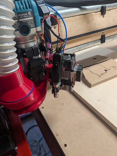

I designed and 3d printed holder for laser cross hair that will help locate corner of the material and then using macro router will move tho the same spot. part is.installed on laser.

I took my idea from this video, https://www.youtube.com/watch?v=0BgHm7daDY0&list=PLoFLvlE8fuJW8SfWxZ-plQjTgZi5nN3PB&index=10 i could not do exactly the same because i have laser that is mounted to the machine all the time so I designed a bracket that is bolted onto the laser using existing screws. my laser is NEJE A40640 and laser i used is Amazon.com .
I was inspired by this to put together this remix for the Makita mount for the LR4 - clearly not super precise but good enough for a rough “set zero” set of steps: LowRider 4 Makita Mount Laser Pointer by RainyDayHiker | Download free STL model | Printables.com
