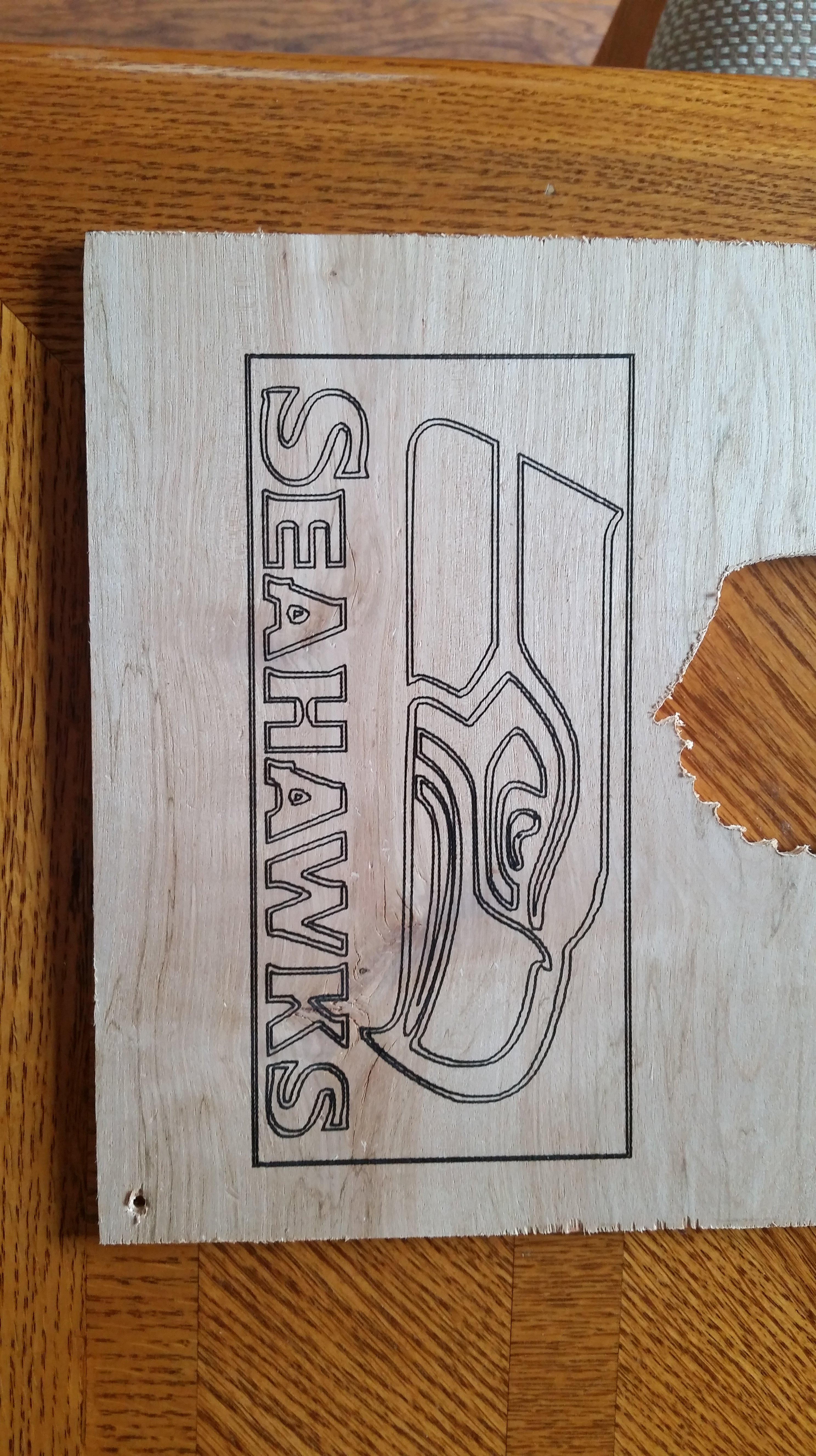

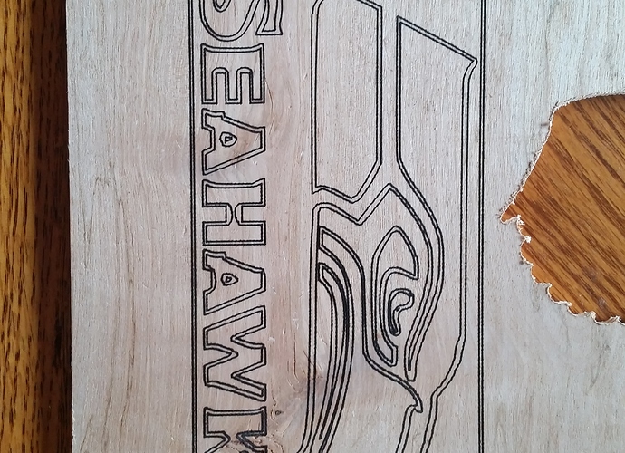

OK! I have the laser working! Here is an example of one of my first test runs.
[attachment file=59489]
I used Inkscape and the J Tech plugin to create the Gcode, which worked well for outline and text items, but seems to be limited to a single power setting for the drawing. I would like to play with some greyscale drawings / photos next. I got a copy of the MPCNC optimized Image2Gcode but the newest incarnation I can find appears to be about 2 years back (V1.0). is there a newer version of this or is there something better out there I should look at now? 2 years seems to be ancient history in this field!

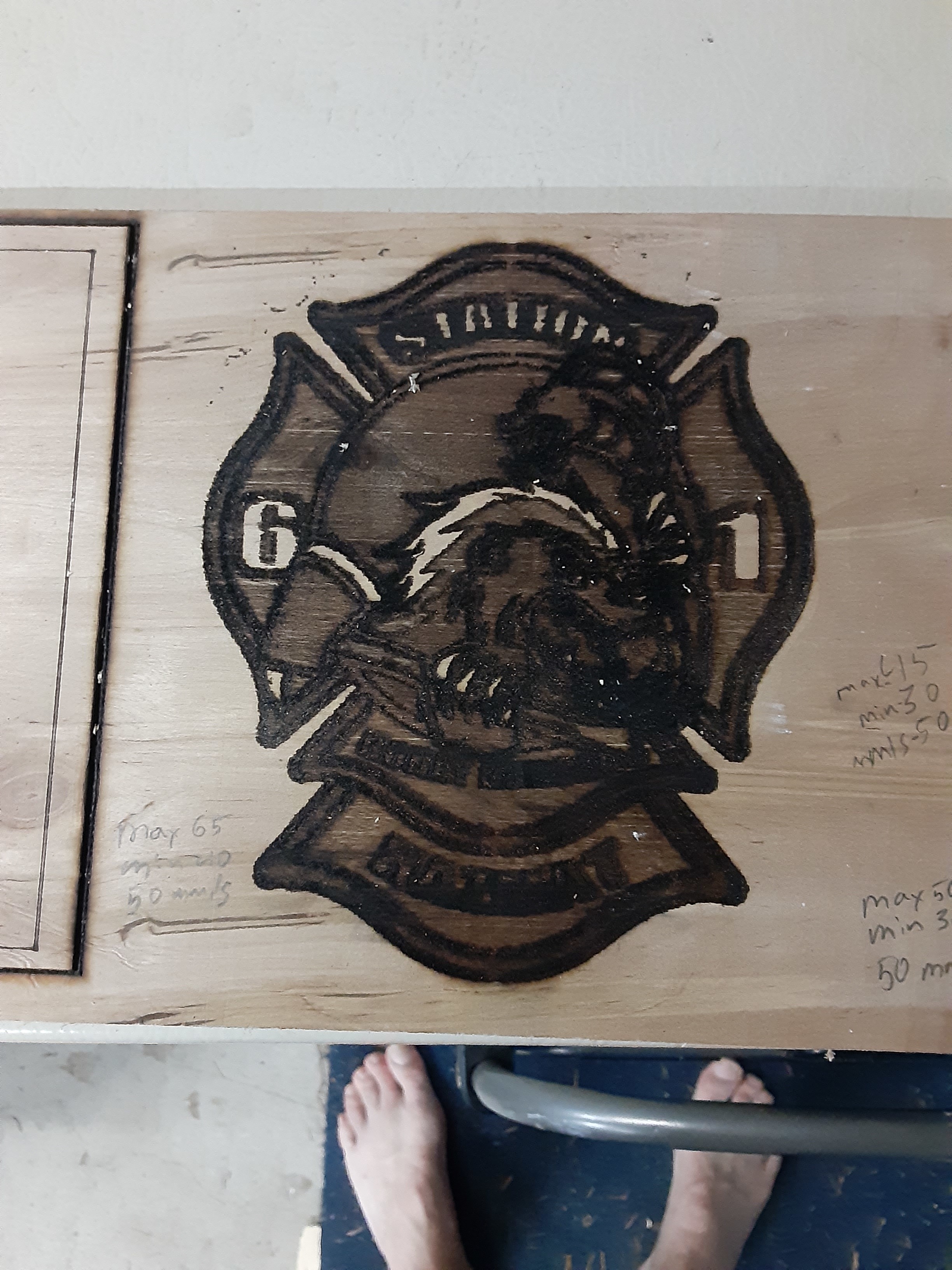

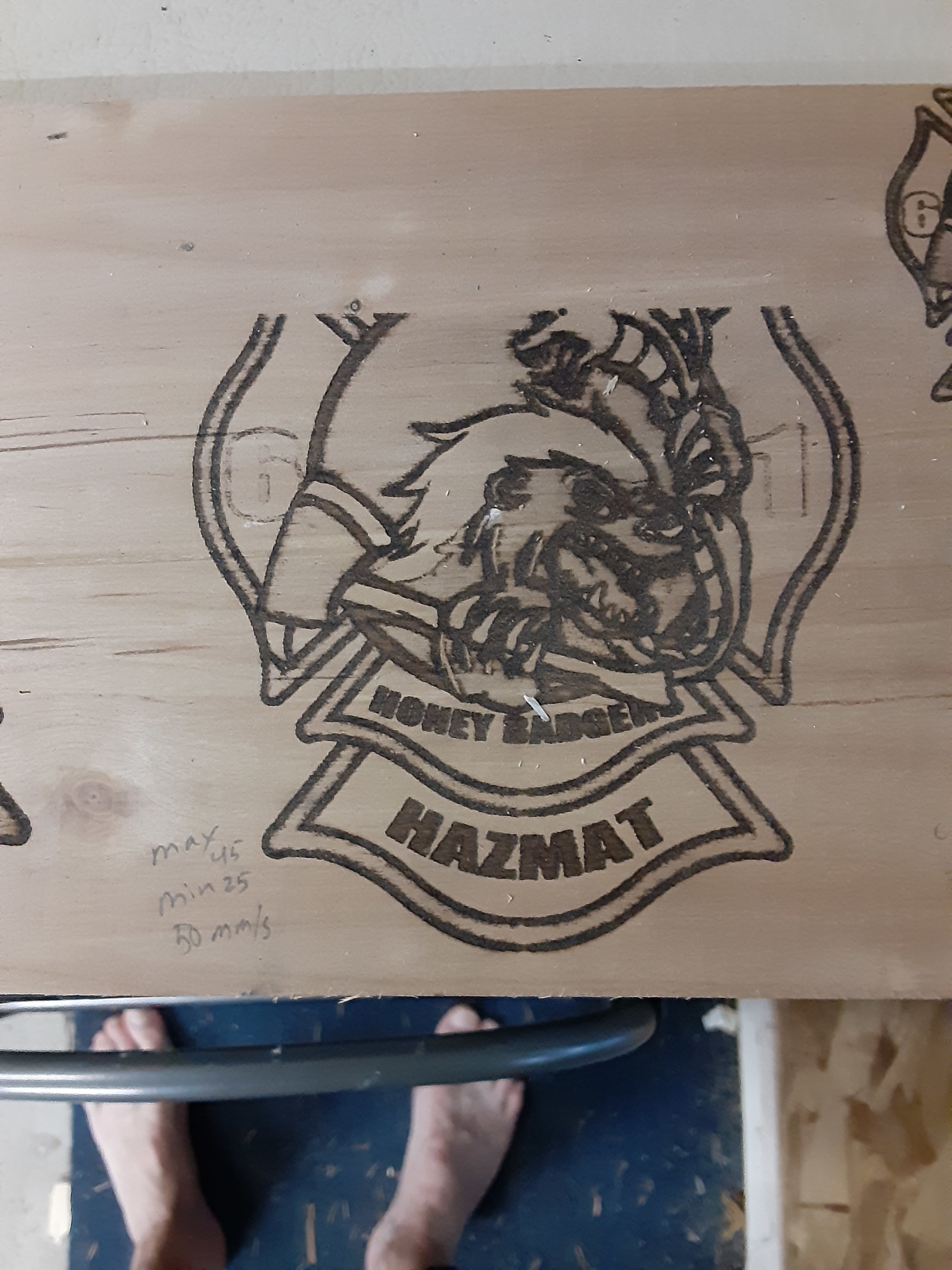

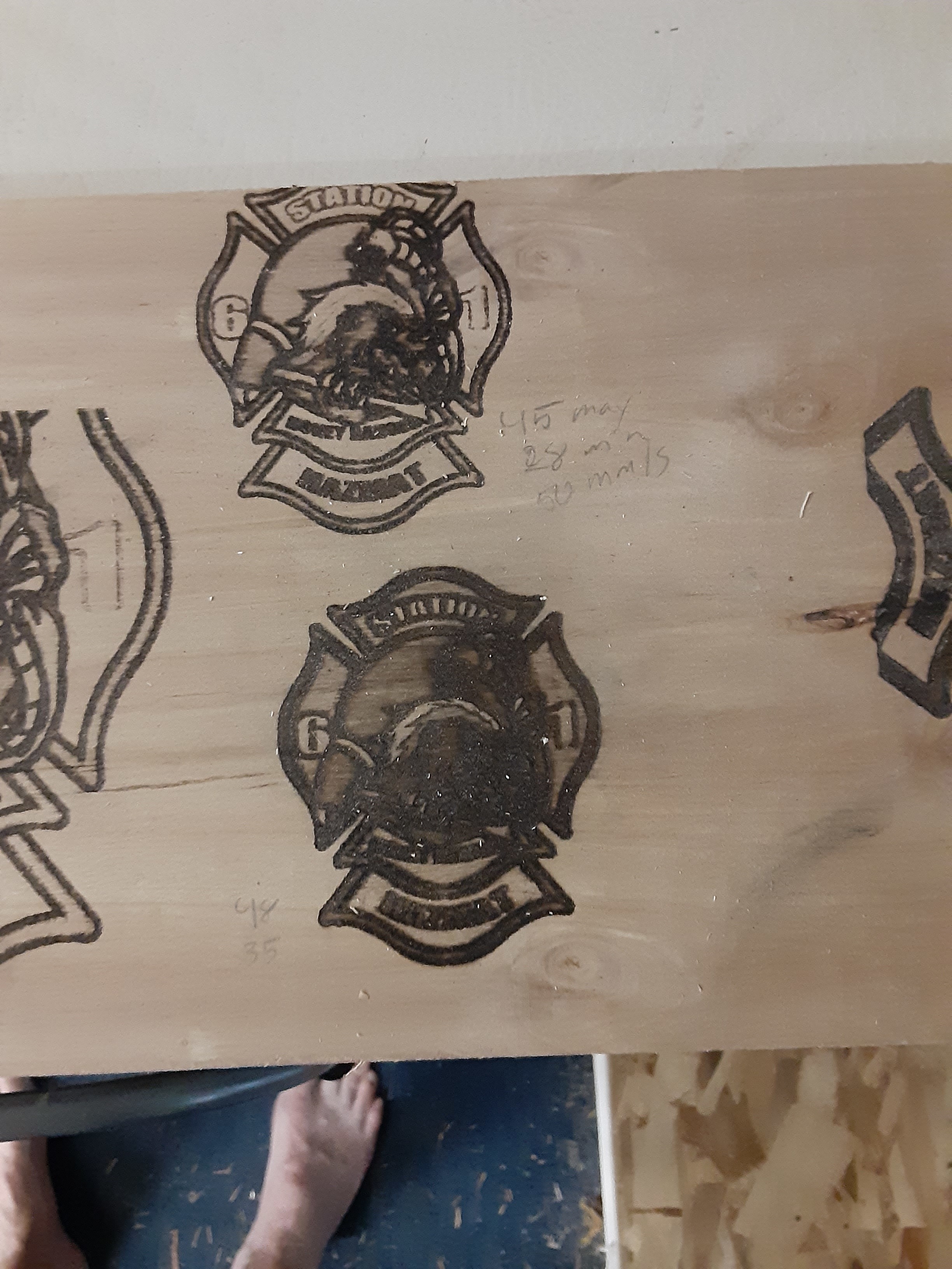

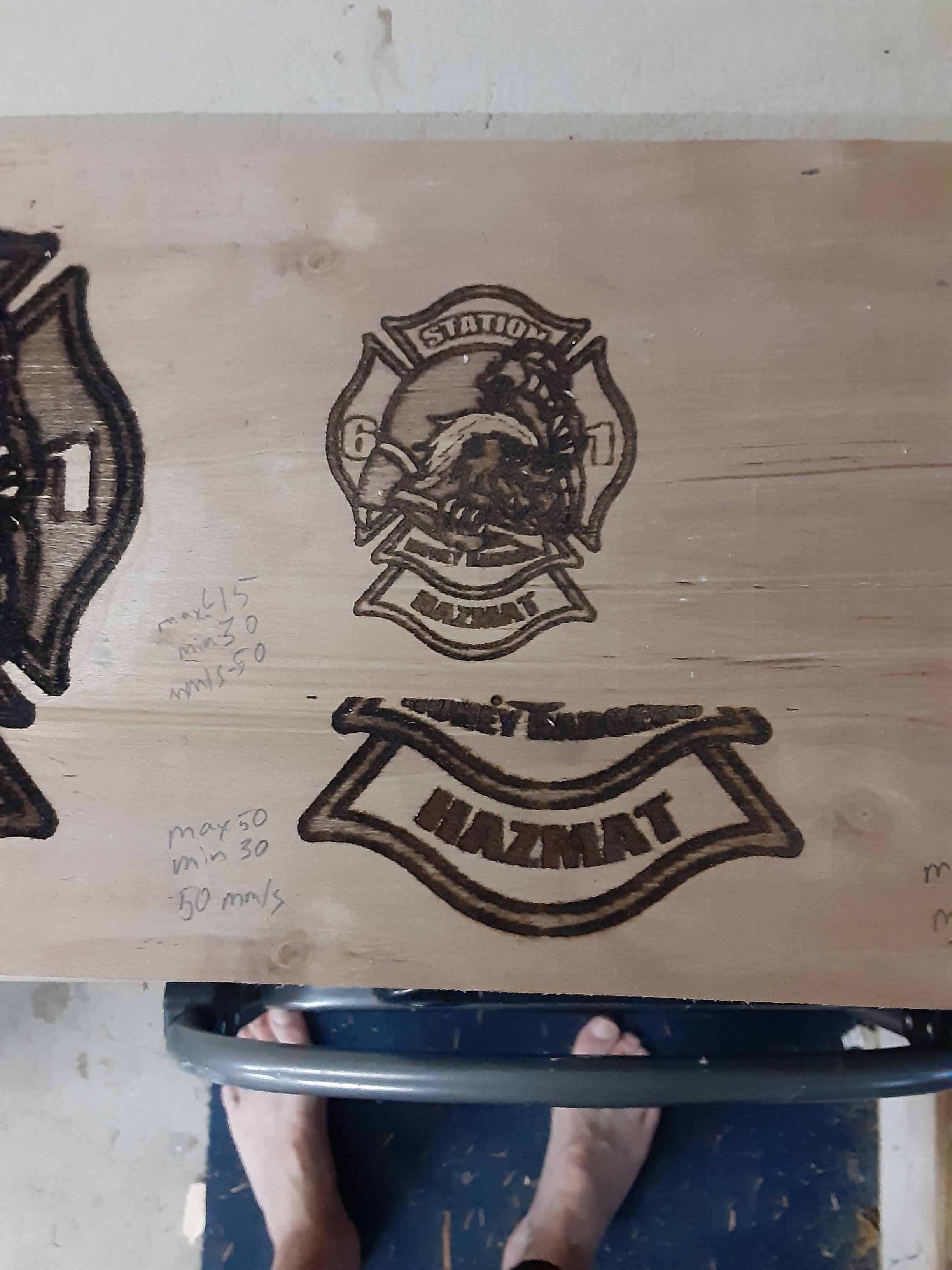

Greyscale takes a LOT of trial and error, adjusting the min and max power and the speed. small adjustments can make a big difference in the outcome. What I did was to print the same image multiple times using different settings, and experiment. I then refer back to those images to get the settings I want for a specific print. (photo examples below)
Note the written settings next to each image. Obviously, your laser is different from mine so your settings will vary, but it gives me a starting point as I set up a new job.
