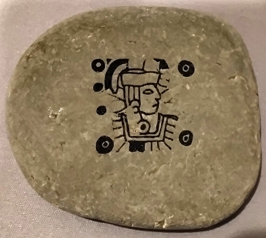

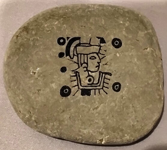

I’ve heard that lasers can engrave wood (like cutting boards, and coasters), as well as rock/stone, so I’d like to try that. Also would like to be able to engrave glass and metal water bottles.

And for rocks, this thread on the Lightburn forum is of interest:
