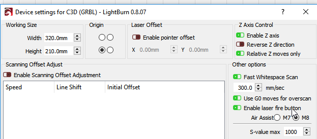

Have a look at this :
The frame buttons are in one of the panels in the bottom right. Probably a move panel or something like that. I haven’t opened it in a month or so, though, and that’s about all I can remember. I think it’s a button with either a square or blob made from a dashed line. One outlines the smallest rectangle that fits around your burn, the other follows the outermost contour.
For homing one axis, have you tried G28 X?
Thanks for all that info. Yes I tried g28 x and got no response. I do pretty much the same in repeater and no issues.
If you don’t find a solution by this afternoon, I’ll fire it up and see what I can see. Google shows a bunch of results for people getting axes backwards or trying to figure out endstops. I’m almost certain I did this on my last job, one axis at a time.
You are using capital letters in the gcode, yes?
To be honest not sure. I will try with capitals. That is good advice. I will post later today if that works. Thank you
I hose that all the time. Even sometimes when I try capitals on purpose and forget my caps lock is on.
