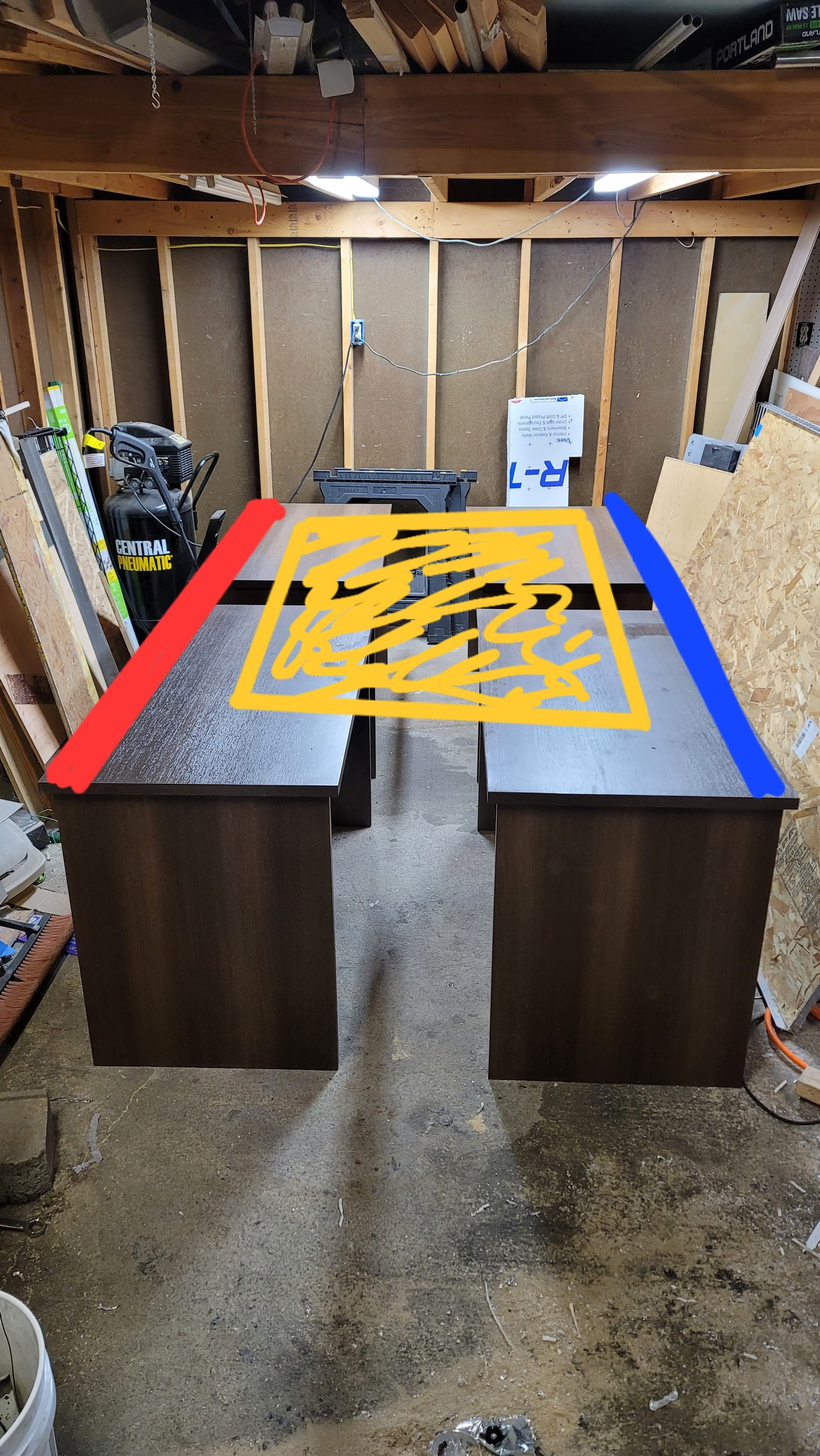

I have started the material gathering and printer for building the LR4, upgrading from a lr2. So work is remodeling one of our smaller boutique hotels(47 rooms). So I got 4 2’x4’ desks. I figure 12" between each desk so its 5’x9’ with an osb topper should be a good base.

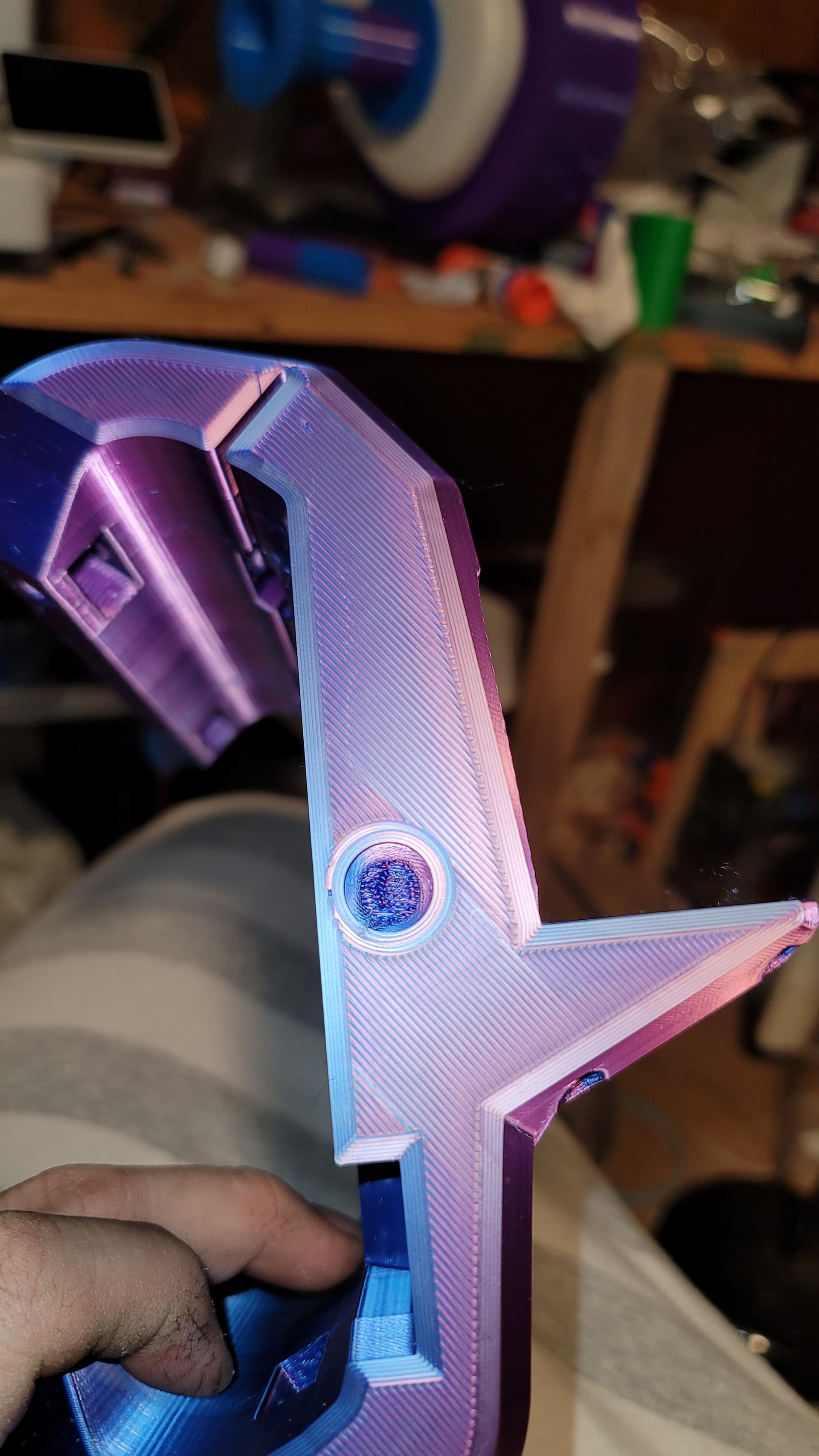

Just started printing the core, going to use some silk 2 tone PLA. Its gonna’ look prurdy
Only 19 more hours to go!
Silk and matte have been problematic in the past, so if you have problems later, you now know why. :slight_smile: There have been a lot of builds that did work with it, but just a heads-up. :slight_smile:
Well…on the plus side I did 6 walls thickness instead of 3.
And its only $17 if it fails.:disappointed:
I shall live on the optimistic side. Its will work perfectly. And like you said if my machine is problematic I will start at the core.(imagine in Liam Neeson voice)
That’s also not recommended… :stuck_out_tongue: Some of the walls/features don’t work too well with more walls. But it will all work out in the end. I printed 3 cores for the LR3 because my Prusa Mini was skewed… That’s life. :smiley:
Looks like I got a new decorative wall piece then.
No worries, as long as it works it’s fine. They are guidelines after all, not strict rules. :smiley: It looks absolutely stunning.

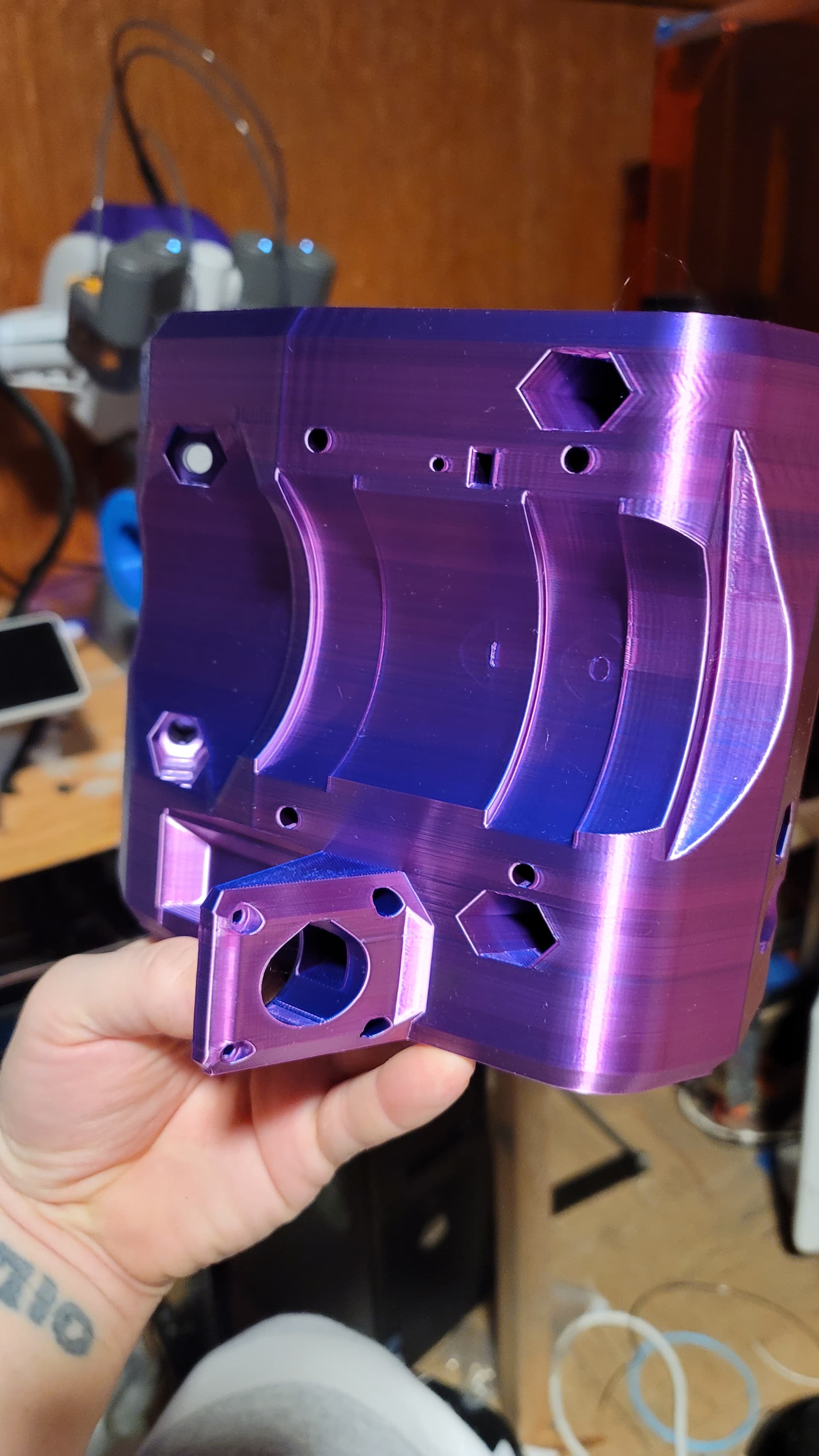

I really liked how this turned out. Hopefully it doesnt explode.

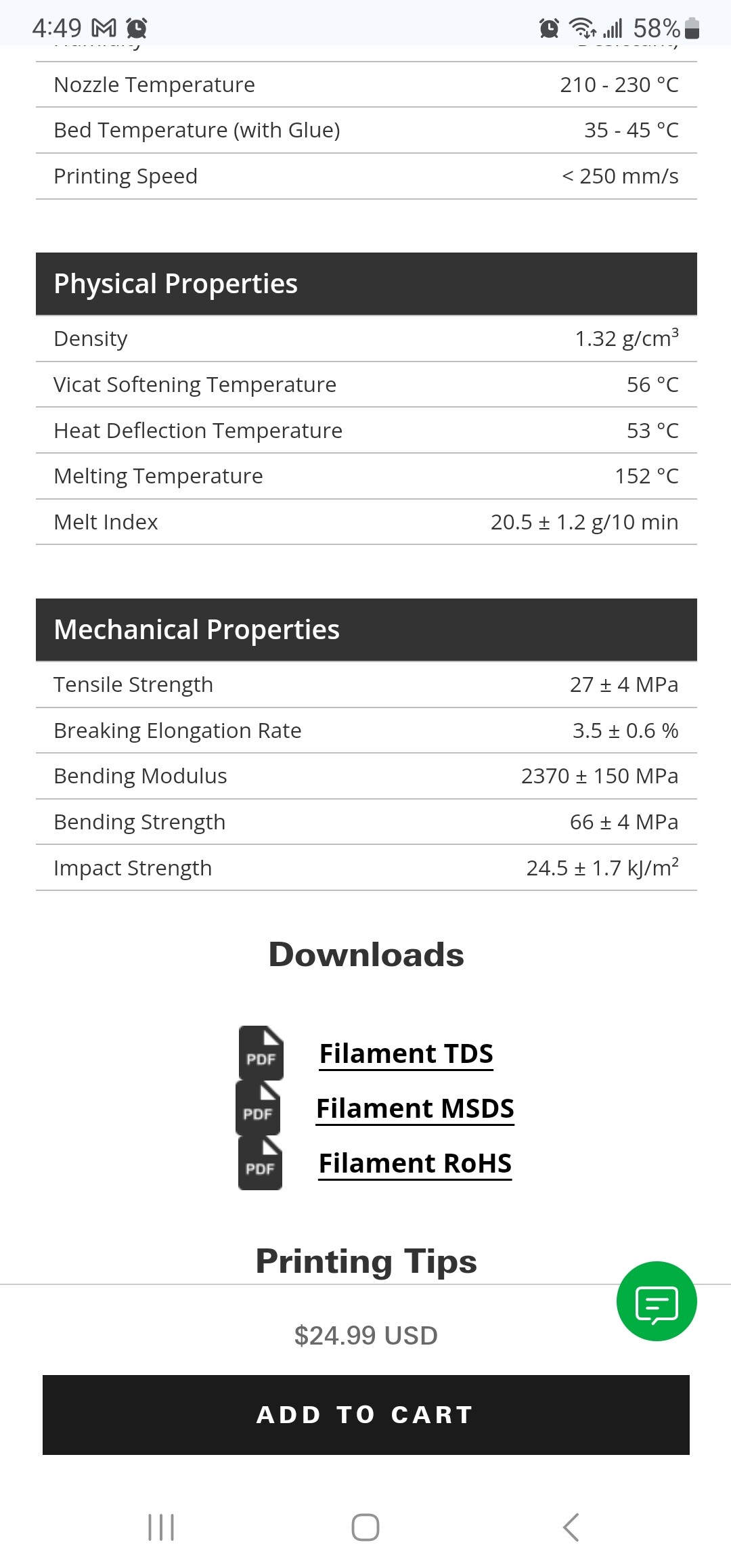

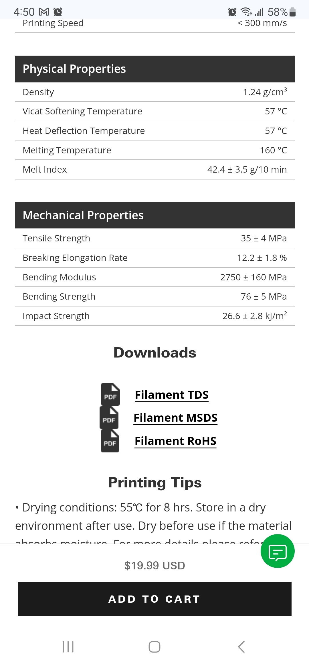

I did find the info on this filament vs the standard pla from bambu
I dont know what these numbers mean, but im hopefull
The color reminds me of bubblicious cotton candy gum
Go for it - removing the core is easy if you need to replace it anyway.
@diddledirt , nice looking print! My part failures with that type of material was poor layer adhesion, so hopefully you won’t have any issues.

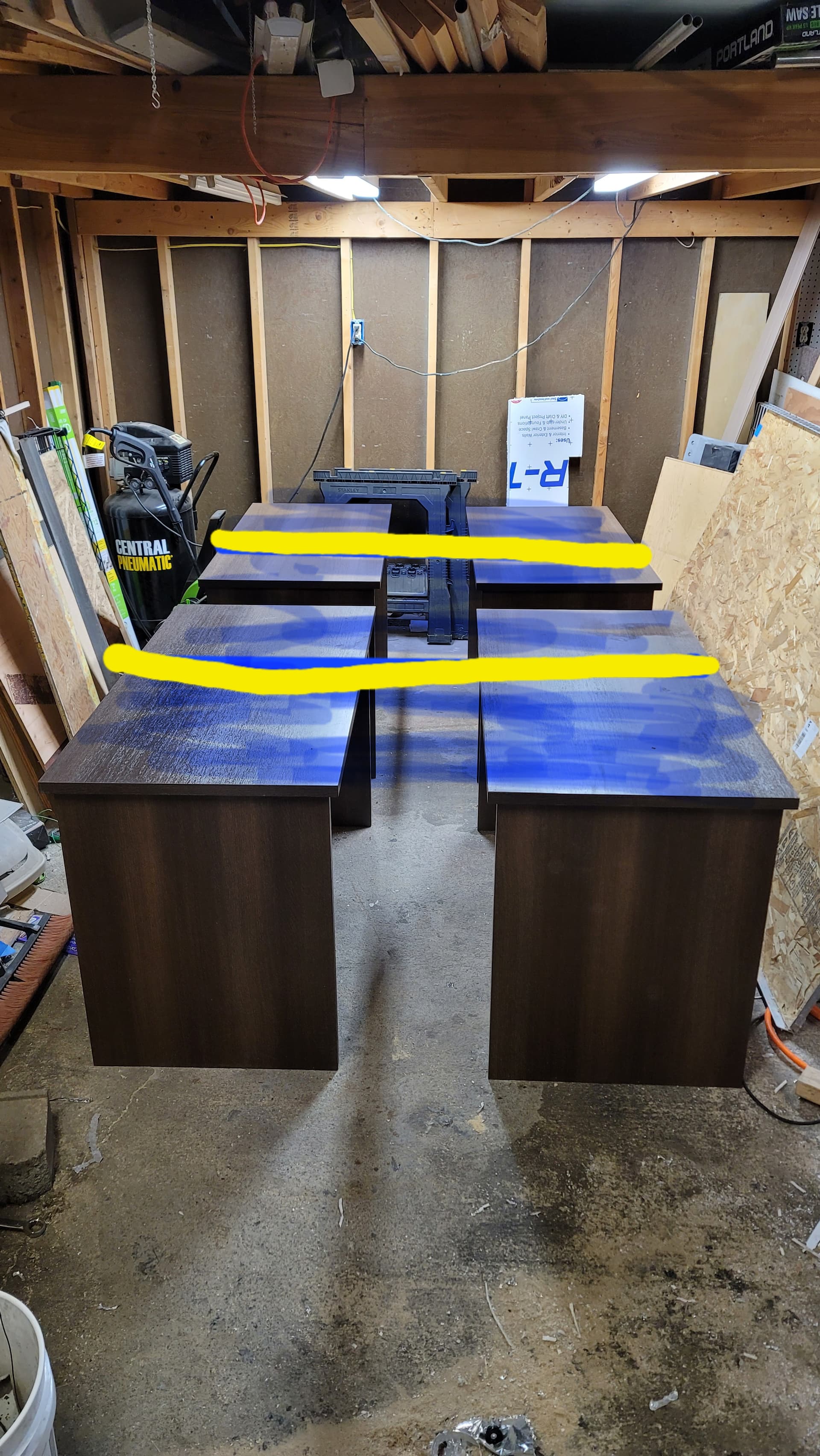

My new LR4 table base. There is a 12" gap in between the desks. How concerned should i be gaps. I plan throwing a sheet of mdf in the middle as the spoiler board.
Or maybe just use 3 sheets of osb as the base on top of the desk all the way across

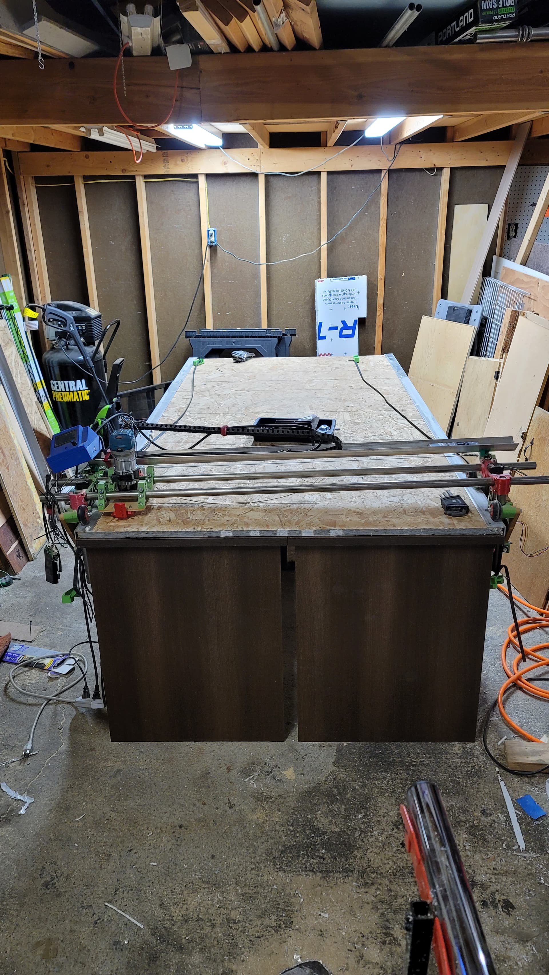

And my temp LR2 table base while im building and printing the LR4
I wouldn’t be at all concerned if it were me - I would expect the sag, if any, across a gap like that would be minimal.
