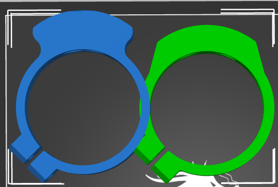

  2. I just remixed the main mount to have a rounded notch in it, for exposing the button more. The fixed base that attaches to it would still be there, but the area closest to the button would be more open. It might help if option #1 is not used. This new part is now included in the Printables listing. See Cura screen shots below showing how I used support blockers to confine supports to only the newly added notch.

Did this get reworked? It looks like it is 8mm longer and not the same shape. The Makita is on the right and the Kobalt is on the left, both from Printables. Was there an interference?
The electronics of the kobalt are a bit larger so without that step away from the core, the Kobalt will hit the bearing on the core when it plunges.
