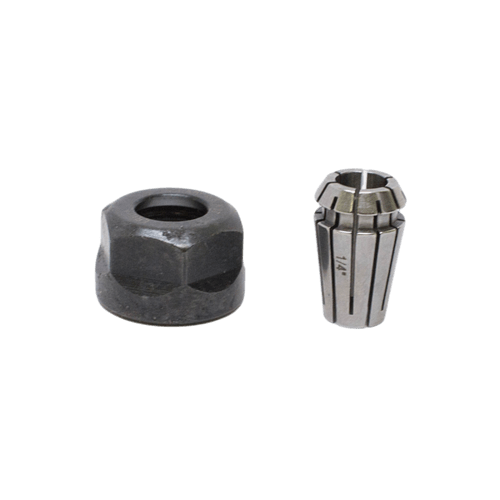

My collet on my Kobalt router needs to be replaced. I bought a set on amazon, but the nut that came with the Kobalt does not seem to fit the collets. Is this standard? Do I need to order a nut also? If so, is a M14 clamping nut the correct one? If anyone has bought one and has a link, I would appreciate it.

One of the selling points on the kobalt was er11 collets. I thought this meant they would be standard. I bought the ones from this link
But they dont come with a nut. It looks like it is m14, but not sure of the threads. I bought a m14 nut that will be here today, hopefully it fits.

I have the Kobalt and a Carbide3d router. The same nut will fit both.
Where I have had issues is some of the collets wont “snap” into some of the nuts. Seems some are designed a little differently. I have found that buying a collet set with nut works better than buying them separately. They seem to fit together well when I do it that way.

I can confirm that this nut fits the Kobalt router:
https://www.amazon.com/dp/B0BRG28PQR?ref=ppx_yo2ov_dt_b_fed_asin_title&th=1
This also fixed my issue with stair-stepping because the bit was slipping. Thanks for all the help. with this.
