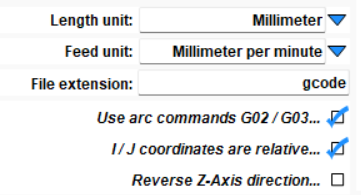

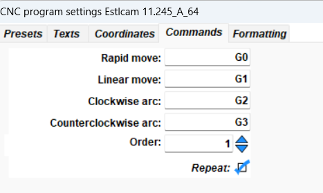

  1. Edit the estlcam postprocessor
  • Open the marlin post processor in estlcam (v11) setup-> CNC programs opens the cnc program preset/ postprocessor.
  • Select Marlin (this us a starting point so pick one. I picked marlin, but you could pick grbl) and change/set the following:
    → select the basic settings at the bottom:
    → Select the commands tab and remove the preceding 0 for each command so it looks like this:
    → save the post processor and load it before you save gcode for klipper.
  • make sure your gcode arcs is set correctly in your klipper printer.cfg as shown above with a resolution small enough to allow circles to appear round and use the klipper preview to verify the arcs don’t go backwards (will look like too many extra circles).
  1. [Edit: Clarifying that this us the second option if you choose not to do #1]: Add macros to klipper by defining each of the G commands in gcode_macro statements so G00 calls G0, G01 calls G1 and passes the arguements correctly. This is part of what I was specifically asking about in this post to make GRBL and Marlin code work natively with Klipper… though I’d also like to be able to send data over a socket connection to do it.
give that first one a go and see if it works. that is what I’m currently using.
