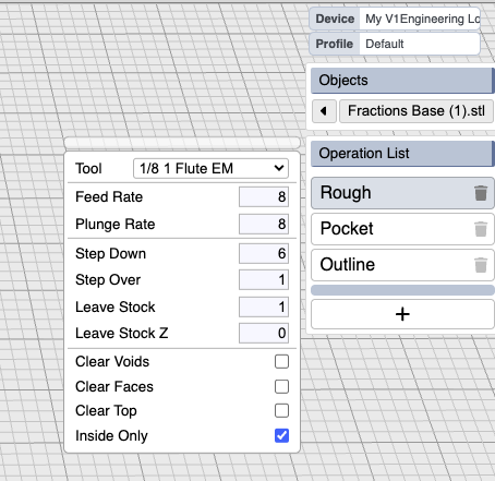

Rather than make a new thread I thought I would ask here. When setting feeds and speeds does anyone know what the default is? mm/min or mm/sec?
Is the Feed and Plunge rate 8mm/sec or 8mm/min?
Maybe I figured out my own answer playing with it. If I leave it at 8 it will take an estimated 41hrs. Im guessing it is 8mm/min. Changing to 480 makes it take 41 min which makes more sense.
