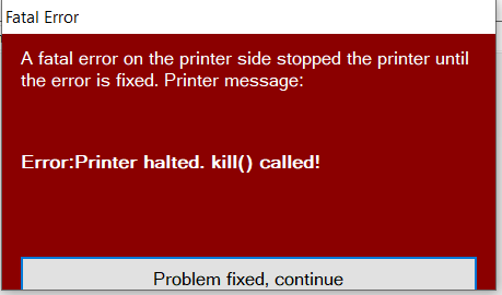

I’m having this same problem. I had the MPCNC running last night off manual controls from repitier but the LCD screen was giving me a solid blue screen but I figured I would fix it later then today when I fixed the screen so it works it gives me the same error message and wont let me manual control from the LCD or repitier and repitier even pops up a error message. Then today as soon as I unplug the LCD its back to running perfect.
The machine is a Rambo 1.4 pre flashed from V1 and there is a J Tech laser hooked up but not in use.

Hello,
I have read through this thread and still having the error of Killed Printer Halted.
  • Successfully drew Crown through Repetier and manually control CNC
  • I have tried all combinations of wire combos including physically switching the ribbons
  • I disconnected the endstops
  • I have ensured the connection was tight on both ends.
The error does not happen right away. the LCD boots fine and on the main screen it will sit there without error. the error only happens when I start to use the control knob on the LCD.
There are completely separate pins on the lcd. One of them is for the reset button on the front. If the knob is wired into that button, either because there’s a short, or because it’s just wired wrong, you’ll see these symptoms. You say you physically switched the ribbons, does that mean replaced them?
For the ribbons I tried the ribbons in both connections in the back of the LCD while, trying the different combinations.
Current Wiring:
EXP1 -> Side Closest to stepper 4 pin connection
EXP2 -> Side Closest to the Fuse
I disconnected EXP2 from the LCD (assuming this is the ribbon that relays the SD card as Ryan mentioned above) and Screen comes on, will allow me to click the button down going into the menu screen but when turning the knob the cursor does not move and i do not get the error anymore.
When plugging EXP2 back in, its boots up allows me to press down the button and go into the menu screen and as soon as I turn the knob to the right (to scroll down the menu) that is when I get the error.
When the error happens and I turn the knob it reboots the LCD and then will give me the error again if I try going into the menu
If I am plugged into Repetier I can manually control the CNC and the coordinates show up on the LCD screen. If i try using the LCD and get the error, I also get the error in Repetier.
EXP1 goes to EXP1. So then there are 4 possible ways to connect it. You can turn each cable 180 to try different combinations. Only one works. Beyond that,you can try to debug it by checking the continuity with a multimeter or you can replace the whole thing and the ribbons. Did you carefully look at the ribbons? You don’t have the controller on something conductive, do you?
I have walked through all combinations of wire including rotating, some the screen doesn’t do anything, some others the screen is delayed and the backlight turns on but no graphics. then the one combination powers up imeediately with the V1 Graphic, but still has the error.
It is sitting directly on MDF (im waiting to get wiring complete before i put in a box), I do not have a multimeter, Ribbons look to be intact.
Is there any firmware issues that could cause this? (I purchased from V1)
If not I will reach out to Ryan to see if he has any thoughts before we try replacing.
Thank you for your help.
Use a usb and see if you still get the error in repetier host. lets see if it is the board or LCD. My CNC firmware should not have that error possible, but the printer firmware can if you do not have the thermistor plugged in.
It’s not an error, its more likely to be what happens when you press the reset switch on the screen.
