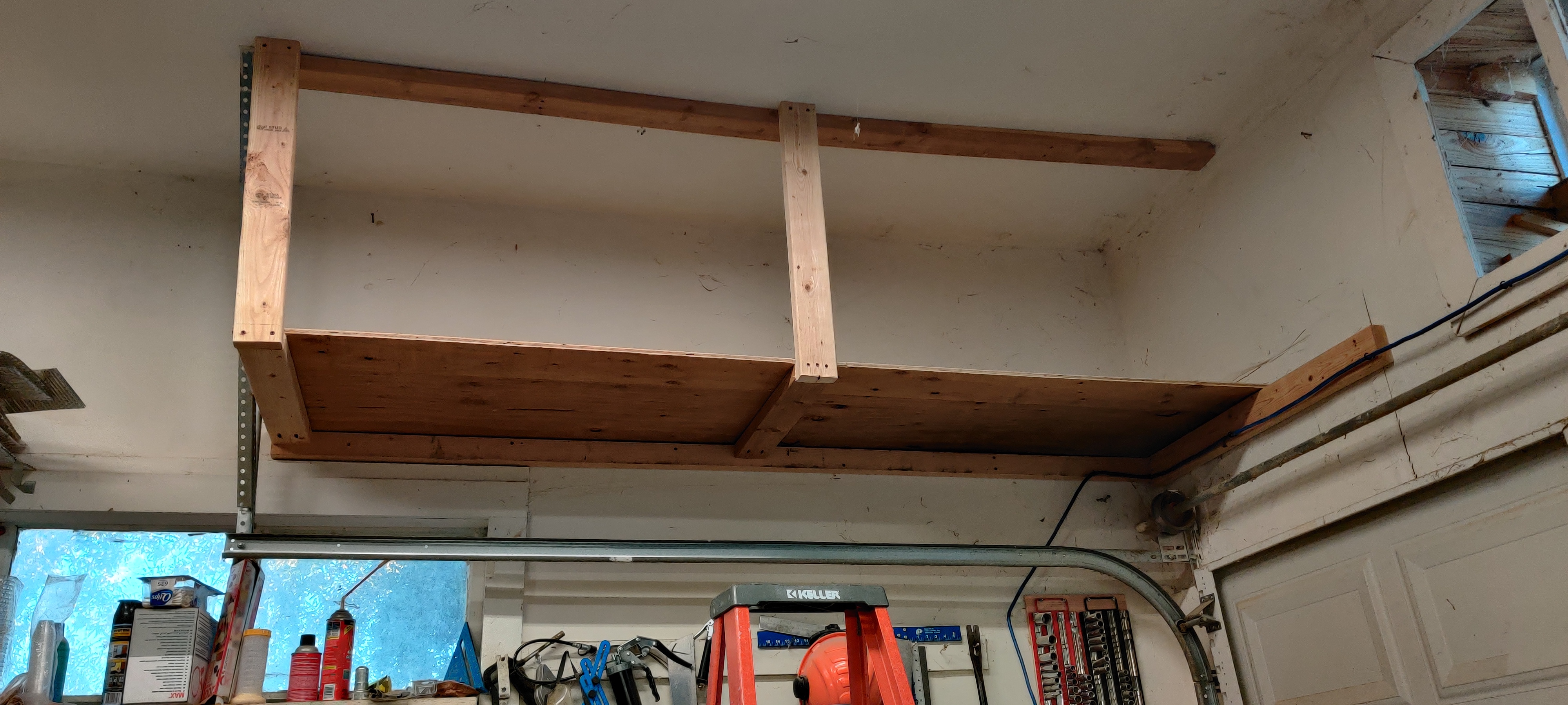

@jeffeb3, I truly appreciate the assist from you and @vicious1 . The day isn’t a total loss. Instead of cutting fun things for my friends and family on the CNC, I built some sorely-needed storage in my garage.

Working in construction and seeing your storage shelving, I have to mention something as I’d hate to see anyone get hurt. The vertical framing members are not adequately fastened to hold substantial weight. The nails will split the end of the stud with very little weight actually. I recommend instead using some thick galvanized wire with proper carriage bolts and perhaps even hardware strapping for the vertical members. The wire will hold hundreds of pounds tension, and carriage bolts with strapping will adequately spread that load to the joists above and your horizontal framing below.
Cheers… off to work,
Kev

@truglodite, thanks for the tips and looking-out for my safety. Those aren’t nails though. They are 3" #10 deck screws. I am able to grab those cross-members and hang my 240 lb body from each of them. That, plus the bracing on the wall should support a minimum 720 lbs. FAR more than the 50-100 lbs that I plan to put up there.

I’d at least add some 2x4s horizontally under the front edges. That plywood will bow over time.
