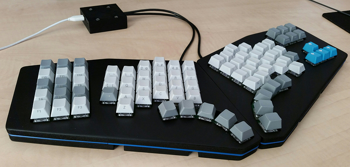

I built my own keyboard completely from scratch, and I used my MPCNC to make a nice enclosure for it. This is the end result:
I designed a custom PCB at easyeda.com and had it fabricated at jlcpcb.com. Soldered all the keys and some components onto it, and used a Teensy 3.2 as the microcontroller. The code for the Teensy is also written from scratch (I didn’t know about QMK at the time).

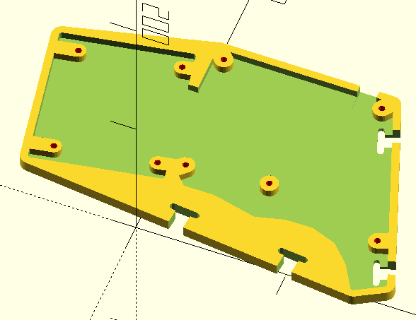

I then designed a case in OpenSCAD, this is the bottom for example:
bottom
The PCBs rests on top of the screw holes. Then there is a top piece that looks fairly similar to the bottom part on top of it. I also 3D printed a blue strip that fits in between, just to make it look nicer. Everything is screwed together with some flathead bolts from the bottom.
I initially planned to make the case from some nice solid wood. I decided to make a test cut in 8mm MDF first, but I then decided to just paint it black and use that as the actual case. I really like how it turned out!

I don’t have any build instructions. I don’t mind sharing the design files if you’d like to have them, but I would definitely make some changes if I would build another keyboard.
At jlcpcb.com you can now order PCBs with SMT assembly for a very low price, so I would definitely redesign it for that. I’d also redesign it to use an AVR processor, because QMK seems to work best on that (and it would be cheaper than a Teensy).
Now that I can mill aluminium (in theory, haven’t tried it yet), I might also try a design with an aluminium backing plate. In this version, the keys are soldered directly onto the PCB. Works fine though, so I might keep it this way.
I’m still in doubt whether I actually need the leftmost and rightmost sets of keys (the function keys and the cursor keys). I can also type those keys by holding one of the thumb keys, which changes the function of the other keys (eg. j is left, i is up, k is down, l is right, etc).
If I like the keyboard enough after typing on it for a while, then I’ll probably build another one for work. So far I like it, but it does take time to get used to. Productivity definitely drops in the beginning. I am finding it much easier to type completely blind though, and to hit the right keys more consistently. I can change the meaning of keys with the thumb keys, so pretty much every key is accessible with moving any finger at most one key away.
