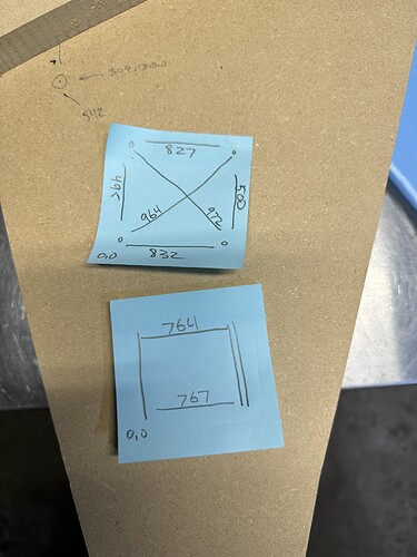

Yes, things seem amiss. Here is a full set of measurements taken from the exact points that the belts enter their corresponding blocks. And it’s definitely out. The stickie with only two measurements are the belt to rail outside edge measurements. 0,0 being the left of the gantry and corner “closest to the router” side of the gantry.
I can not think of a way this can happen.
Are your points at the furthest that can possibly be out? If so move them in about 20mm from each end. If they are already moved in I would check that X pulley grub screw again.
Those aren’t the “pen drawn points” those are the exact spots where the Y belts enter their respective blocks (measured from the inside surface of the belt). Measured like so:
HAHAHA shoot my bad!
The distance between where the belt enters the bock is pretty much irrelevant, as far as I can tell.
The belts need to be as parallel as possible, and a line drawn between the two blocks that the endstops trigger against should be exactly perpendicular to the Y belts at each angle (or as close as you can get them before using the offset to compensate for the minor inaccuracy).
The test is to actually draw out points at each travel limit ((XMin/YMin, XMax/YMin, XMax/YMax & XMin/YMax), and measure those diagonals. I’m not sure from reading your post, but it doesn’t seem that you have done that.
I had, yes and that started this tangent we’re on here currently. I did however forget to lay a carpenter’s square down on the machine. I’ll do that now and report back. I’ve been tied up today so haven’t had a lot of time to tinker but will shortly here. I think I’ll start by ensuring the rail is squared up to the world first - it’s where the most adjustment exists for me (the elongated holes in the clamps they use).
