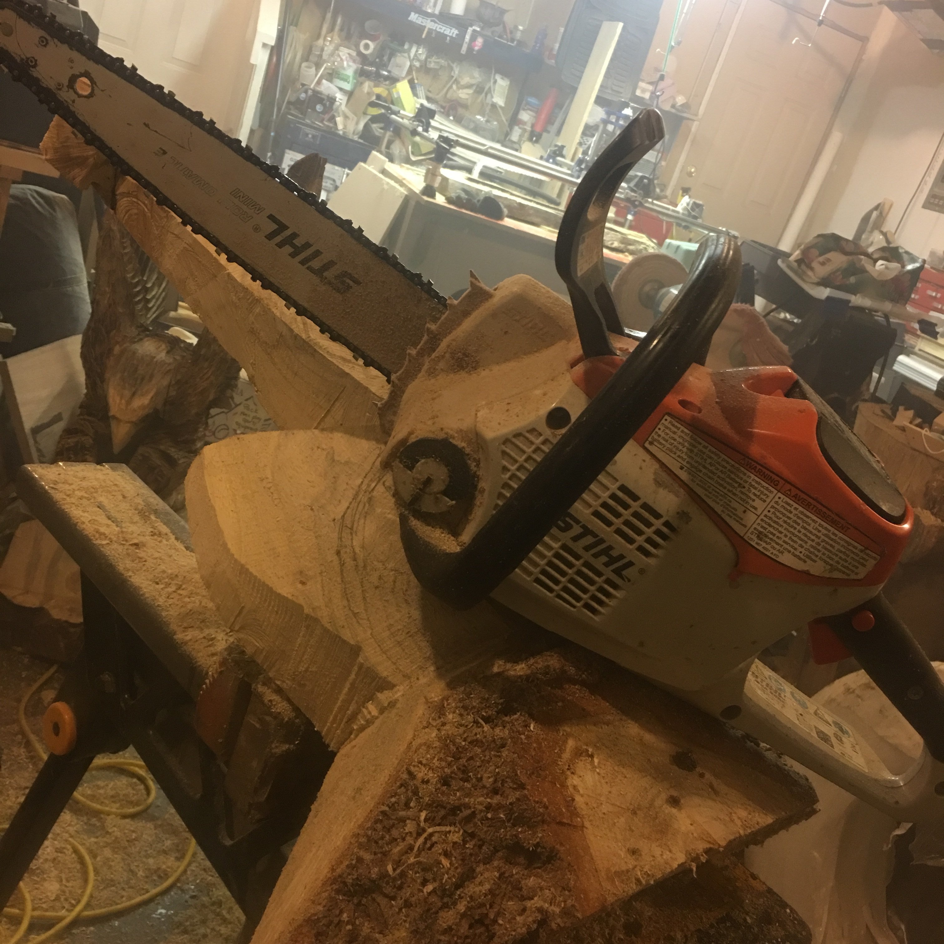

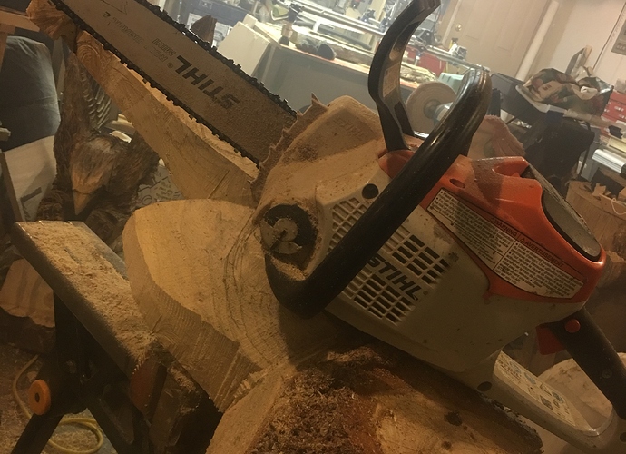

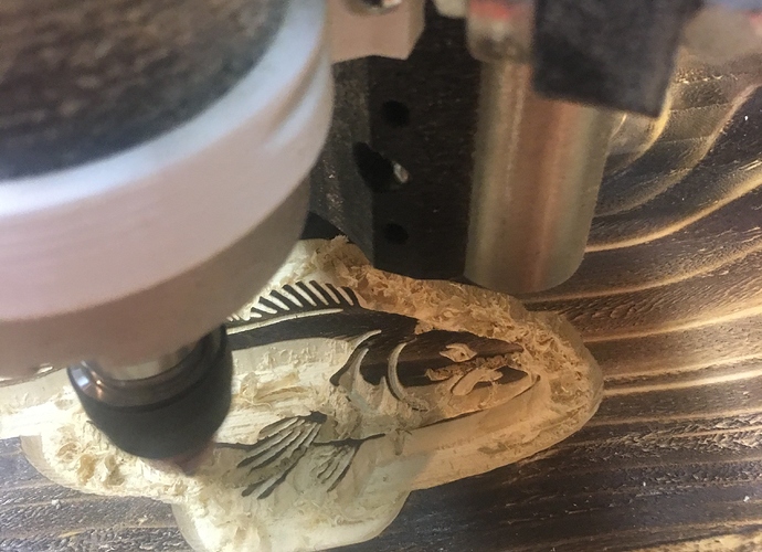

Living the dream tonight. The MPCNC is running (quietly) on the far side of the shop and the chips are flying from the chainsaws on the other side.

That spindle looks familiar…
I’m pretty impressed with it’s performance. Knowing the RPM is so much lower than the Dewalt and the wattage is what - 15% less? I did not adjust my speeds and feeds at all from the Dewalt settings and it’s handling the wood like a champ. Event the knots - and there are two good sized knots - one 2" and one over 3".

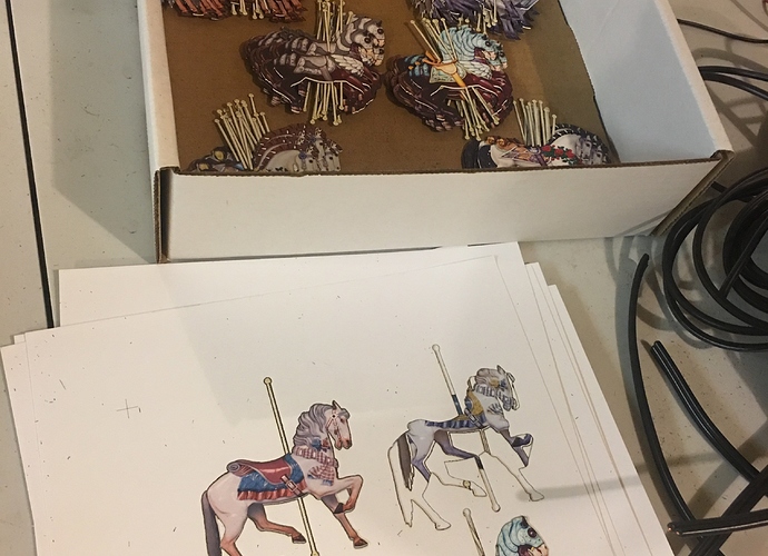

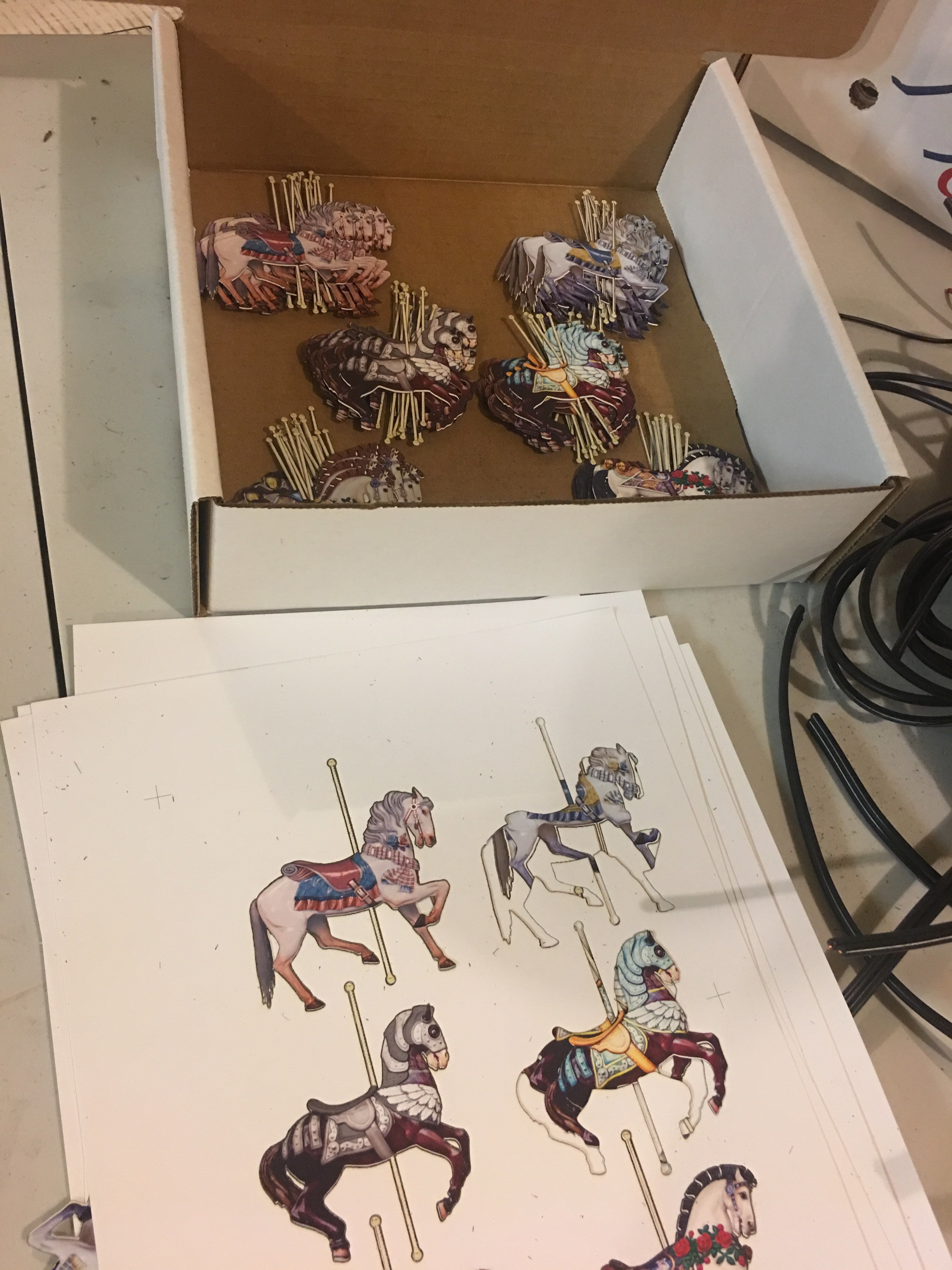

New project underway on the other MPCNC. 480 carousel horses, six at a time. 2 1/2 minutes per horse…
[attachment file=118095]
What tool are you using to cut those out?
This is my 2.8w JTech machine. The paper is gloss coated 80lb cover weight and it takes 2 passes at 8.5mm/s to cut through enough that the char JUST holds them in place when I take the sheet out but a little bend or shake and they for the most part fall out. I find it cuts hotter where there is toner vs the virgin paper surface. Interesting tidbit…
Oh, and it needs air assist otherwise it’d need 3 passes. I’ll have a finished product this weekend to share - I’ll post it. Hopefully it works out as planned. The MPCNC is saving my customer about $600 because I’m able to do this for her. I’m only charging $10hr for the runtime (21 hours) which I know should be higher but it’s such a slow laser I’m ok at that rate for now. I can see myself upgrading at some point but likely only to a 10 or 15w. Can’t recall what the chinese lasers are these days.

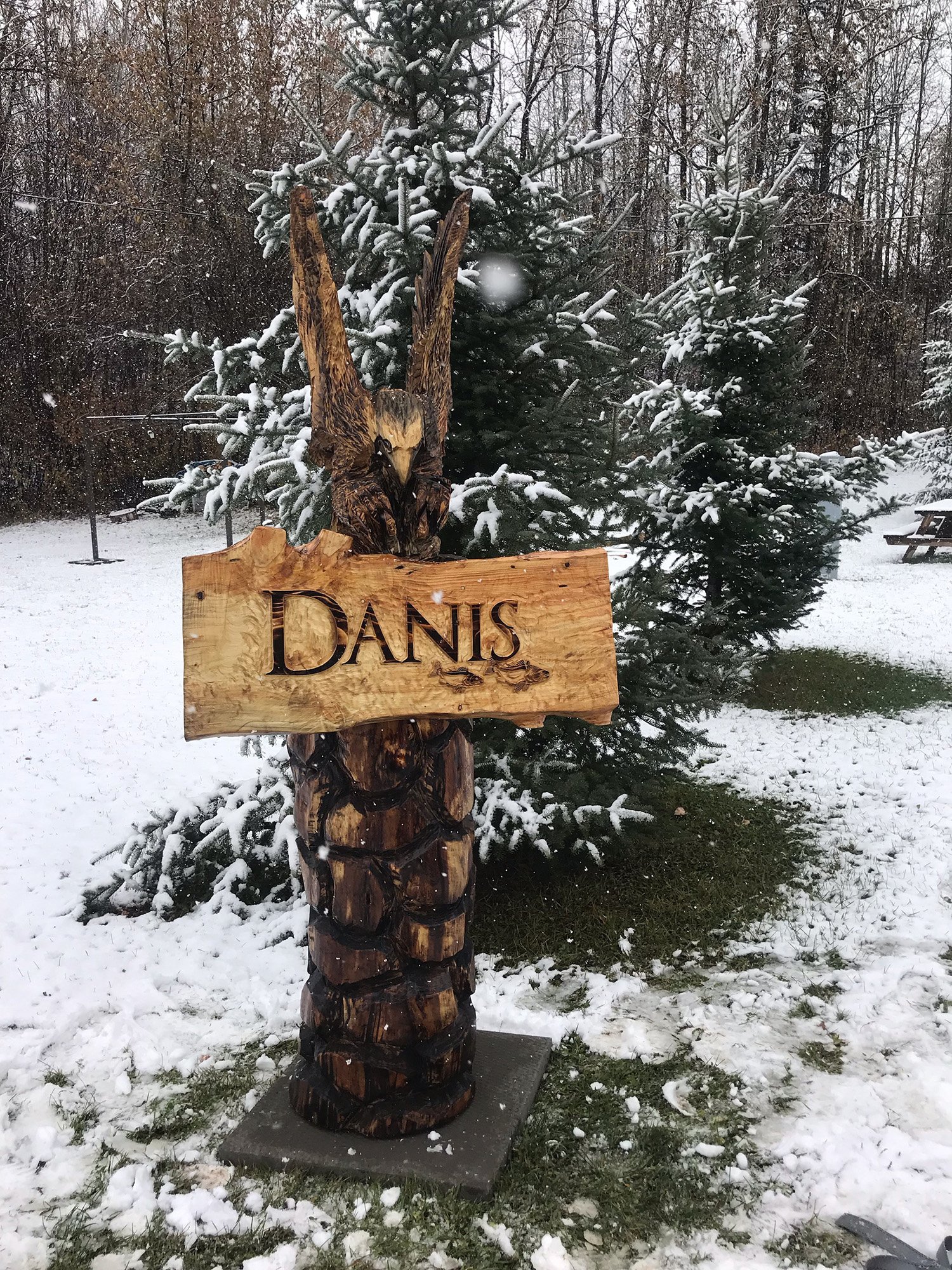

Oh - the “living the dream” post from above there…here’s the finished product…the customer picked it up on the weekend.

Would you believe that eagle carving there was done 100% with battery powered saws?
