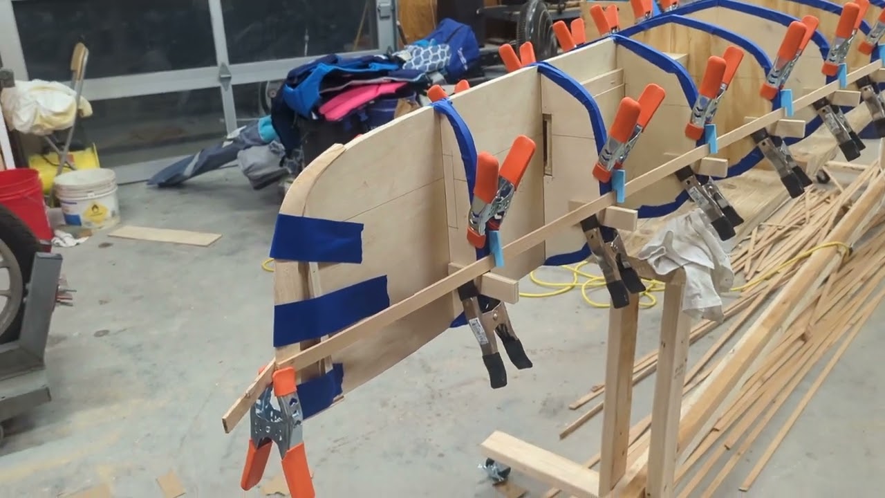

Ugh… Had to order more clamps… Again…
Mahogany doesn’t bend as easily as cedar. The accent strips on the waterline will take more persuasion to keep in place while the glue dries.
“There, that should be enough clamps” - Every woodworker, ever, every project, after buying more clamps.
Boat building will test your clamping prowise more than any other woodworking project.
