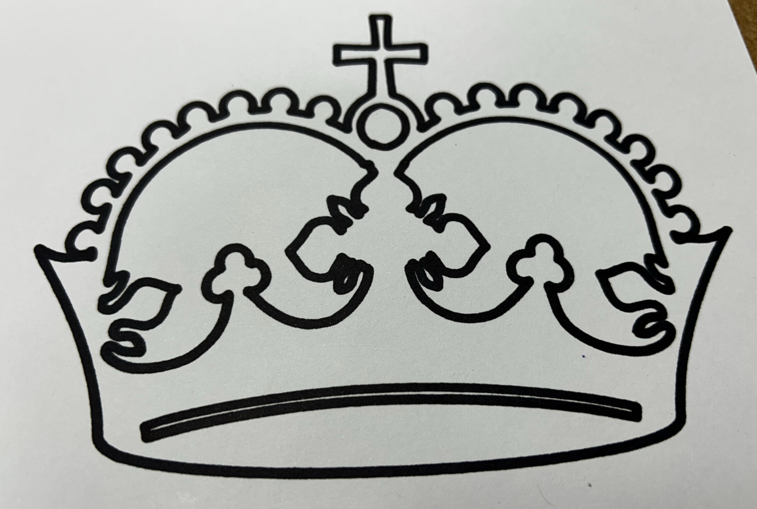

3rd Attempt at drawing a crown. Wasn’t convinced that the Z axis was level as the left side was too high to draw on the paper…or the pen was crushed into the paper.
I re-levelled the Z axis using Jason’s script - GCode Variables and Loops - Software / Firmware / Jackpot Board / FluidNC - V1E.com Forum
And also printed a sharpie pen holder - V1 Lowrider4 CNC Sharpie Pen Holder Rubber Band - Free 3D Print Model - MakerWorld

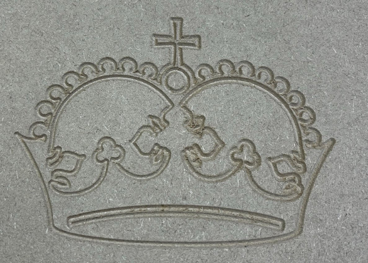

Back to the excellent guide to get to grips with some EstlCAM basics, a V-router bit (haven’t got around to getting any endmills) and a successful carve:
This was actually the second one - the first was with a 3mm straight router bit - it turned out a jagged mess - not sure if the speed was too high (5 or 6 on a Katsu-makita-copy) - also, the second part of the carve above looks better as I paused and dialled back the speed (I recall to 3 or 4)…
