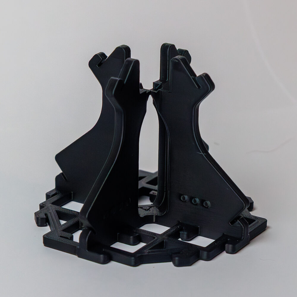

First part printed tonight - Brace_Max:

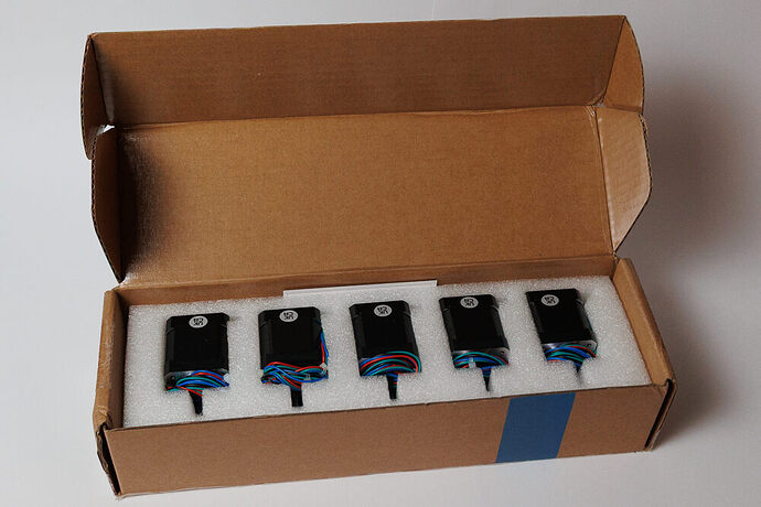

and first parts arrived too…
The excitement might be tempered by waiting for parts to print, to arrive and the free time I have available, but I’m enjoying the process and determine to continue to do so!

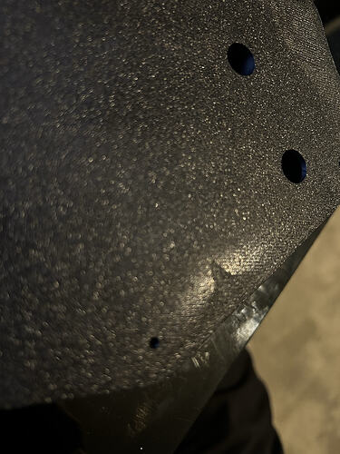

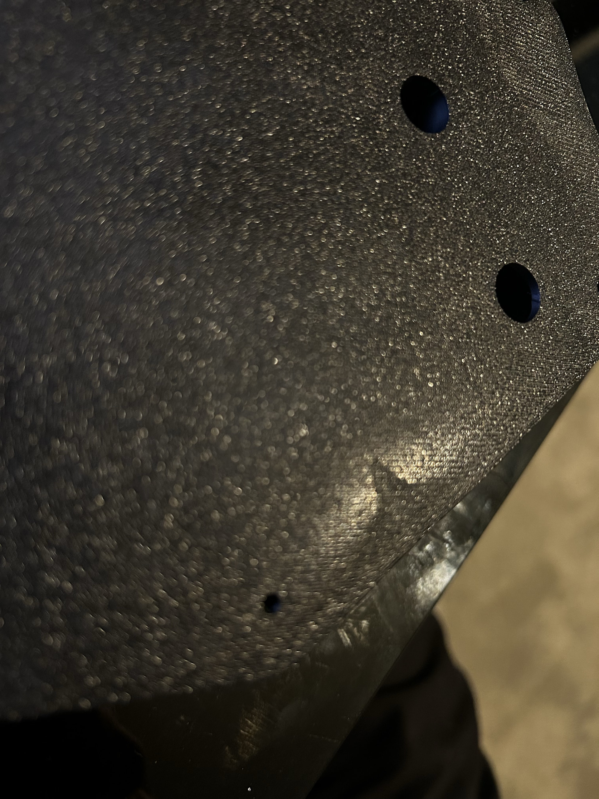

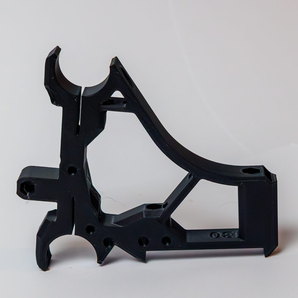

A bit more progress, smaller parts done, onto the YZ plates… and a question.
Not sure how well it can be seen in the photo, but there looks to be a “miss” / “gap” on the outside face of one of the YZ plates. Its present on the top outside edge and edge with the V1 logo.
As far I can see, the plates is all square and everything else looks good - is this something to worry about?
I believe this is because that section of the part became detached from the bed during the print, I’ve seen the same thing on some of my printed parts. Unfortunately I haven’t tried to use one of them, mostly because it’s a risk to waste a lot of time building the machine and then troubleshooting if there is a problem… compared to just printing again with some skirt loops to help it adhere better, I’d rather reprint. Maybe someone else will have better advice, but wanted to try and help where I could :slight_smile:
EDIT: I meant to say “brim” instead of “skirt loops”
Thanks Mike,
What I feared, and didn’t want to hear :expressionless: I’ve just checked for any discrepancies on a glass table and there’s some non flatness in the big pieces - both YZ plates and the Core :cry: . Not sure how to go about checking the smaller components.
I’ll go investigate “skirt loops” and how to ensure parts don’t lift while printing - guess I won’t be assembling it this weekend :expressionless:
I printed all my parts with 5-8mm brim for this exact reason. I get a bit of warping on one corner of my build plate but brim has solved that for every part.
Ah yes sorry, I meant to say “brim” and not “skirt loops”. The brim is attached to the part and helps it be stuck to the plate, while a skirt is detached. I always get them mixed up, despite using Brims and not using skirt loops. Thanks @James_Keillor for clarifying!
Yeah I used to get them confused as well. Never found much use for skirts but brims have been very useful for parts for the LR4 for me.

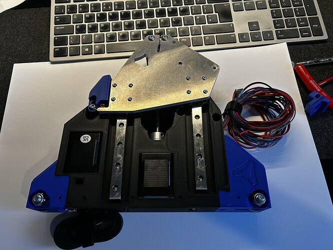

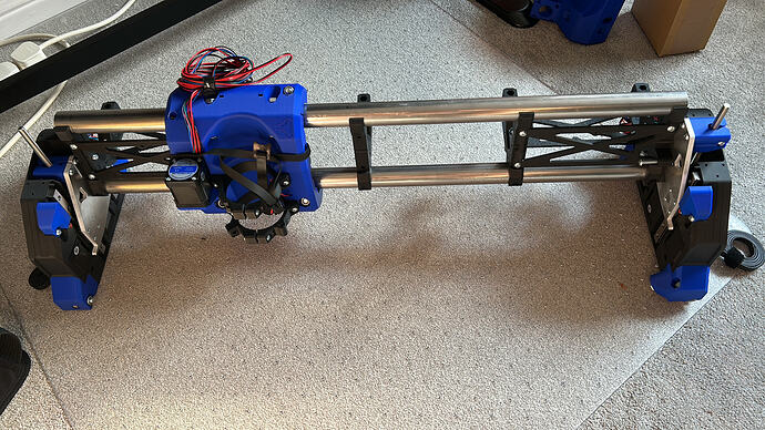

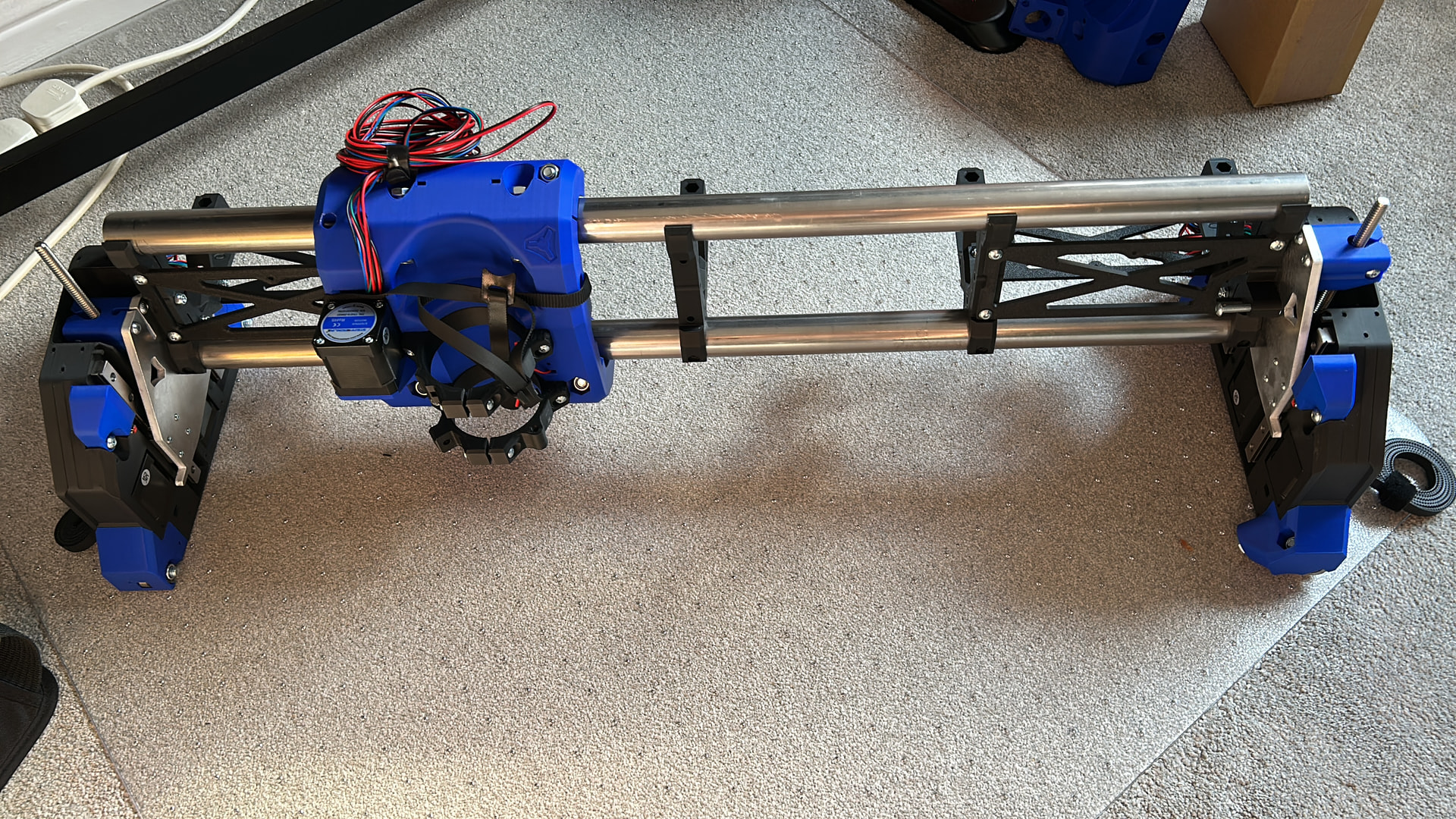

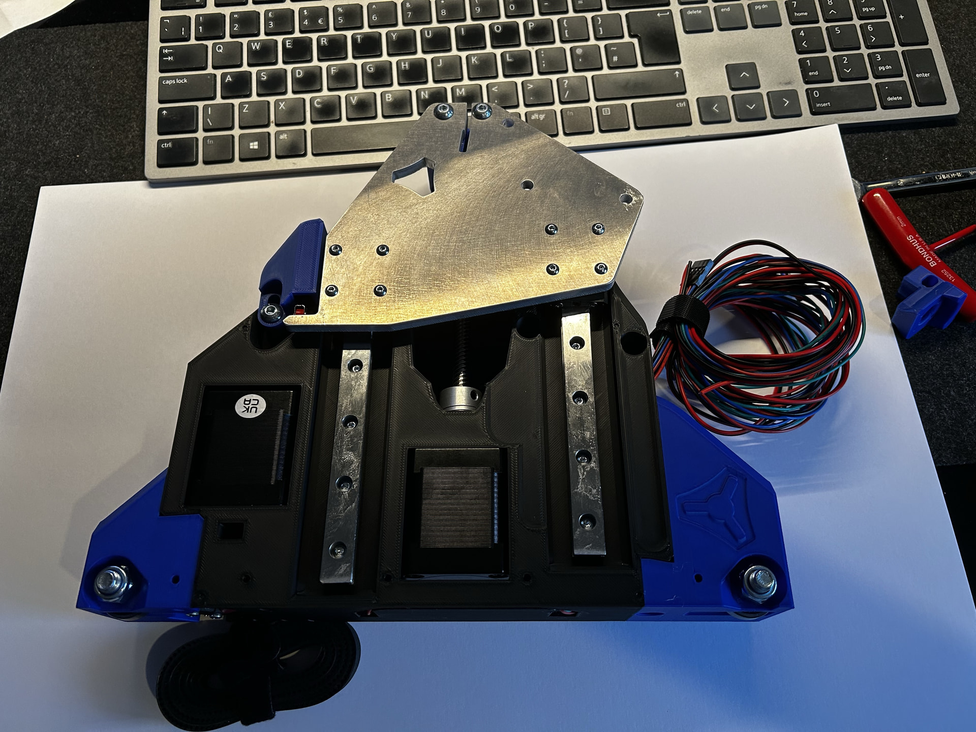

Thanks for the printing tips - learning lots :smiley: Re-printed the failed parts, and as all the bits had arrived got started on Friday putting it together… late Friday (Early Saturday actually)…
And then and with what time I’ve managed to grab over the weekend… I’m at the point of wiring it all up…
I’m well pleased with it - I can’t find the words to express how impressed I am with the components and quality of the design… everything just “fits”, it’s utterly remarkable…

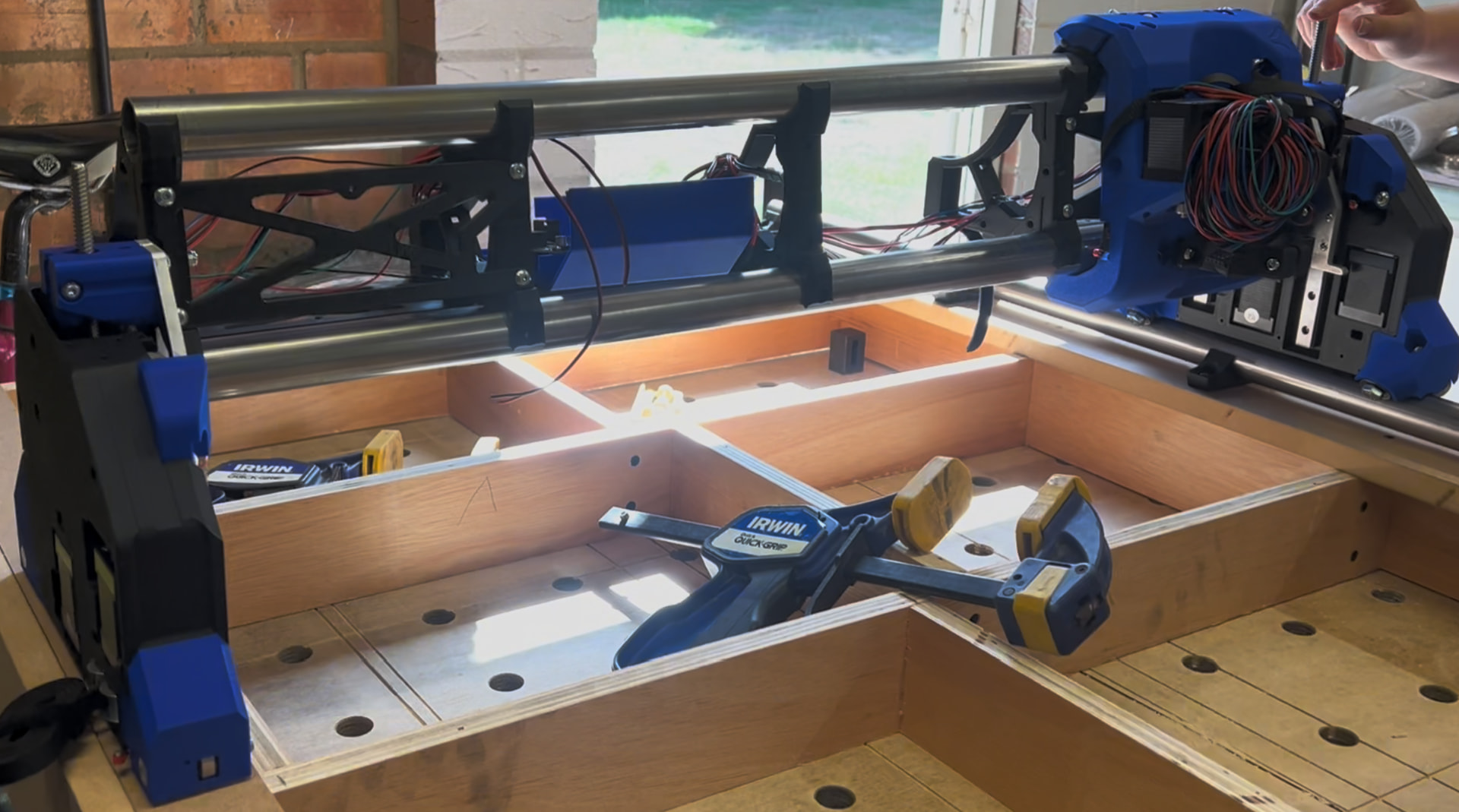

Update - TL;DR it’s up and running :smiley: .
I’ve been limited by available time over the last couple of weeks. I managed to cut and put together a torsion box table last weekend, before heading off to see Bon Jovi in concert :slight_smile:
This weekend, I made a start on the wiring - I’d struggled with getting the limit switch wires into the dupont connectors, tried again with some magnifying lenses (to make sure I could see what I was doing) - despite being very careful, the thickness of the insulation and crimp was just too much to get them into the plastic block.
I’d bought some long twin dupont connectors, so chopped the end off and joined them to the wires I’d used - I’d like to have been able to use a single piece of wire, but couldn’t find any pre-made ones long enough. I got it finished last night, installed the FluidNC firmware, V1E config and everything worked with the exception of the Y limit switches.
Eager to get it working, I completed the table this morning and set about configuring the belts… and then de-bugging the Y limits once the X and Z axis were sorted - turned out to be one of those joints being not actually a joint, once that was re-made, all good.
I’ve then spent the best part of the afternoon learning more about FluidNC, in no particular order - jogging, directions!, probing, calibration. I seemed to go around in circles with many of these steps - first measured the actual vs instructed, re-checked and ended up backing it out… got to within 1mm over 1215mm.
Squaring was more troublesome - went round and round a number of times - I think I got the initial adjustment wrong (I reduced one of the pulloffs instead of increasing the other, which took it below 4mm), once sorted it was down to 1357mm vs 1356mm across the diagonals.
It was about here I read up on creating macro’s in FluidNC, not exactly intuitive, or maybe it was the upload of the file then add as a macro, or may be getting to grips with gcode at the same time.
Once I’d done that for the four corners, I used the example in the docs for the z levelling, again, think I went in the wrong direction first, but got it level to within 0.125mm I recall.

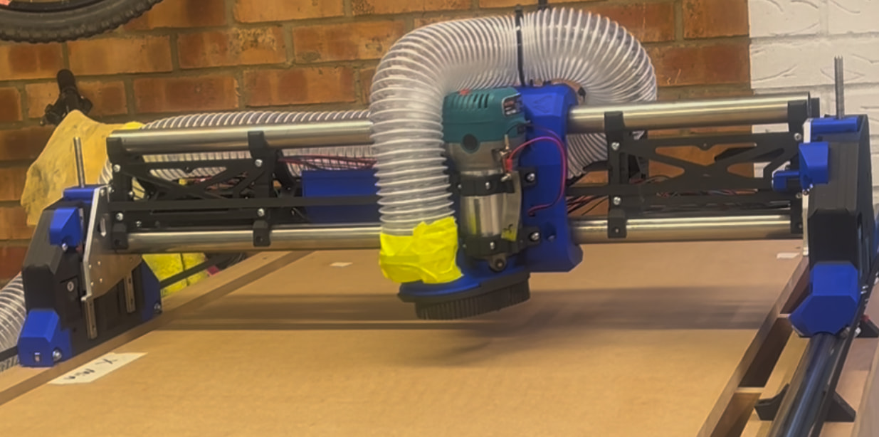

There was just time to shoot a quick video of it moving full range through each axes :smiley: :smiley:
Though I haven’t uploaded the video, so here’s a photo - bit of a shame the hose doesn’t fit the dust shoe - one for another day.

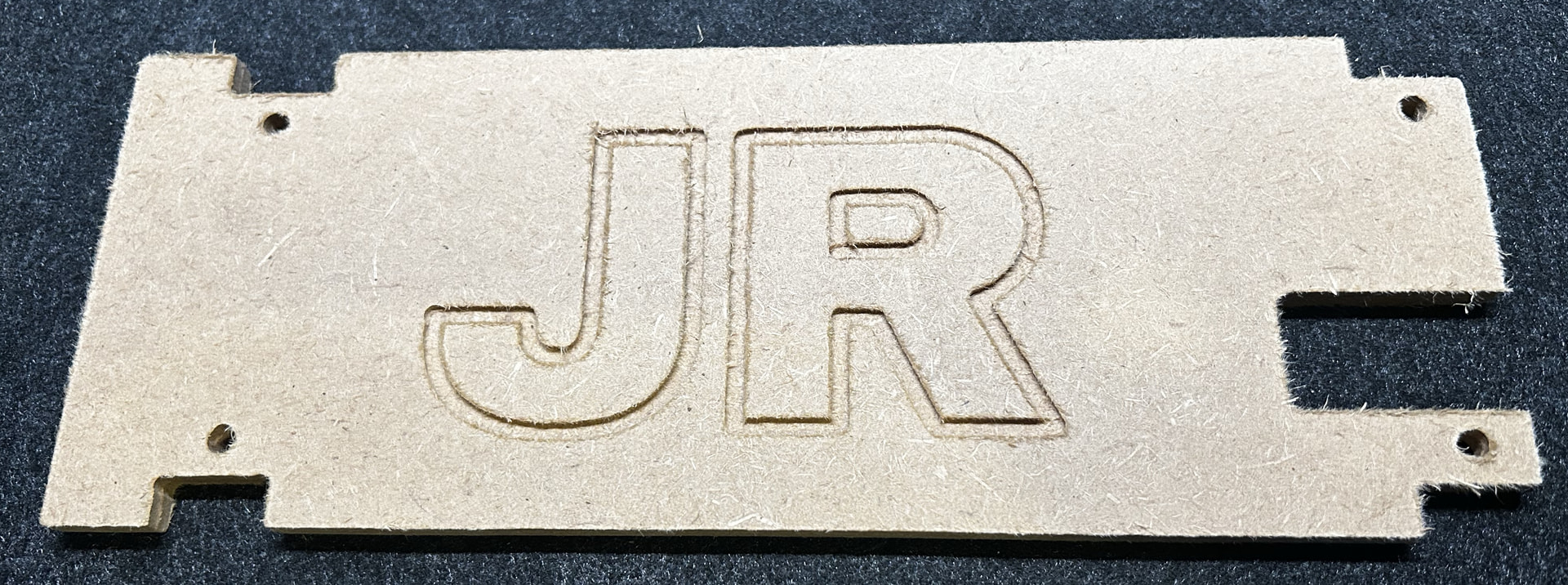

Back to the excellent guide to get to grips with some EstlCAM basics, a V-router bit (haven’t got around to getting any endmills) and a successful carve:
This was actually the second one - the first was with a 3mm straight router bit - it turned out a jagged mess - not sure if the speed was too high (5 or 6 on a Katsu-makita-copy) - also, the second part of the carve above looks better as I paused and dialled back the speed (I recall to 3 or 4)…
