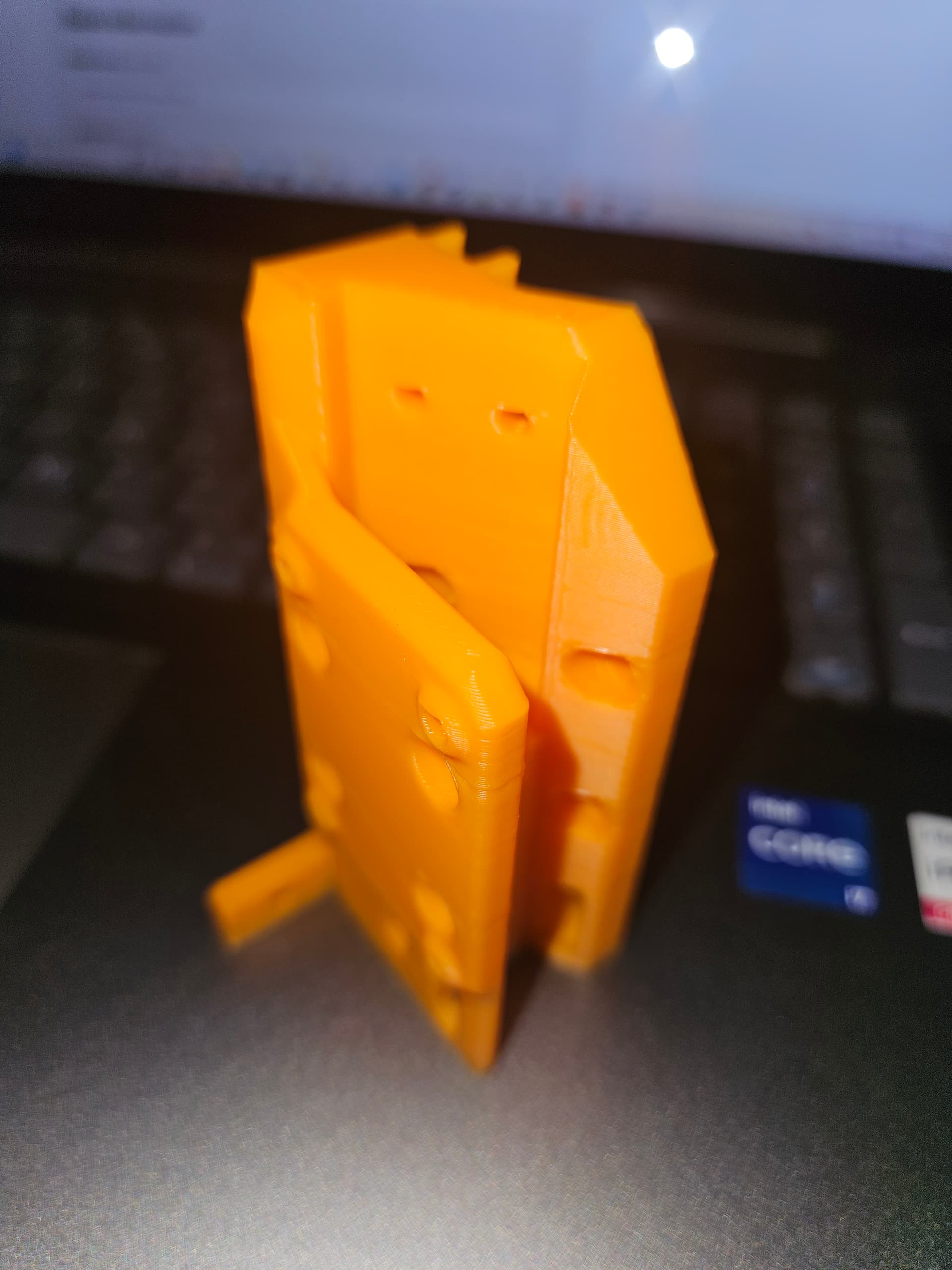

So I was looking at all my printed plastic bits, and realizing that I have a different tool board.
I will be using a Duet 1LC tool board, which operates over CANBUS and has an accelerometer and can handle thermistor/PT1000 sensors, a heater circuit, a couple of fans, and a BLTouch, basically 4 wires to the print head for everything necessary. Cool.
But it doesn’t fit on the core.
The plain Hemera head might sort of work, but it’s not a great solution. The accelerometer one doesn’t match the hole pattern.
Well, the 1LC is supposed to mount pretty much directly onto the Hemera, but
  1. The fan/BLTouch use the front mounts, and
  2. The board I have is the new revision, which has a smaller mount. I guess the Hemera has a new smaller version, with mounts at 23mm × 35mm spacing instead of the 35mm square.
So…
A remix it is.
The CAD that I downloaded only has the H2 hot end parts, not the Hemera parts at all, and those aren’t with the accelerometer, so I downloaded the Hemera parts, but that means importing them into Fusion as meshes, which is a bit ugly… but workable.
I thought the accelerometer version would be easier to start with, but it really isn’t. I gave up on that one and started over.
I did use pretty much the same idea as the accelerometer board, just made it fit the 23mm × 35mm mounting footprint for the board that I have. Posted up the remix on Printables as a remix of the V5.

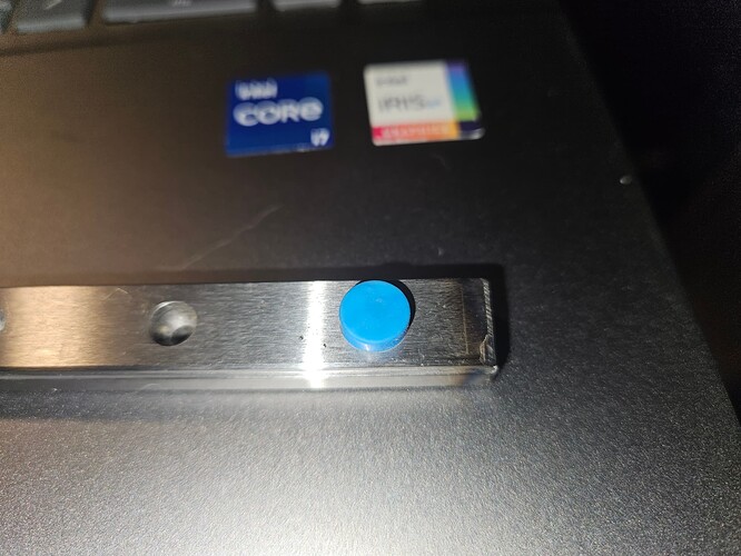

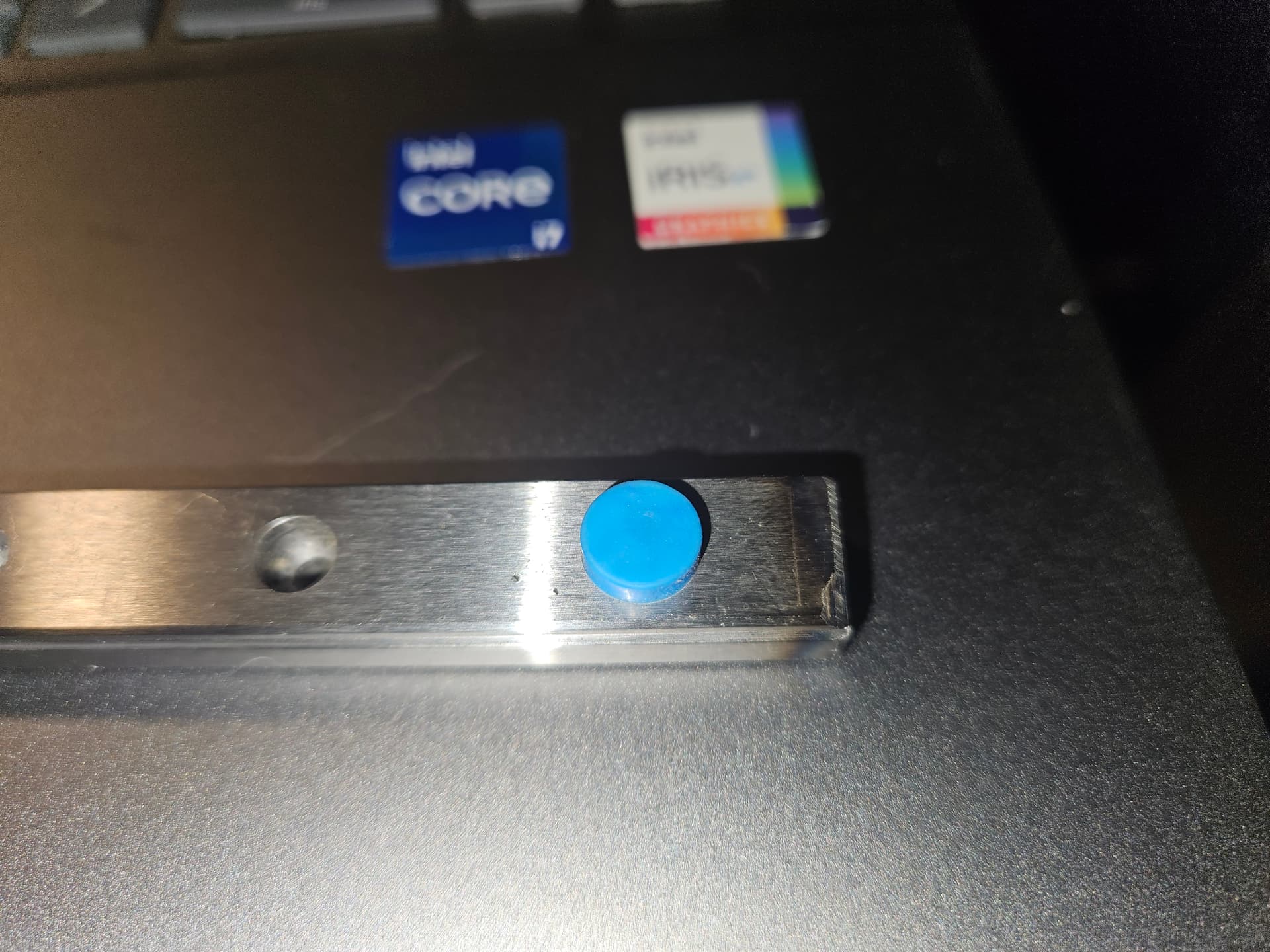

well, for a first, I actually cut the 375mm MGN12H rail today, too. I’ve never actually cut one before, I always just rounded upwards in order to use the next easily available size, but since the aluminum plate parts are specific to the size, this time, I cut.
The abrasive saw duscoloured the rail for a few mm, but it seems smooth. I ground off the sharp edges, too.
Not quite building “as designed” since Ill be using longer Z rails, looking for 300mm cubed build volume.

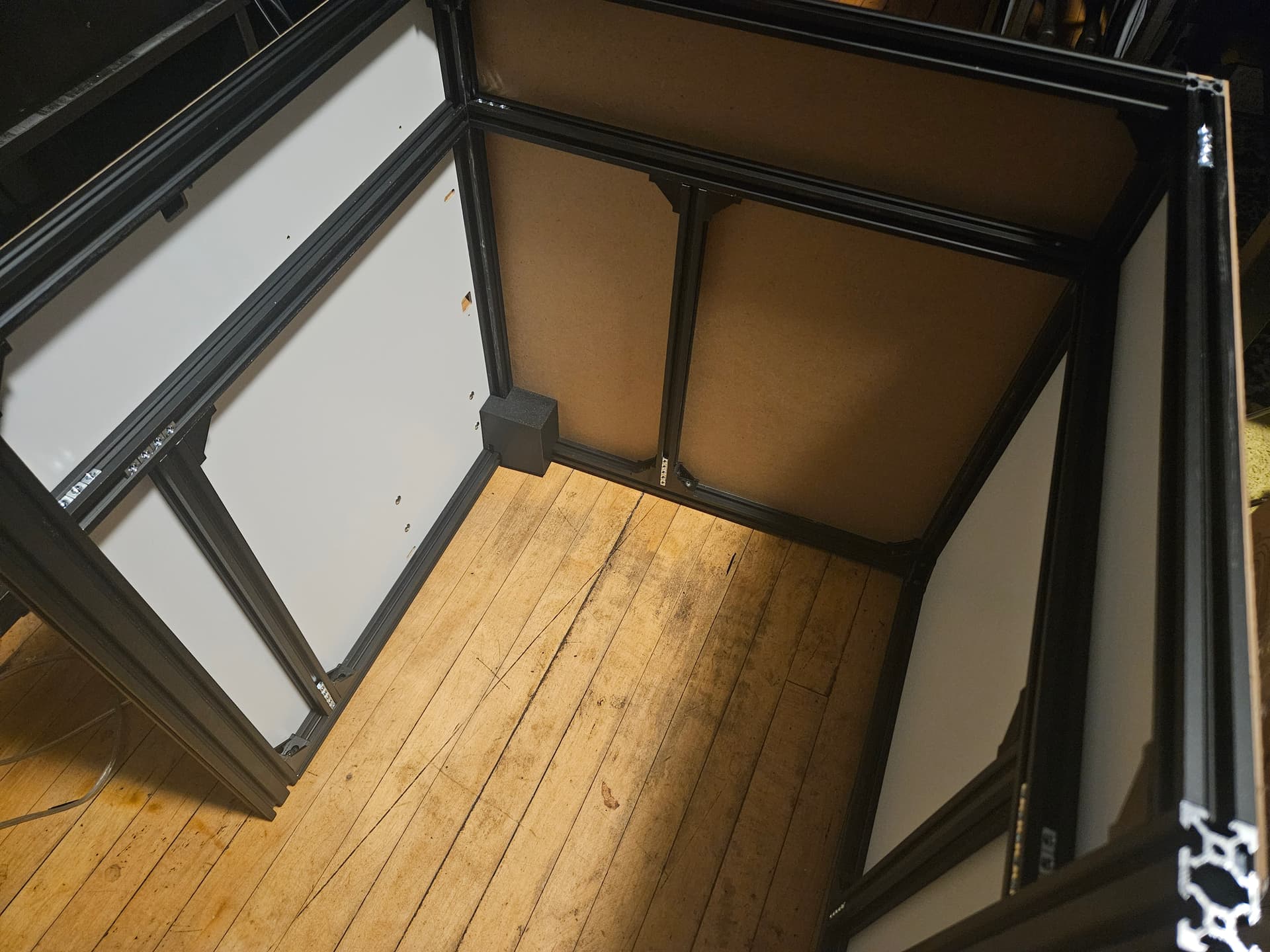

Well, I cut back and side panels, forgot that I cut 2040nextrusion for the front uprights, so yherd will be some exposed onvtye front outer corners. Oh well.
Gif the back and left side together. Forgot one captive nut (that I figured outcalready) for the bottom nut tensioner. Oops. Well I bave some nuts I can put in after.
Progress at long last!
… is big.
I figure it’s a good thing that I have some M3 size nuts that I can fit in after the fact. I keep finding places I should have put in nuts, but did not.

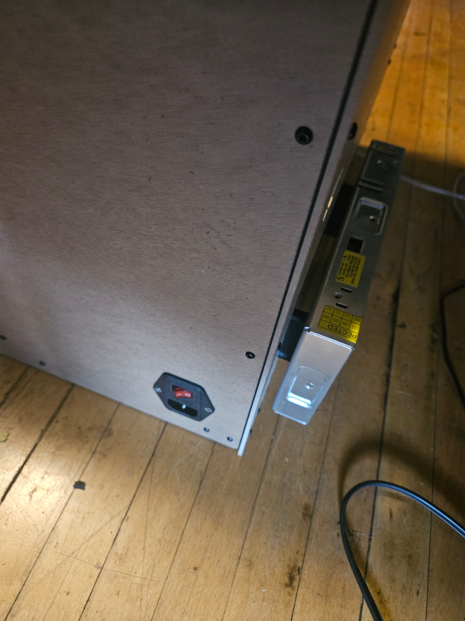

The little black box in the corner hides a power entry/switch thingy. Looks like it will do the job well.

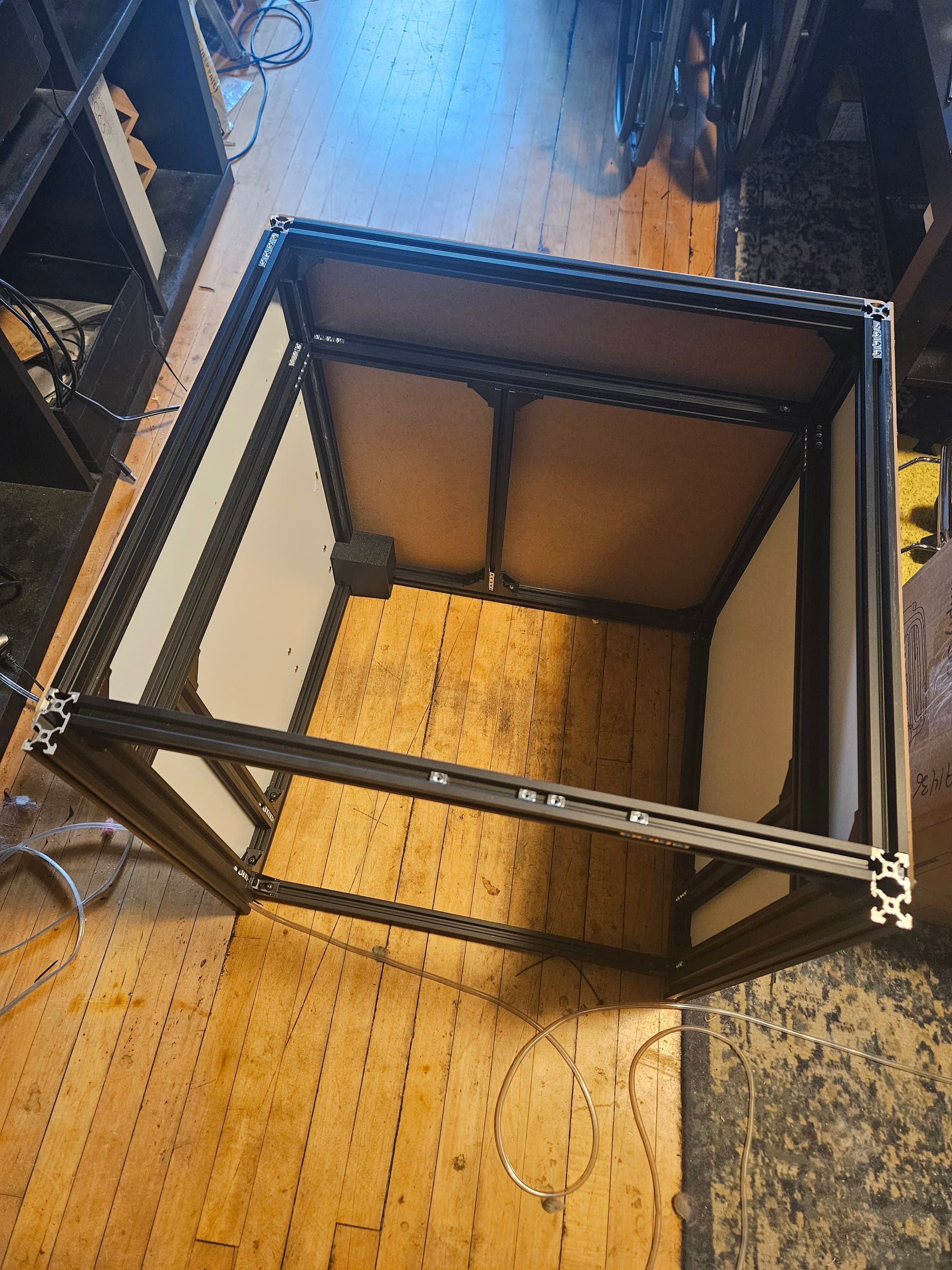

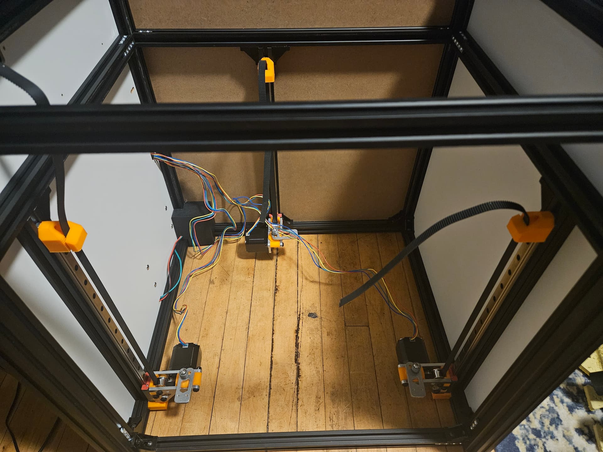

So I still need to put bottom and top panels on, but the frame is complete.
I will need to modify the front because of the 2040 extrusion, but I think I have a good idea there.
The 24V PSU will sit external, so it can stay cool, even if inside the printer it is hot.
I’m dithering on cutting all.of the wires to the Hemera short to use the Duet 1LC toolboard. I tealizr thst this is one if the key problems with my messy wiring jobs. I never like to cut any wires shorter, even if it really is the best solution., so there is always extra wire getting bundled up in tangled knots. I’m afraid of cutting the wire just a little too short, I guess? Or not leaving enough wire if I want to change something.
Well, that will be one of the last steps. Next will be installing the kinematics and linear rails.
The only time I hesitate to cut a wise is if it has a plug. Otherwise, it is much easier just to snip it.
Well, that’s the Z axis belts, linears and motors. Lots of interruptions today, so work went slow, but progress was made.
