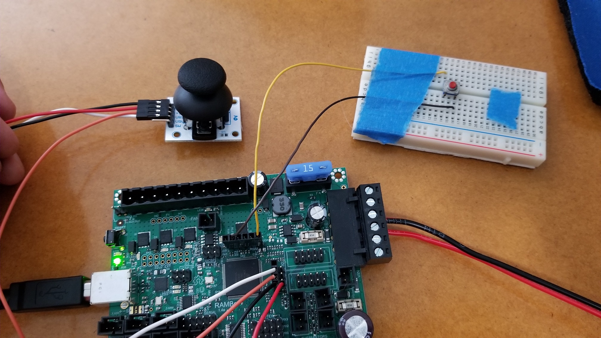

Wondering if something like this can be directly connected to the Rambo 1.4 board.
If so… can someone point me in the right direction?
@larachan I think I’ve managed to reproduce what @tailslide had done with the wiring on the Rambo.
The analog header is on the right side of the CPU near the LCD headers and the pinout he used was like this:
This matches what Greg had shown here:
I have a couple of these cheap joysticks and wired up X and Y (no Z) like this:
Red is +5
Black is GND
Orange is X
White is Y
I used the same pinouts that Greg had listed:
Be sure you add
#define JOYSTICK_DEBUG

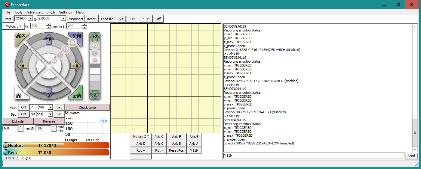

because this is required to show the ADC values in M119.
And by moving the joystick and pressing M119 I can see the values for X and Y changing.
I also wired up a button to the enable pin
The brown wire is another GND pin and the yellow is the enable line. When the button is open the enable pin is at +5 with an internal pullup, and pressing the button shorts to GND, pulling the pin low to signal enable.
Here it is in Pronterface
The method I had in mind would include calibrating the values for a particular joystick, since joysticks even of the same model are not likely to have precisely the same voltages or ADC readings. Once you can see the M119 values changing in response to moving the joystick, it means that it is physically working and reading the voltages. The limits values in Configuration_adv.h represent the maximum and minimum values that are expected from the joystick, so that it is properly scaled and it will go full speed when the joystick is pressed all the way. These values also define a dead zone in the middle of the range so when the joystick is released it won’t move at all. Without a dead zone it would slowly creep in one direction or the other when the joystick is released.
