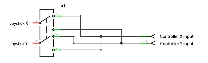

Joystick.cpp and Joystick.h are already included in the marlin firmware in Marlin/src/feature, so you just need to modify the code in these files. Nothing to include. Note that you could accomplish an axis swap by using a DPDT switch to swap the signal lines from the physical joystick.
Interesting! But how do I switch the signal lines on the DPDT switch?
The switch is just swapping the X and Y inputs. I’m assuming those two are the ones you wanted to swap, but it would work for X,Z or Y,Z as well.
Aha! You mean adding another switch? :slight_smile:

Hey guys,
I wanted to add a Joystick to my MPCNC and now I am stuck and do know how to do it… Could somebody help me debugging?
I first wired the stick like Roger did above:
I assumed that for the Z axis red was power, black ground and white signal… When turning the stick the display would go dark and the ramps would reboot.
So now I have white being ground, red being power and black being signal…
D44 for me is EN, which does work without problem…
The rest is wired as in the picture…
The strange thing now is that movement is really slow and that pushing the stick into one direction can lead the MPCNC not only move that axis but all three, sometimes also into a different direction. All is done very slowly… Sometimes there is movement without moving the stick…
Now I absolutely have no idea how to find the mistake. I traced signal to the pins back and forth and they also seem to be wired correctly…
What else could I do?
Regards,
Chris
when turning the stick the display would go dark and the ramps would reboot.
This is a strong indication that when you were turning the stick, you shorted power to ground. This can result in a burned out pin and/or a burned out voltage regulator.
So first I suggest you use a multimeter and check the resistance on both sides of each pot both in the deadstick position as well as when when the stick is moved. Also, if you are using it, check the enable button.
Next I’d plug signal line for the axis that shorted into a different analog pin if you have one available…and perhaps pick new analog pins for all three axes. The pins for the joystick are assigned in Configuration_Adv.h.
This sounds like the joystick code is reading different pins than the ones you have the joystick signal lines attached to. If you do an analog read of pins that are not being pulled high or low, they float giving various values around 512 which would give the behavior you are seeing.
I think your best next step is to define JOYSTICK_DEBUG somewhere in Configuration.h or Configuration_adv.h, by adding this line:
#define JOYSTICK_DEBUG
Then M119 will display not only the endstop state but also the analog values being read for X, Y, and Z (and enable). This display works even when the joystick is not enabled (via EN), so you can leave it disabled via EN and see what range of values you are getting. If it is inconsistent then perhaps there is a wiring problem somewhere.
And yes the joystick red and black for the Z axis are NOT positive and negative. Red and white on the Z axis are for the positive and negative (or vice versa) and black is for the signal.
